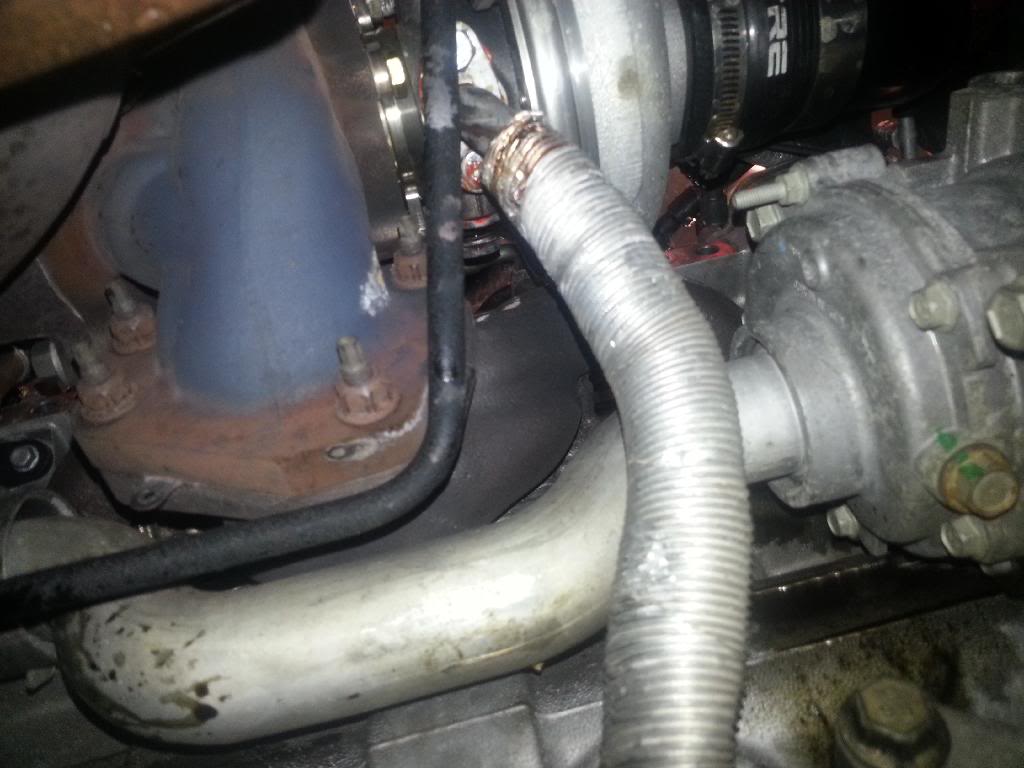

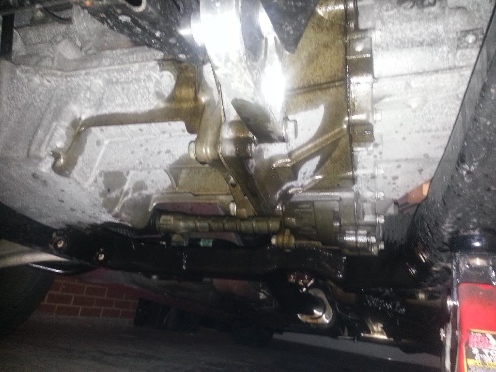

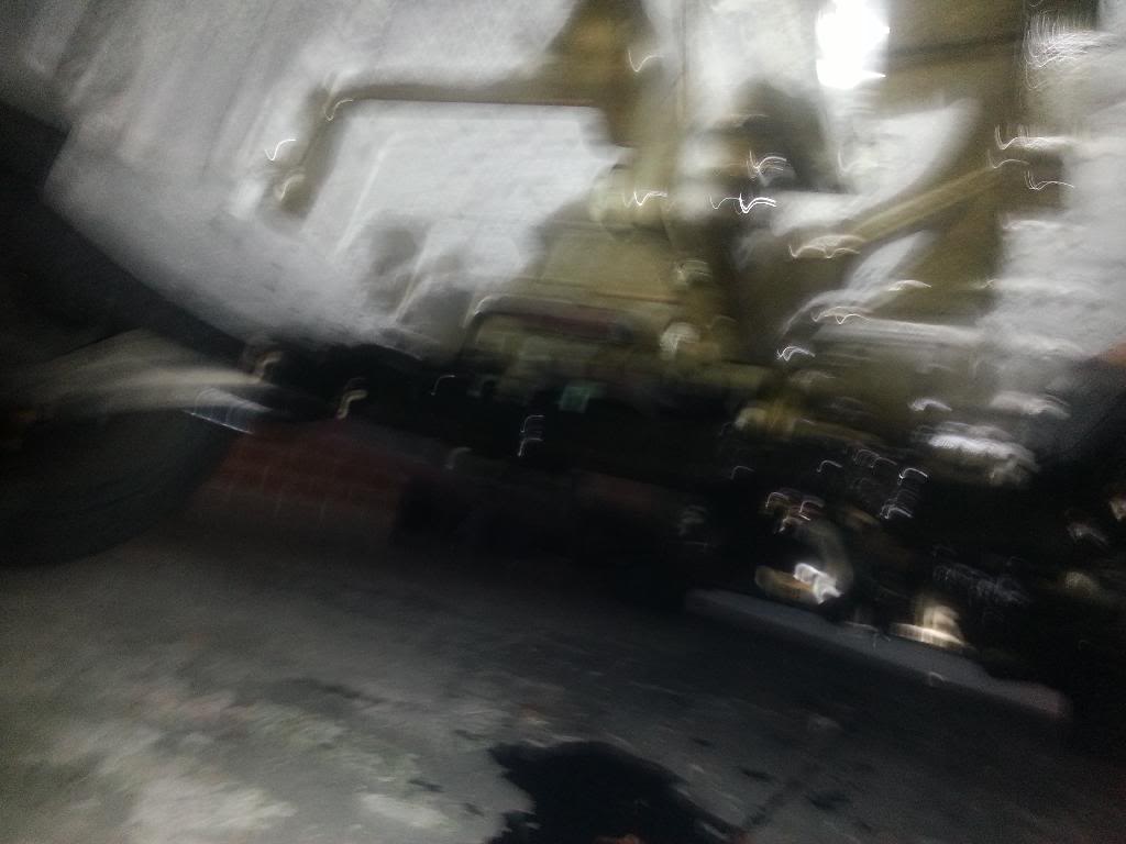

Im coming home from meeting up my buddies and do a half throttle type pull all the way to about 95 let of... and SMOKE comes pouring out my exhaust, next thing my interceptor is reading 155 misfires and she sounds like crap... Im about a mile from so i get it home and i pop the hood everything looks fine, a little smokey. I look under the car.. Oil everywhere... But mostly towards the back.. I got under the car and looked fearing a cracked the block...but no hole...im going to do a leakdown and compression test tonight.

i see red trans fluid in that last pic

Piston 1...zero compression looks like the piston rings failed...looking at the fmrs ldk block.. We think the oil came through the rear main seal it focused around the transmission
