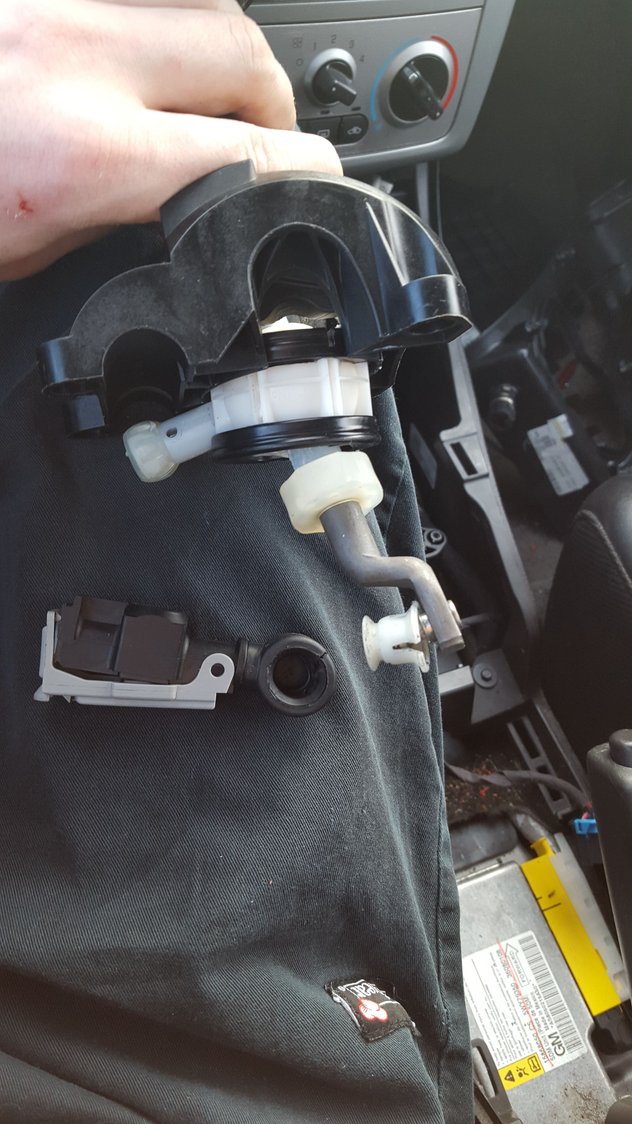

So on the way to work i slowly try to shift into 5th gear and the car gave me a big middle finger and i cant put the car in any gear the shifter is just dangling so i take it apart and those two peices that connect the black cup is not connected to the white ball joint, so itried to do a ghetto fix with tape and zipties and then the black cup completely ripped apart so im trying to find online where i can buy that peice or if there is upgraded one that is not made of plastic and rubber

Buy a new shifter from OTTP or BPS.
Order new base bushing and cable clamp.
Hell you already know how to put in a new one because you have the old one apart.
Replacing the stock shifter was much easier than I thought.
