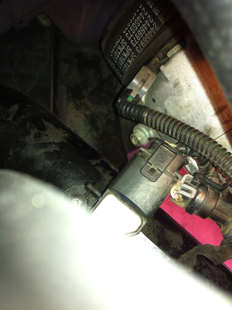

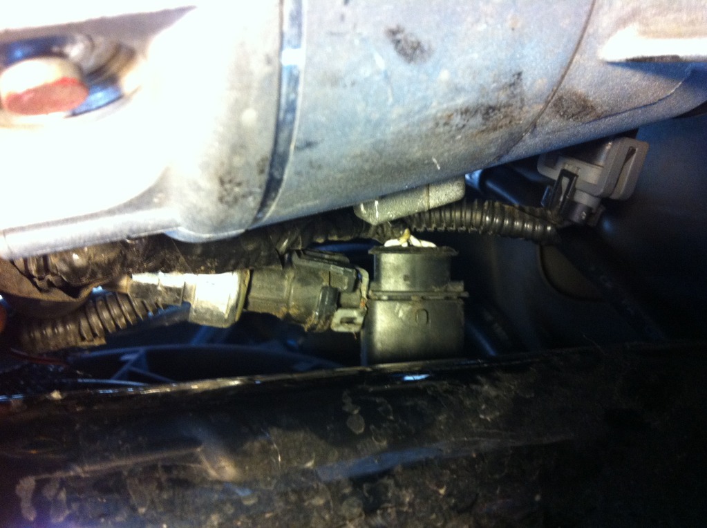

I have the GMS1-specific Hahn lower CP, and I believe that since I installed Powell's rotated mounts, the lower MAP sensor connector interferes with the AC connector. The latter rubbed all the way through and I can't seem to find a position for the lower CP where the two connections don't interfere with one another... Here's a picture of what I'm dealing with. I tried re-positioning the lower CP on both ends, but the "play" doesn't seem to be enough for the connectors to clear each other. Any ideas??
As seen from the top:

As seen from the bottom:

I would suggest rotate towards the rad shroud you can slot the rad shroud for more space. We have done that on some early hahn pipes.
Later pipes I have installed dont seem to have an issue.
I talked to Hahn about it, he has no clue about rotated mounts, and no intention to do anything as he pre makes syatems in batches; so just like his exhaust systems that crash into the rear beam, you are on your own to figure out a solution.

Thanks John! I read about turning the sensor around but I don't like cutting up the fan shroud; I thought this was why the modified lower CP was designed, apparently they didn't move the sensor over far enough... I might just end up getting another brand lower CP, or (short term) go without AC...I've been doing that since spring and the worst heat should be over ;-)
