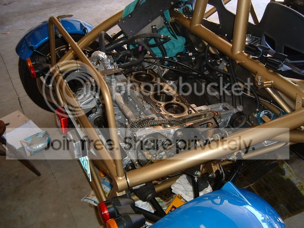

We will have an answer to this question later next week.
I was forced to go with the 8:1 pistons because Diamond didn't come through in time so we used my spare wisecos from the race engine.
I am scheduled to go to a test&tune next Friday and my_bd's Redline with the TVS is going too, so we can do some comparisons.

For myself I don't need to push this setup to it's limits simply because of my "other" car.
I would have preferred the stock compression pistons instead of pullying down.
I am hoping this all works out nicely because if something goes wrong, I doubt the wifee will be to thrilled about me building another engine. Then again, there is the spare race engine.......
