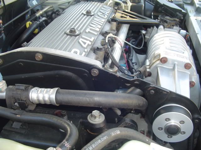

GM made a kit for the 2.4 twin cams as a upgrade
ive got the proto type on my cav , click link for pic
http://www.azjbo.org/forum/garage.ph...od&image_id=33

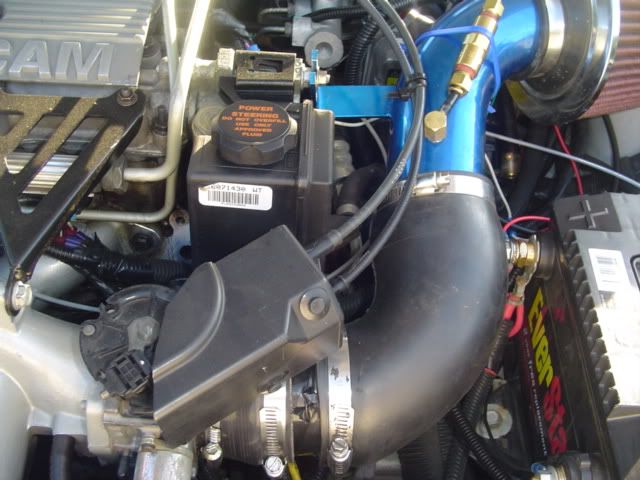

Would you post a few pictures of your W/I setup?
Old Aug 11, 2006 | 06:55 PM
charged_sunfire's Avatar
Joined: 03-19-06
Posts: 433
From: MD
here ya go, the blue ziptie is only temporary as the injector its holding for the meth injection will be tapped into a throttle body plate between the charger and the throttle body so it wont short out my TPS due to water getting in there from the injection.
