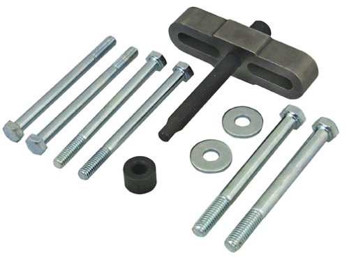

use a clamshell puller and use a gm powersteering pulley installer to put the hub on
it can be rented from autozone its like 35bucks then u get it all back when u bring the tool back
http://www.reidsupply.com/images/pro...264_ImageC.jpg
http://ecx.images-amazon.com/images/...4L._SL500_.jpg
luckly my pops had this in this tool box
you need both of those
