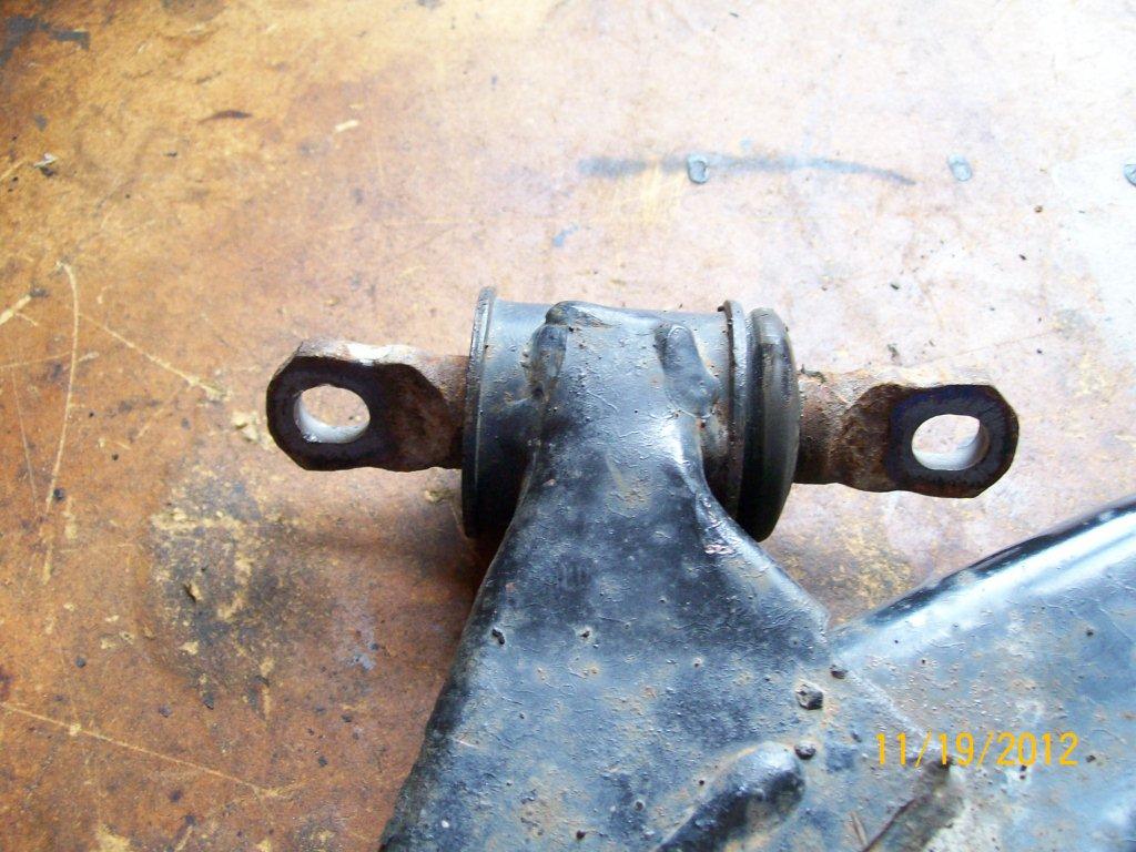

I have a regular Cobalt not an SS, but today my husband found the driver's side has a damaged control arm bushing similar to Powell's picture (haven't taken the arm off yet so don't know full extent of damage). The vehicle was aligned in February 2012. Could the bushing have become that damaged in 9 months or should there have been enough damage to be seen when the alignment was done? (They put it back on the rack after the initial alignment, said it had "radial tire pull" and put that tire on the rear.)
Also, we recently replaced a warped rotor on the same side when we replaced the brake pads. This eliminated nearly all of the steering wheel shudder we had. Could the bit of shudder I still get at times be from the damaged bushing?
UPDATE: Replaced rear bushing 11/19/2012; it pretty much looked like the above. Has anyone ever had this problem with the front bushing?
This kept the "ears" from lining up with holes in the frame. It took a long time, but we finally got it back to the left enough to get the arm remounted.

Based on what you are saying, I would guess the alignment shop missed the bushing ( some folks just dont look/know/care) and the tire was worn from that, and putting it to the rear put a fresh tire with more tread and better able to deal with an arm constantly moving out of position.Same goes for braking , the arm moves forward when you brake and back when you accellerate, not a good deal especially if one side is broken and the other is not.
Best bet?? Replace both arms with alloy FE5 arms The castor angle will change slightly with the alloy arms and thats a good thing. Try CED or Rock Auto for best prices on arms. Dorman have some tiawanese alloy arms that will work well and cost less. Good luck.
