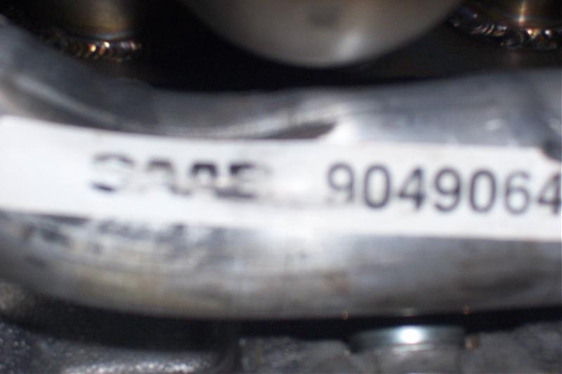

heres the hahn racecraft header bolted to the head

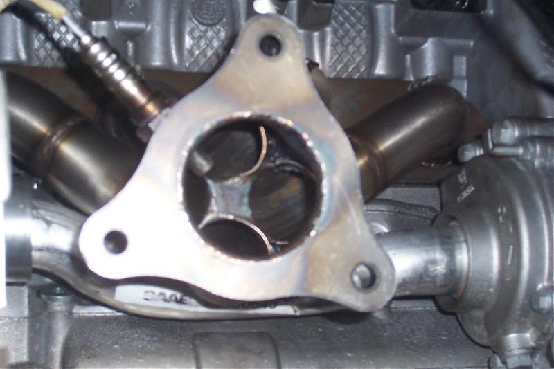

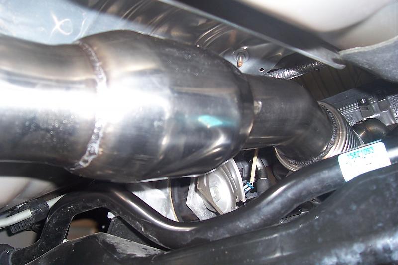

the hahn racecraft d/p with high flow cat
front half of the hahn racecraft cat-back

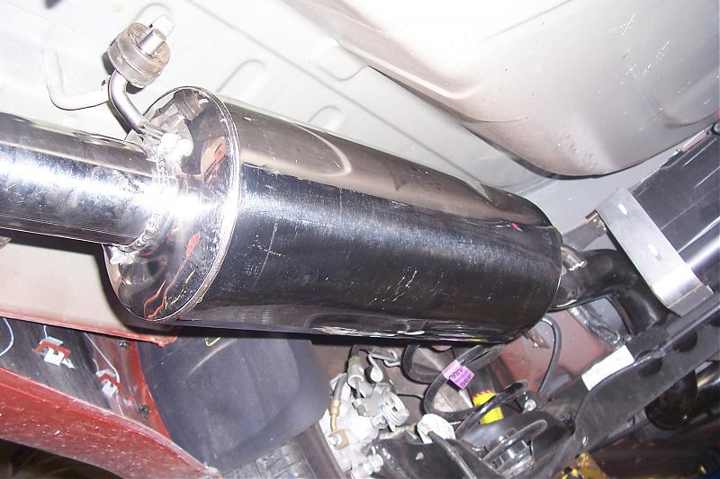

back half of the hahn racecraft cat-back

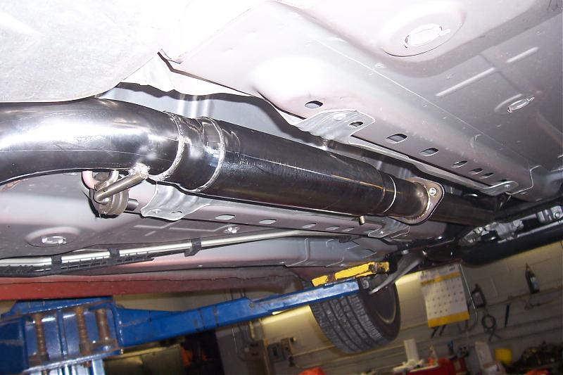

this was the fun part, nothing is just bolt right in this is the pipe that runs from the water pump and at first the header pushed on it when bolted up and caused it to leak at the water pump, so i called hahn racecraft and they said ooooooooooooooo yea just hit the pipe with a hammer until you have enough clerance but this pic is it all bolted up with no interference and no leaks thank god

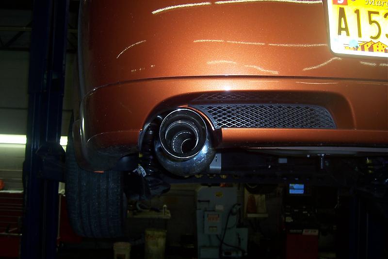

and last but not least the monster 4.5 tip and by the way it sounds great
