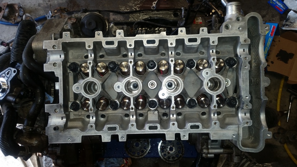

SylverSS/SC's Avatar
Joined: 10-07-08
Posts: 5,121
From: Calgary,Alberta
Guess we didnt take pictures of thenports on the stock head and the lsjion ported one either eh?

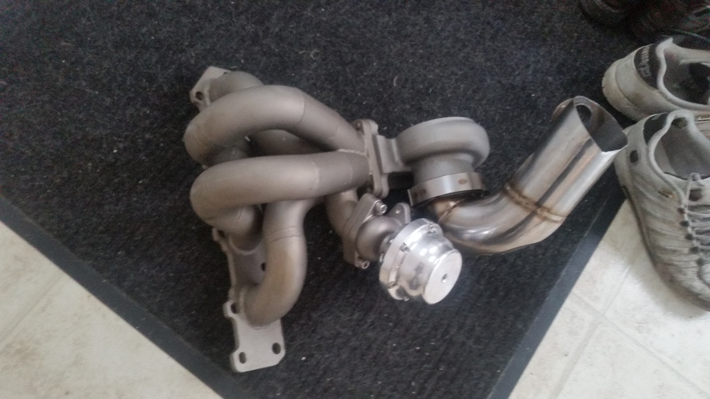

Old Oct 20, 2015 | 01:16 PM
What manifold is that?
Old Oct 20, 2015 | 02:46 PM
Joined: 10-07-08
Posts: 5,121
Its an RDfabs manifold. I wouldn't recommend it. Was a really pain in the ass to get it on and bolt everything up
Old Oct 20, 2015 | 02:54 PM
KMO43's Avatar
Posts: 6,896
Likes: 96
From: Calgary
Nope I didn't I thought you may have in the 3 years it sat in your basement

Old Oct 20, 2015 | 03:06 PM
slapbetcommissioner's Avatar
Joined: 09-15-09
Posts: 4,140
Likes: 57
From: Winnipeg
That is a really good looking turbo manifold.
Old Oct 20, 2015 | 03:10 PM
KMO43's Avatar
Posts: 6,896
Likes: 96
From: Calgary

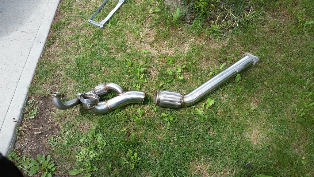

It hangs too low and requires a custom DP I think my buddy Kyle has 30 hours or so in the DP alone

The bolts above and below #3 and #2 were the biggest pain in the ass to get. I had to do a little "custom" power sanding on the primaries a touch haha
Old Oct 20, 2015 | 03:17 PM
KMO43's Avatar
Posts: 6,896
Likes: 96
From: Calgary
It's all Custom
