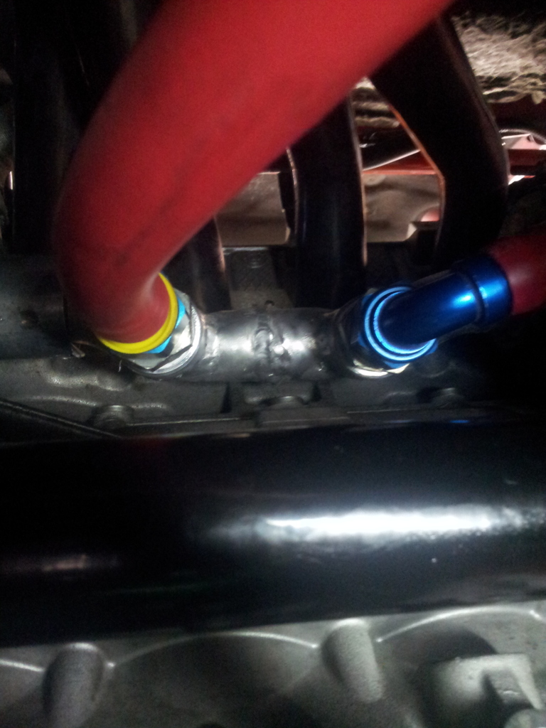

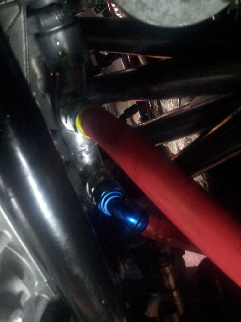

up date....

so Im gona need another fitting the hose dosnt bend like i thought..
wire the pump and retime the engine..

Originally Posted by Tjolley
i just cut the pipe between the bungs and welded a flat pice of aluminum in
Ok so that pic was before the cut, was trying to figure out how you got it to hold in there with no marks on the outside
