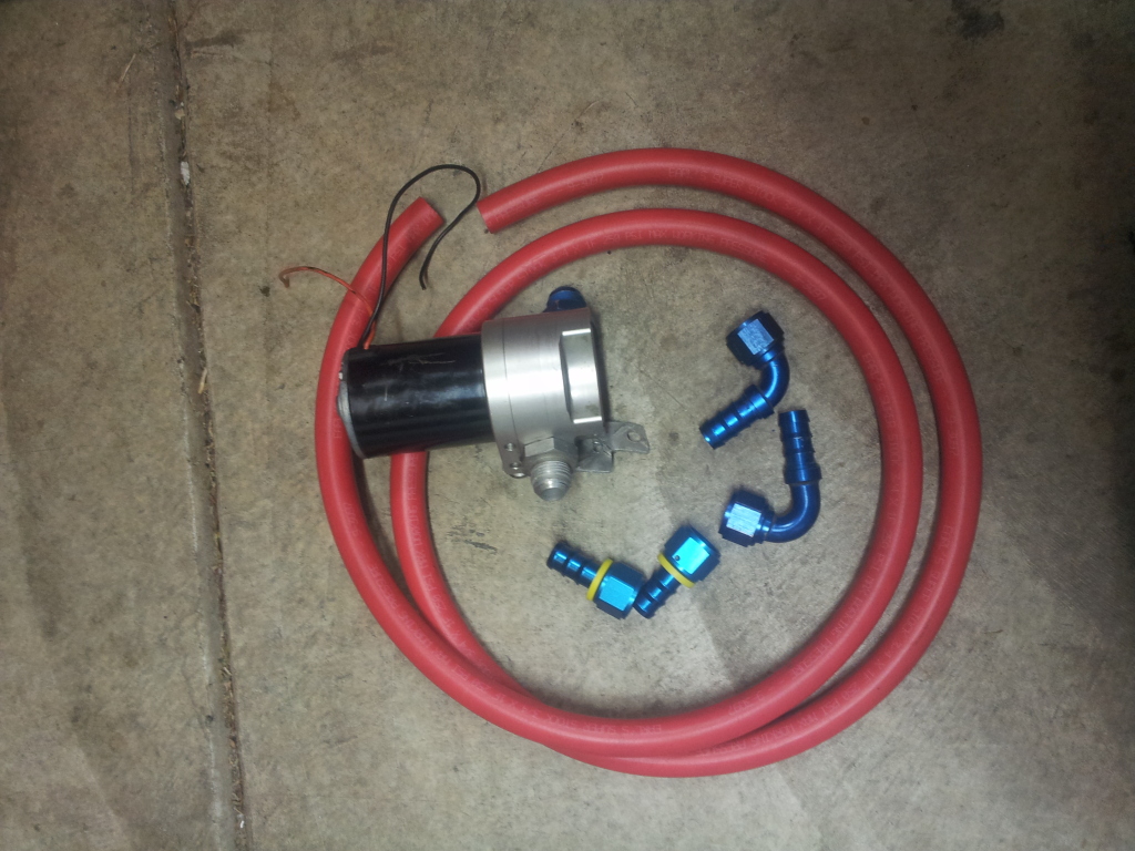

Old Nov 27, 2012 | 10:49 PM
Tjolley's Avatar
Joined: 02-01-11
Posts: 2,799
From: modesto
got some of the parts today.

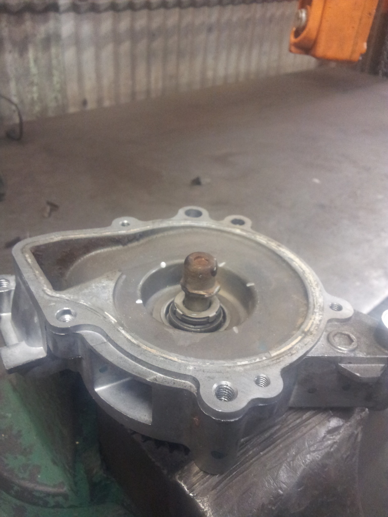

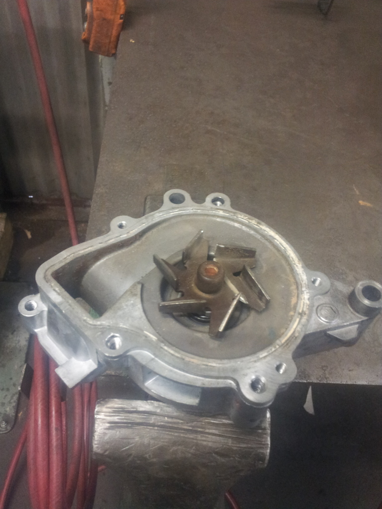

Old Nov 29, 2012 | 07:19 PM
Tjolley's Avatar
Joined: 02-01-11
Posts: 2,799
From: modesto
before
after

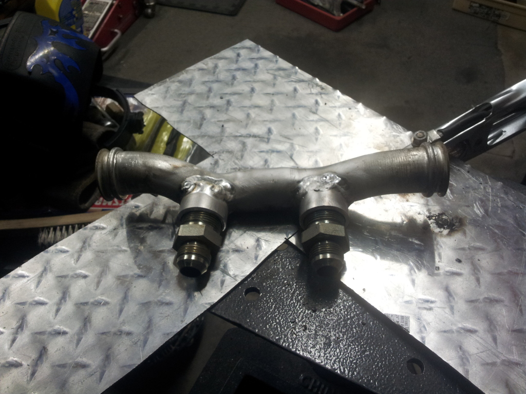

Old Dec 2, 2012 | 04:46 PM
Tjolley's Avatar
Joined: 02-01-11
Posts: 2,799
From: modesto
got the rear tube moded last night..Im not the best with tig but i know it holds..that's all that matters
Old Dec 2, 2012 | 04:52 PM
ItalianJoe1's Avatar
Joined: 11-01-05
Posts: 12,462
Likes: 61
From: Miami, FL
Did you block the center of the crossover pipe between the bungs?

Old Dec 2, 2012 | 05:14 PM
Tjolley's Avatar
Joined: 02-01-11
Posts: 2,799
From: modesto
yes i did..
Old Dec 2, 2012 | 05:43 PM
574's Avatar
574
Joined: 11-16-11
Posts: 6,338
This is part of what's needed for the electric water pump?
