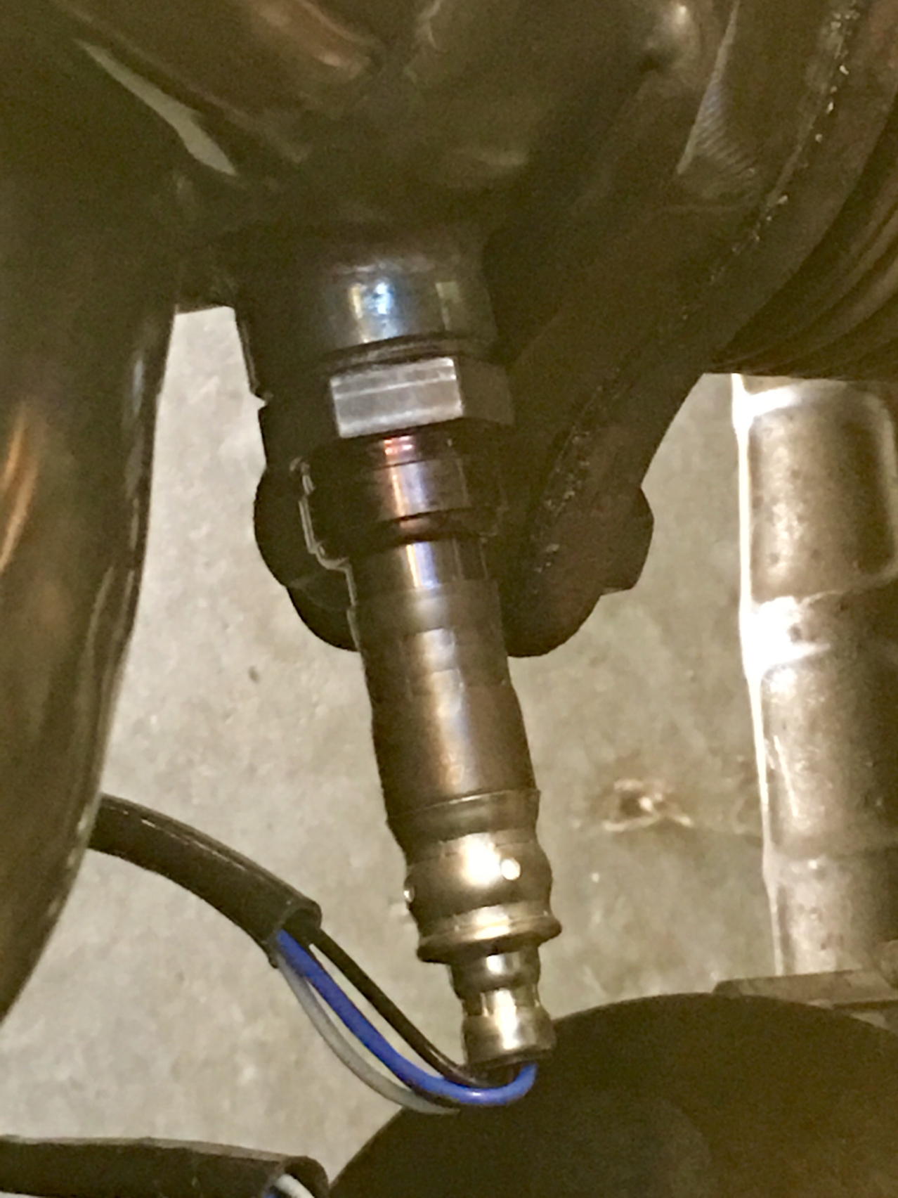

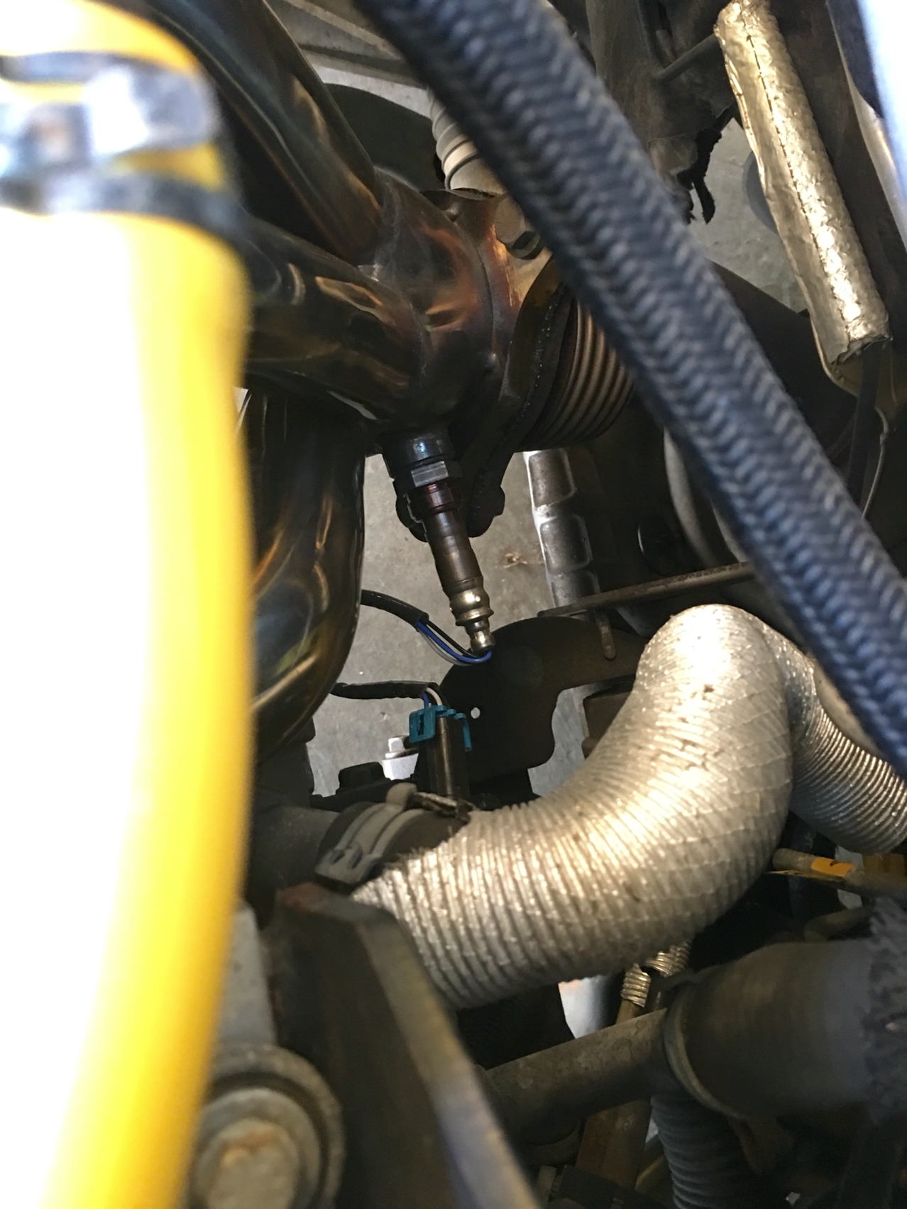

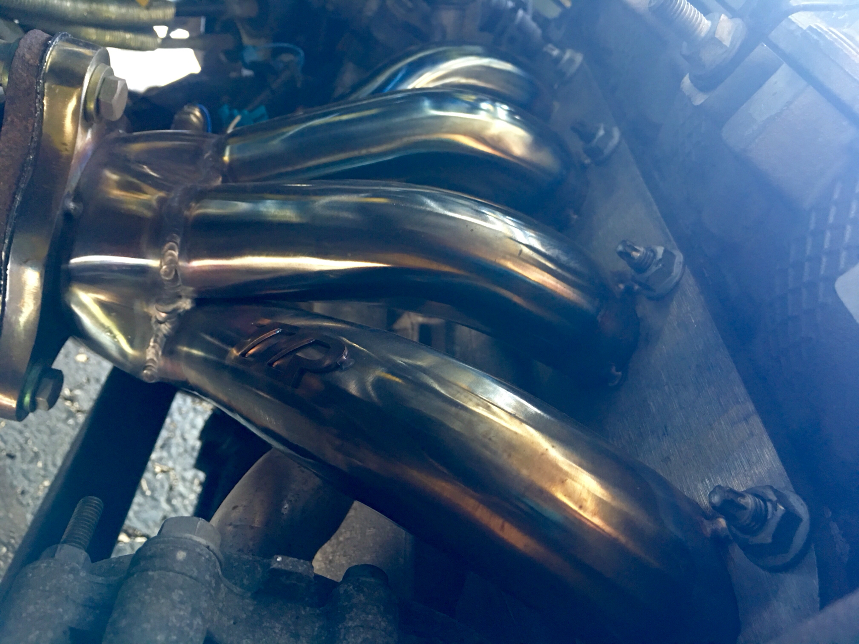

O & if it helps I have a 05 Cobalt SS/SC & below is a current pick of my header & 02 sensor photo144.jpgphoto80.jpgphoto711.jpg

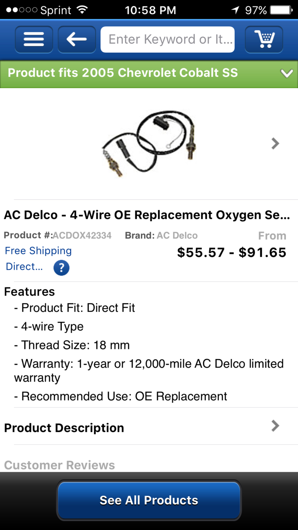

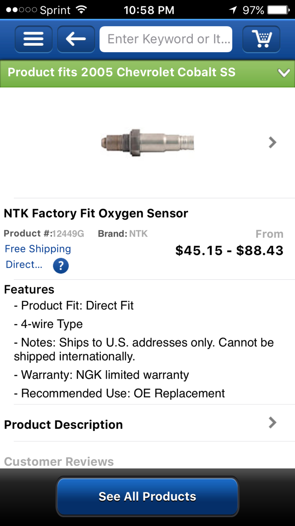

Hey Staged sorry to bother you on this O2 sensor again however I want to make sure that I ordered the right one. I know you said to get the NTK but then in your last post you mentioned something about AC Delco. Below you will find 2 screen shots one for the NTK & the other for the AC Delco. If you could please let me know which one your referring to that would be great thanks man.photo973.jpgphoto335.jpg

Originally Posted by Doug's Cobalt SS SC
Hey Staged sorry to bother you on this O2 sensor again however I want to make sure that I ordered the right one. I know you said to get the NTK but then in your last post you mentioned something about AC Delco. Below you will find 2 screen shots one for the NTK & the other for the AC Delco. If you could please let me know which one your referring to that would be great thanks man.Attachment 9284Attachment 9285
You need the primary O2 sensor.
The one with the long wire is the secondary.
