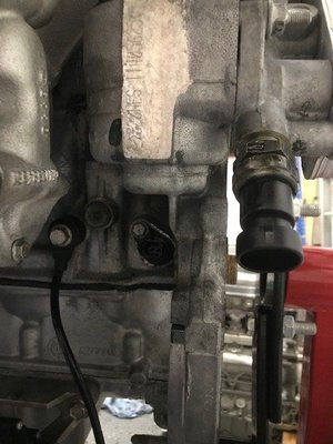

Oil temp sensor / EOT Ciruit Performance.
Where is this sensor located on an LSJ?
Thank you,
Steve

It's on the Oil Cooler right next to the Oil Filter Housing.
Big sensor on righthand side of image.

One more ?, what size oil socket is it?
Fairly sure that it is a 26 mm, but I'd have to check to be sure. I seem to remember it being the largest metric wrench that I have... and that's a 26 mm.
I found a "GM" oil pressure sensor socket, says 1-1/16", I suppose that is the same as a 26mm?
Thank you!

Looks like it is a 27mm or 1 and 1/16"

Yeah, I've seen people use 1-1/16" sockets. I do believe that everything on this car is metric though.
