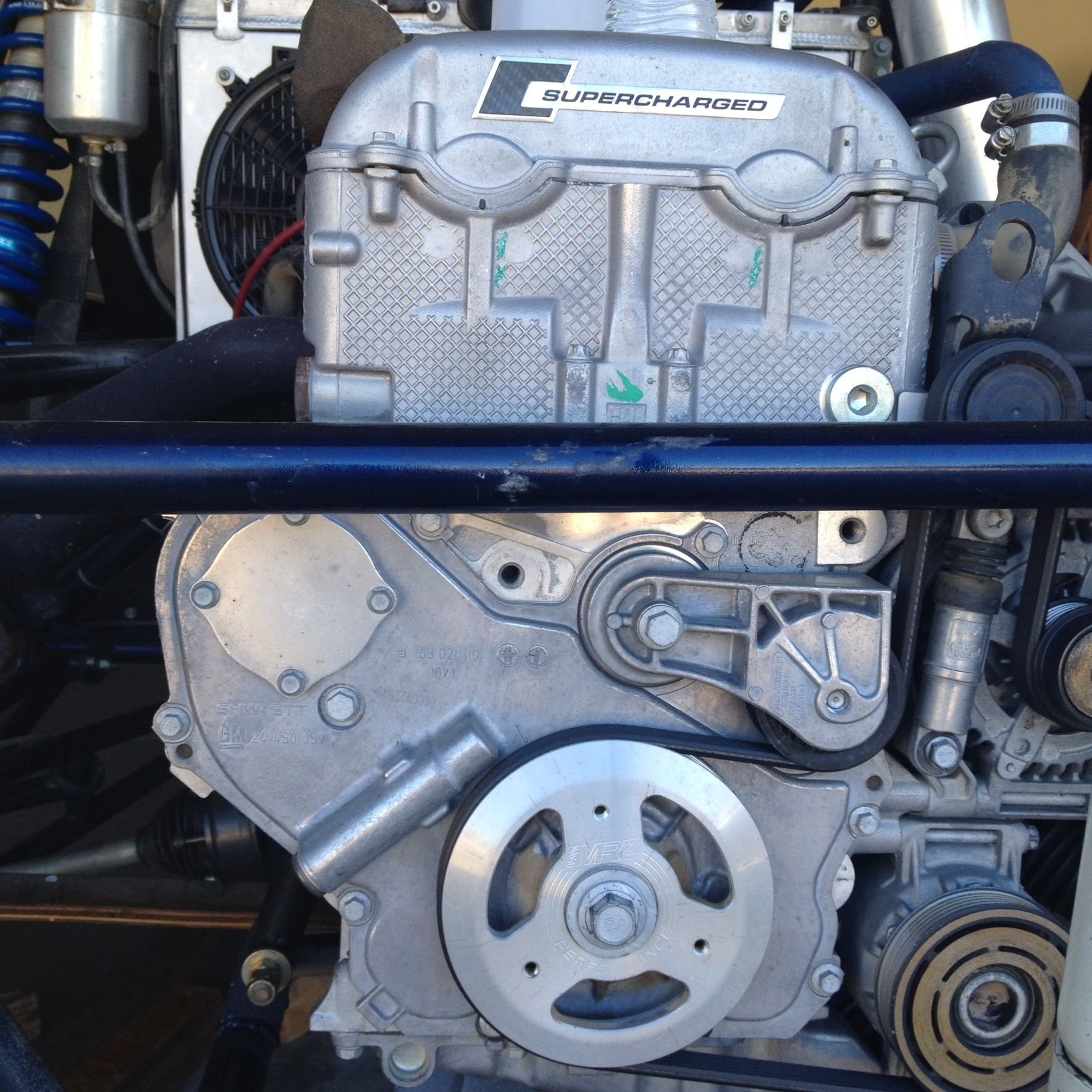

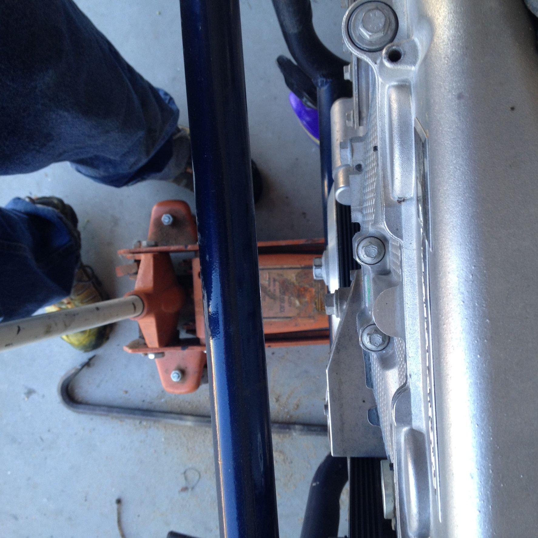

By looking at this blue frame tube do you think I can install a balance shaft delete without pulling the motor? Plan is delete bushing and overdrive fluid balancer. I assume I just grind the cover to fit the pulley and belt. Idk.

You can def install them w/o pulling the motor. Plenty of room.

That helps! Die grinder to that hump above the crank pully sound right? I noticed ZZP sells a cover modified to fit so I'm worried I'm missing something.
I'd take it to a machine shop, not sure how much material needs to be removed.

Tons of room to do the balance shafts in that application.
The modified timing cover is just ground down on the surface, if you're going overdrive it gets into the oil pump valve housing, it's simple enough to test and grind as needed, since the pulley just slides on.
