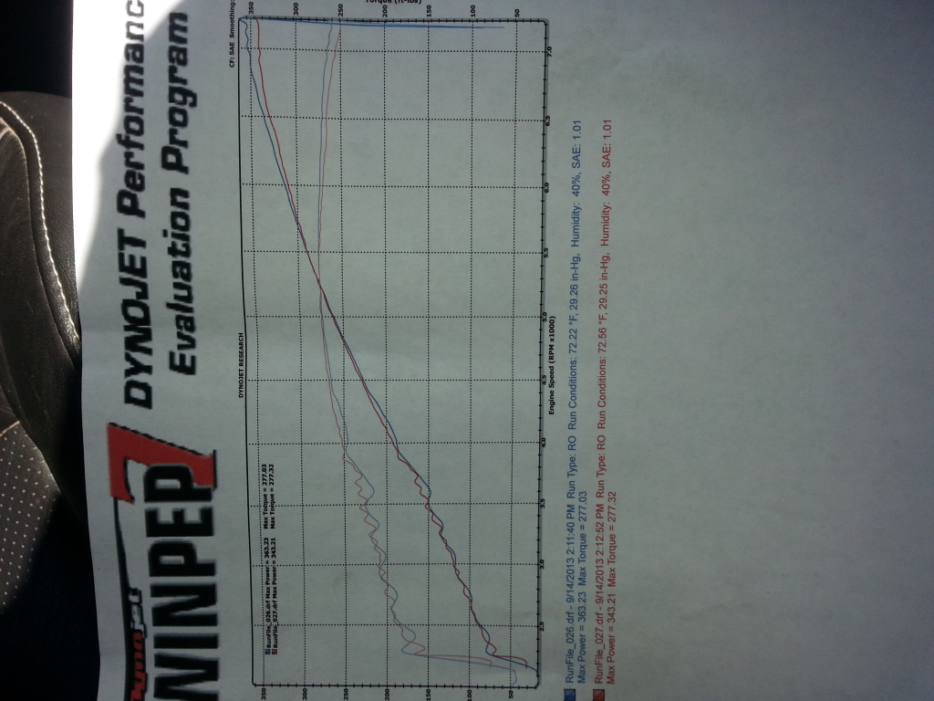

Dynod 363whp

OP - very nice numbers and power curve on the TVS.
Question though... how come you didn't rev it higher? Power was still rising at 7k+
Good luck with the snail.
It was where we had it set, it was street tuned and then took it to a dyno competition and then never got around to raising the limit and re-tuning
