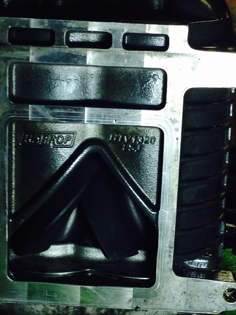

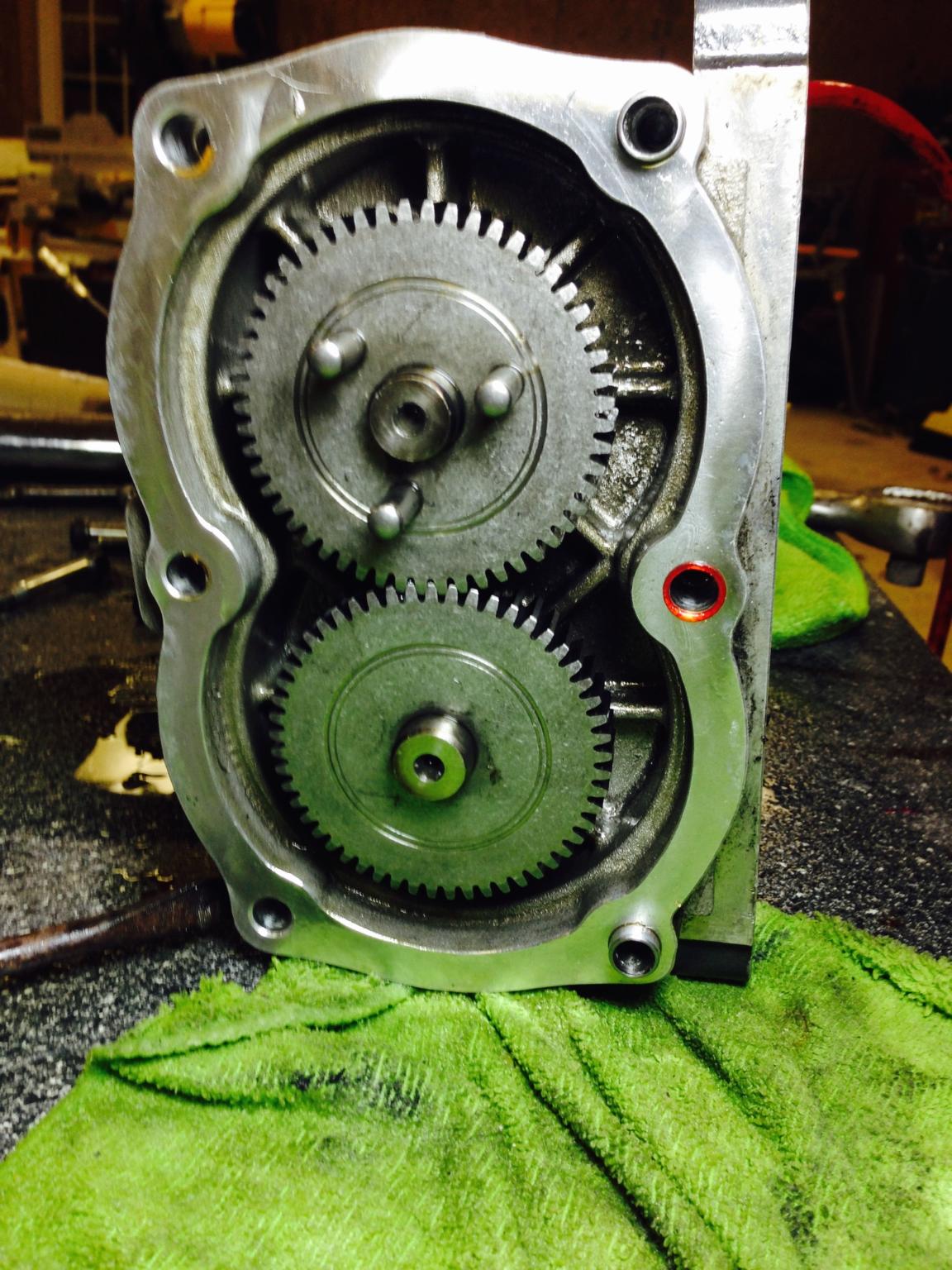

Pics soon can't load them from my phone. The coupler is perfect . Gears are perfect. Snout is off and spins fine. Rotors have 95 percent of there coating on the top and bottom. However the side where the TB is they are scuffed fairly bad. There is a large peice of meal crushed between the rotors. They are stuck in the case also. Really hope this is fixable. Not sure where the metal came from yet till I get the pack out.

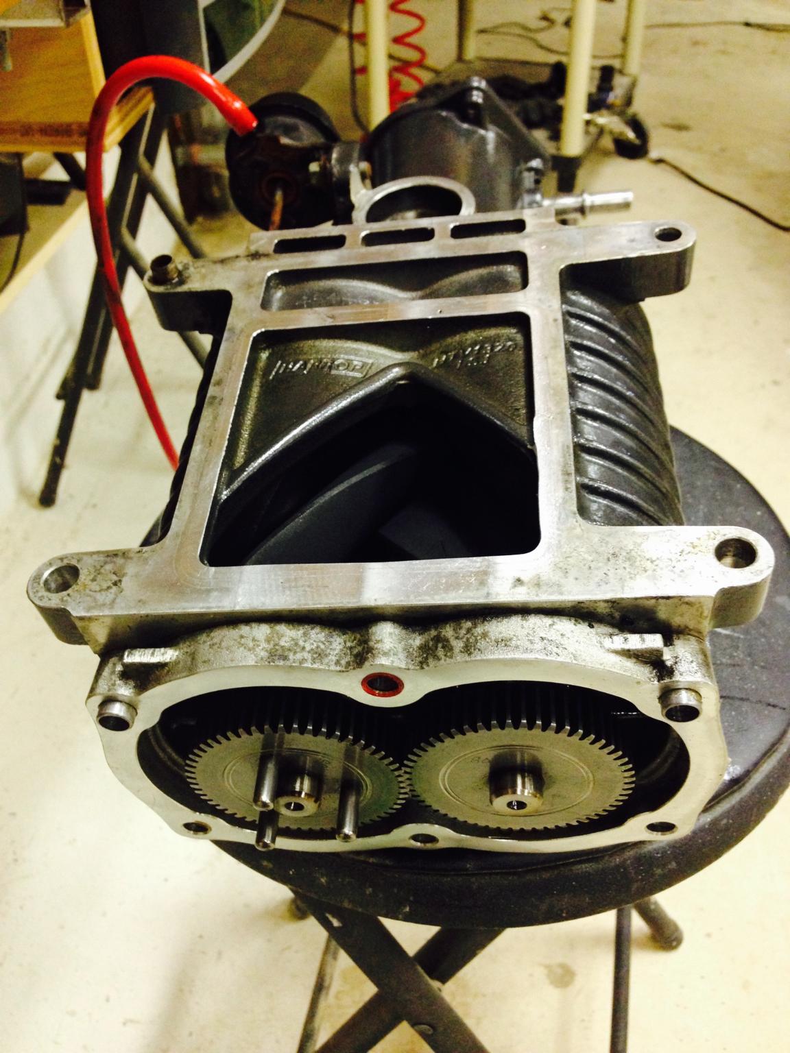

what do you guys/gals think of these pics?
anything else i need to modify to put the m62 back?

looks like needle bearing failed

Yea and now I feel like an idiot for chasing engine noise down for months when this was my problem. . .
