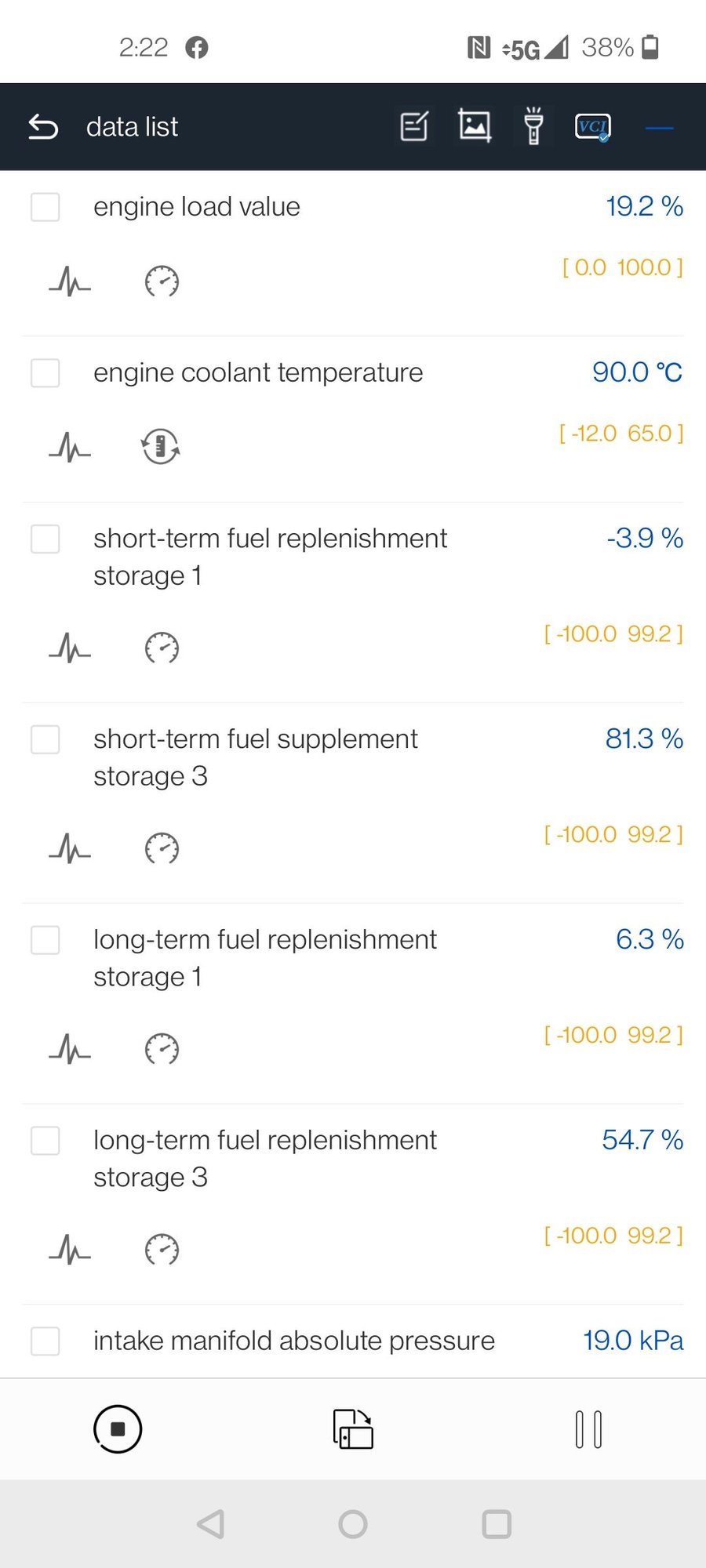

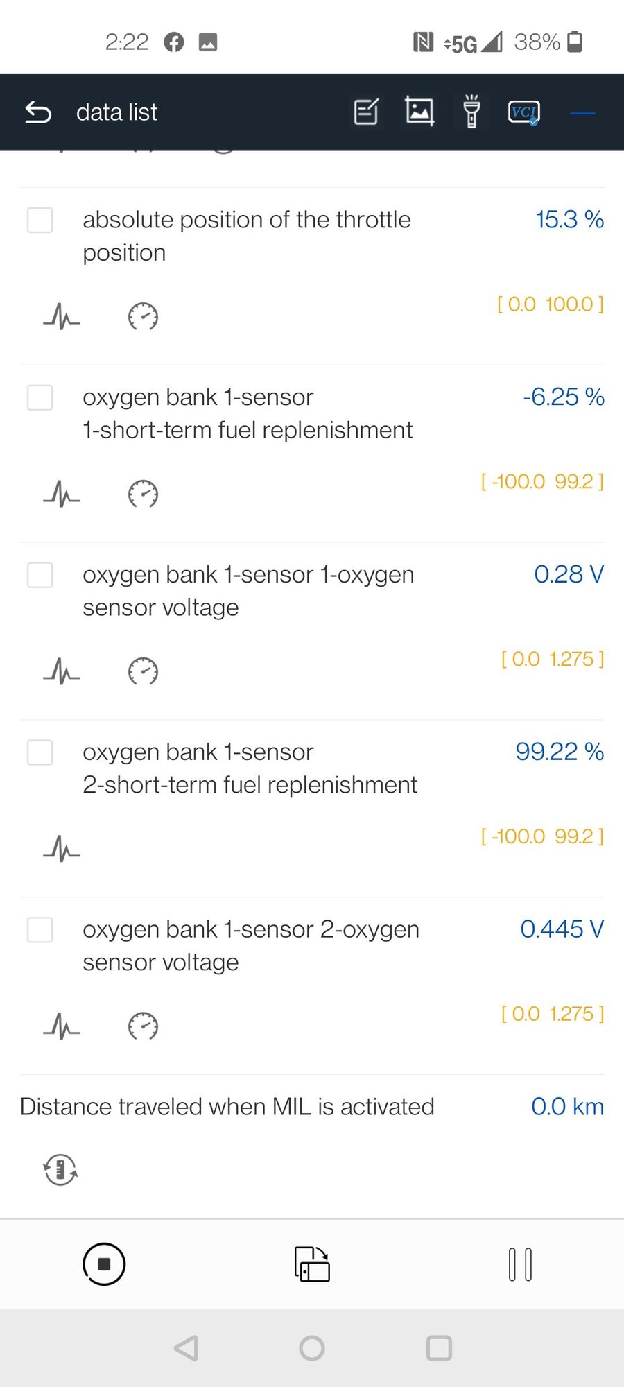

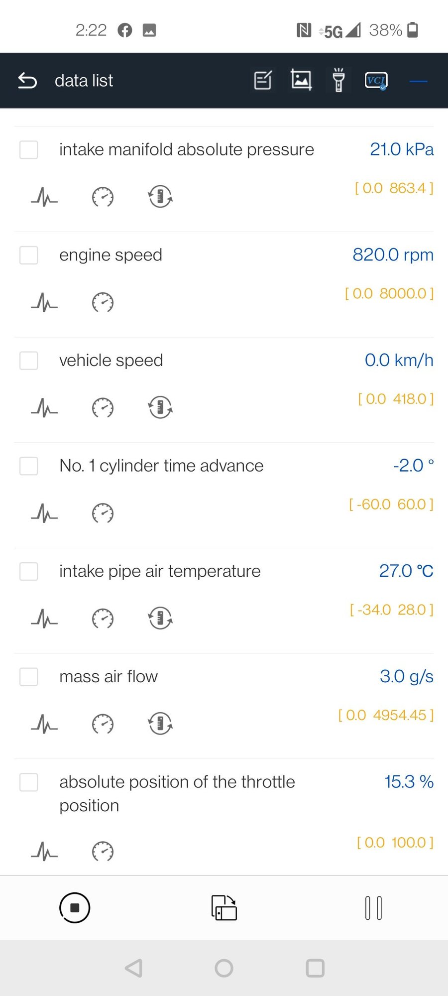

I was thinking about the car also cause it was working for about two weeks after I had it done just fine. Than I heard something while driving one day looked back an seen nothing. Sounded like I kinda ran over something but nothing was there at all not came off I went back an looked. But I did notice I had a small crack in the heat exchanger so that was repaired but problem has only steadily consisted an gotten worse. I had the old set of plugs from when I changed them a month or two ago. An I threw them back on just to see an yes there the ngks same from zzp. An no change. I was thinking clogged injector or bad fuel pump but.. idk if your good at data logs or feeds but here's a live stream photo of it at idle. My short term fuel storage 3 idk what storage 3 is but it's way off. An I replaced my bank one sensor due to a p0171 code an light an it went away ever since. But bank 2 is running really diferent reading than bank one. Could that be the cat as you said
Fuel ratios
O2 sensor readings

I don't see any glaring issues with that live data. The problem with those cheap/generic live data systems is that you see a bunch of stuff that you don't need to see, and often, the context and output that is shows you gives you little useful info.
The STFT and LTFT associated with "storage 1" seem reasonable.

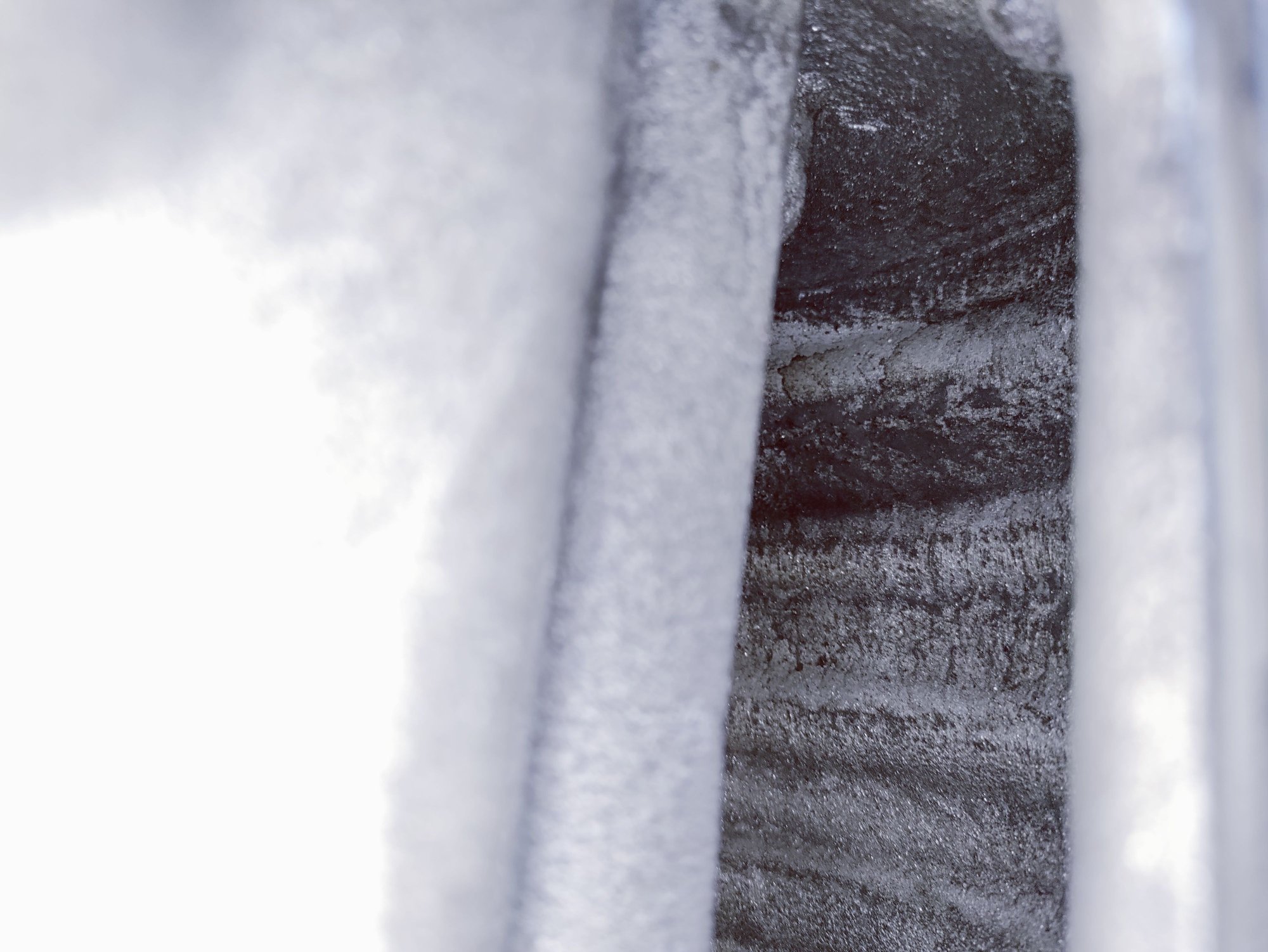

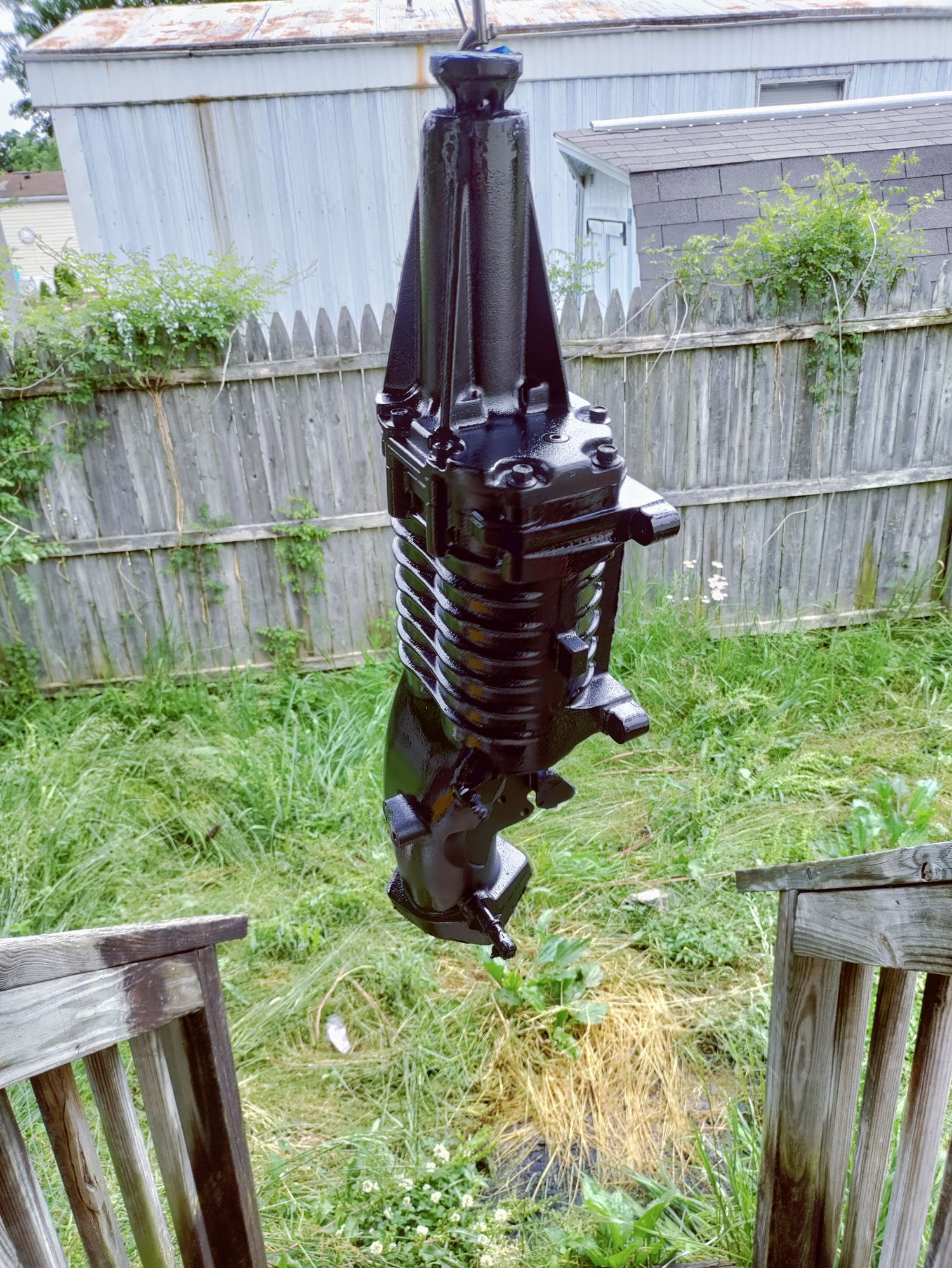

Think I found the issue bro. Took the sc out an there was alot of carbon build up in the intake manifold. Time for seafoam. Also I noticed a huge amount of belt residue on my sc snout. Probably from slippage from my loose tensioner. It's a brand new belt an it's fresh soot on the snout so I cleaned it all up ordered oversize pulley an stage belt should tighten that up. Also painted the sc black with blue splats while it's out lol. Changed the coupler an the oil.
