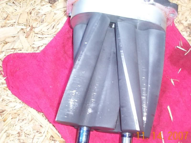

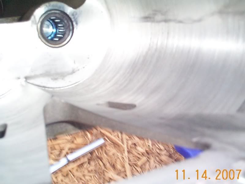

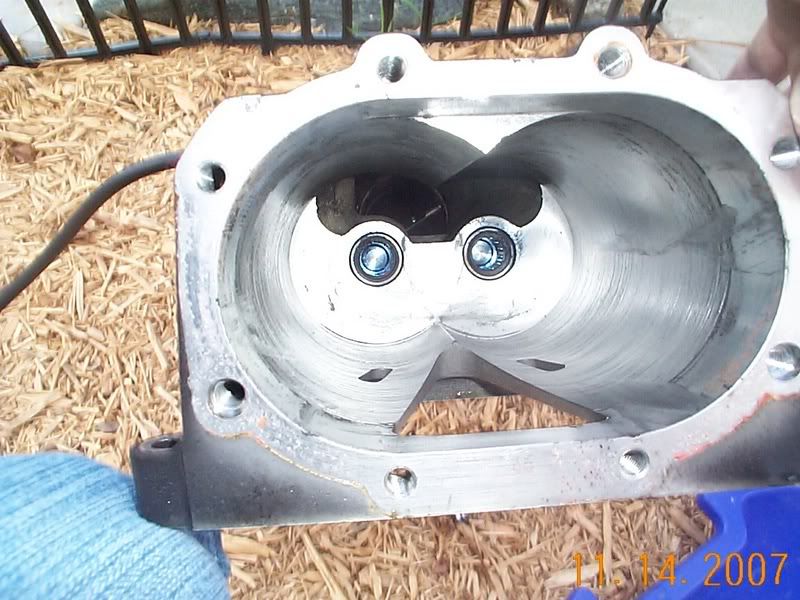

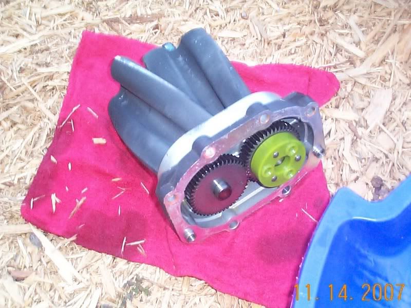

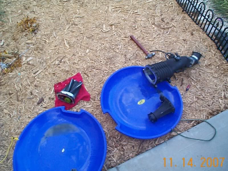

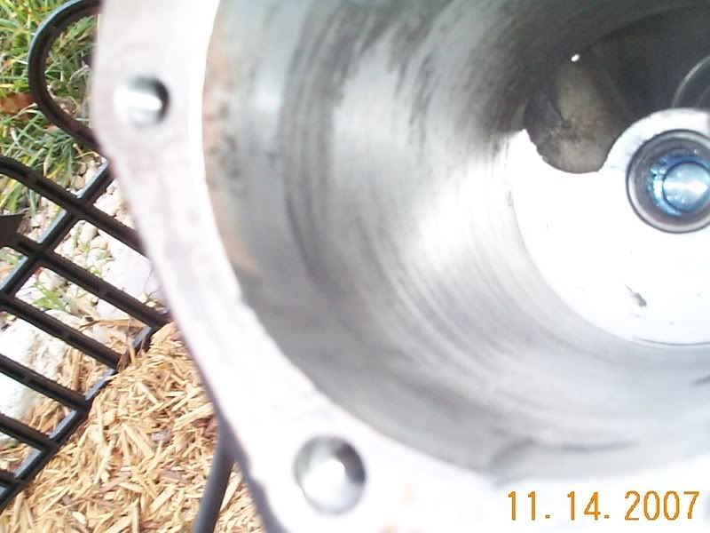

k, so I serviced the S/C tonight....very easy.....had the s/c off the car, replaced the coupler, removed the rotors to regrease the needle bearings, resealed everything, and put back on the car, in about an hour...maybe an hour and 15 minutes......long story short the knocking has gone away for the moment but I found that I really need to get my S/C machined/ ported.......when the coupler wore and the rotors had freeplay it caused them to rub each other and the s/c housing...and as you can see from the photos its not pretty..........

i agree if you're going to leave the s/c stock then don't touch it...but unfortunately, smaller pullies spin the s/c faster and up the temps. inside...which cause the coupler gets worn, and the bearings lose some lubrication (mine were almost bone dry)...thus causing what happened in my pics above.....although there shouldn't be contact there ends up being contact, lol.....a design flaw that eaton, and in turn, GM, has known about but didn't correct for years.......so yes, you have to pay to play, and service will be required if you want to maintain your s/c.....unless your just lazy and made of money, and then you can just replace it everytime it starts knocking or you have spool lag..............your choice
