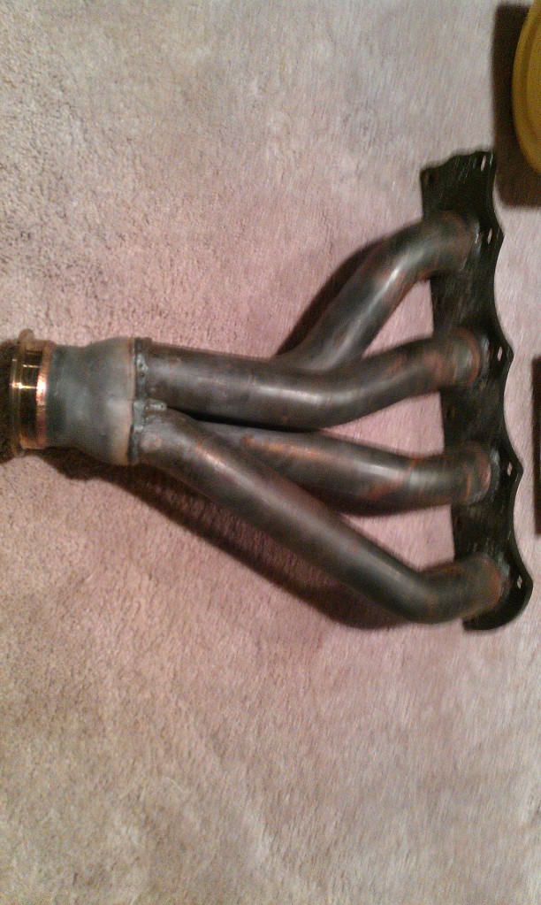

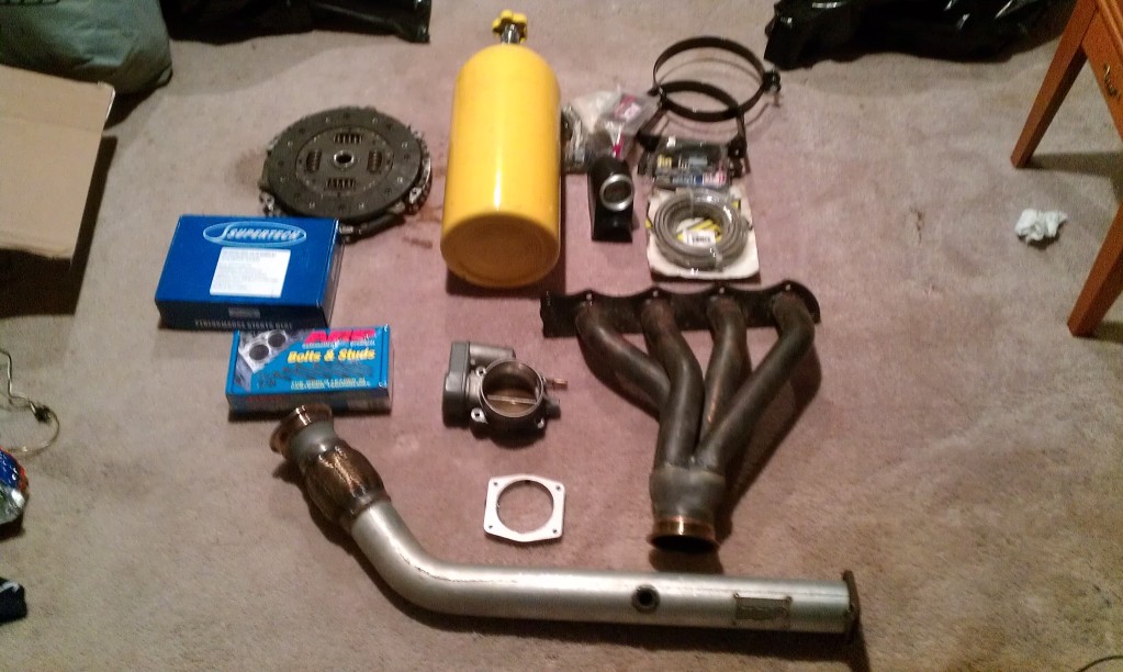

ZZP midlength header

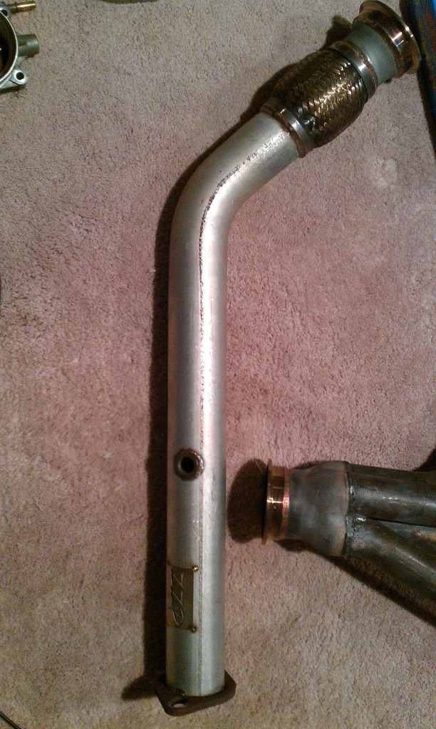

ZZP catless downpipe

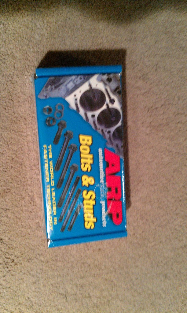

ARP head studs
Supertech 75# Valve springs and Titanium retainers

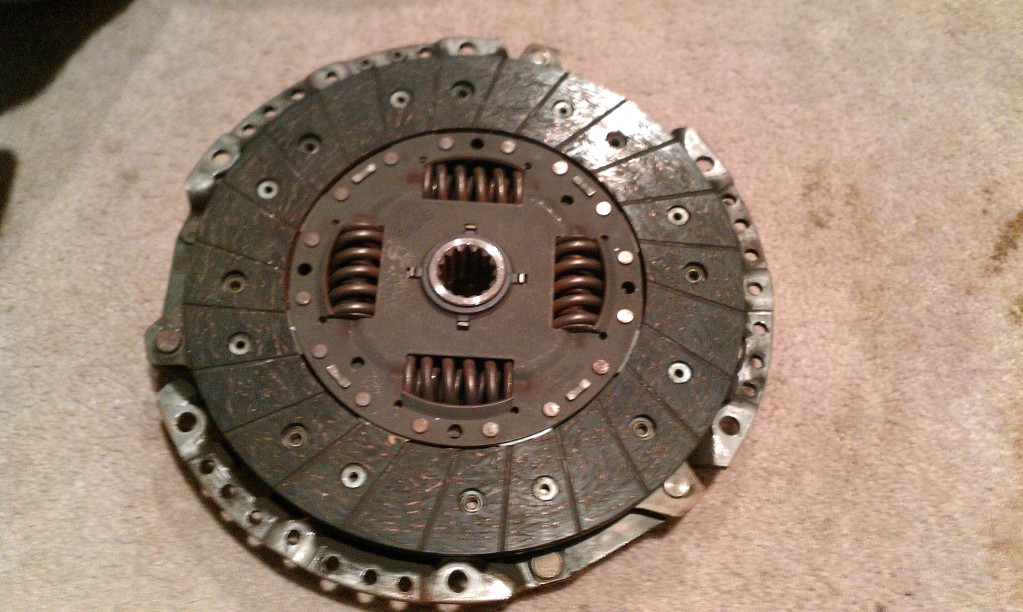

Lnf clutch

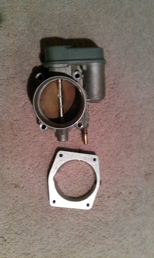

LS4 throttle body and spacer

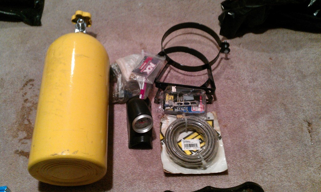

Wet nitrous kit with 25,50,100 & 125 jets. just need nitrous & fuel solenoids
all the parts together cause it makes my D I C K hard lol

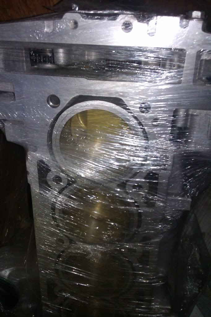

the built bottom end from jbp.
parts list for the bottom end includes
- JBP/Wiseco Forged Aluminum Piston Kit(Stock 9:1 compression Bored 0.040)
- Total Seal Gapless Piston Ring Kit
- Wiseco Thick Walled Piston Pins
- Wiseco Spirolox
- JBP Sportsman Connecting Rods w/ARP Rod Bolts
- GMPP Neutral Balance Shafts
- GM Production Main Bearings
- GM Production Connecting Rod Bearings
- GM Production Engine Gasket Set
- GM Production Conversion Set
- JBP Strengthened Crankshaft
im taking my head off and sending it to the machine shop over the weekend to have the valve springs installed and to have it P&P'd and and valve job done and the spark plug threads fixed of course lol. Still have some parts in the mail like new head gasket, LNF TOB, header gasket, and phenolic intake spacer. once the head gets done will be installing everything but i might wait on the nitrous kit as i would prefer to wait to spray until next year since i will still be running e85 and dont wanna deal with tuning for nitrous and e85 during the cold weather. plan on staying with the stock m62 for now but whos knows what will happen year. I was hoping to get zzp s2 cams for this build as well but i just diddnt have the funds so i will just wait till black friday sale and hopefully get them for dirt cheap. im hoping for anything over 310-320whp without cams and around 350whp when i buy the cams. then ill use the nitrous shot to get me to 400-425whp which is my final goal. thanks for reading and i will have some more pics and some videos posted in the next few weeks as things progress. will have some dyno graphs posted when i have everthing installed.
