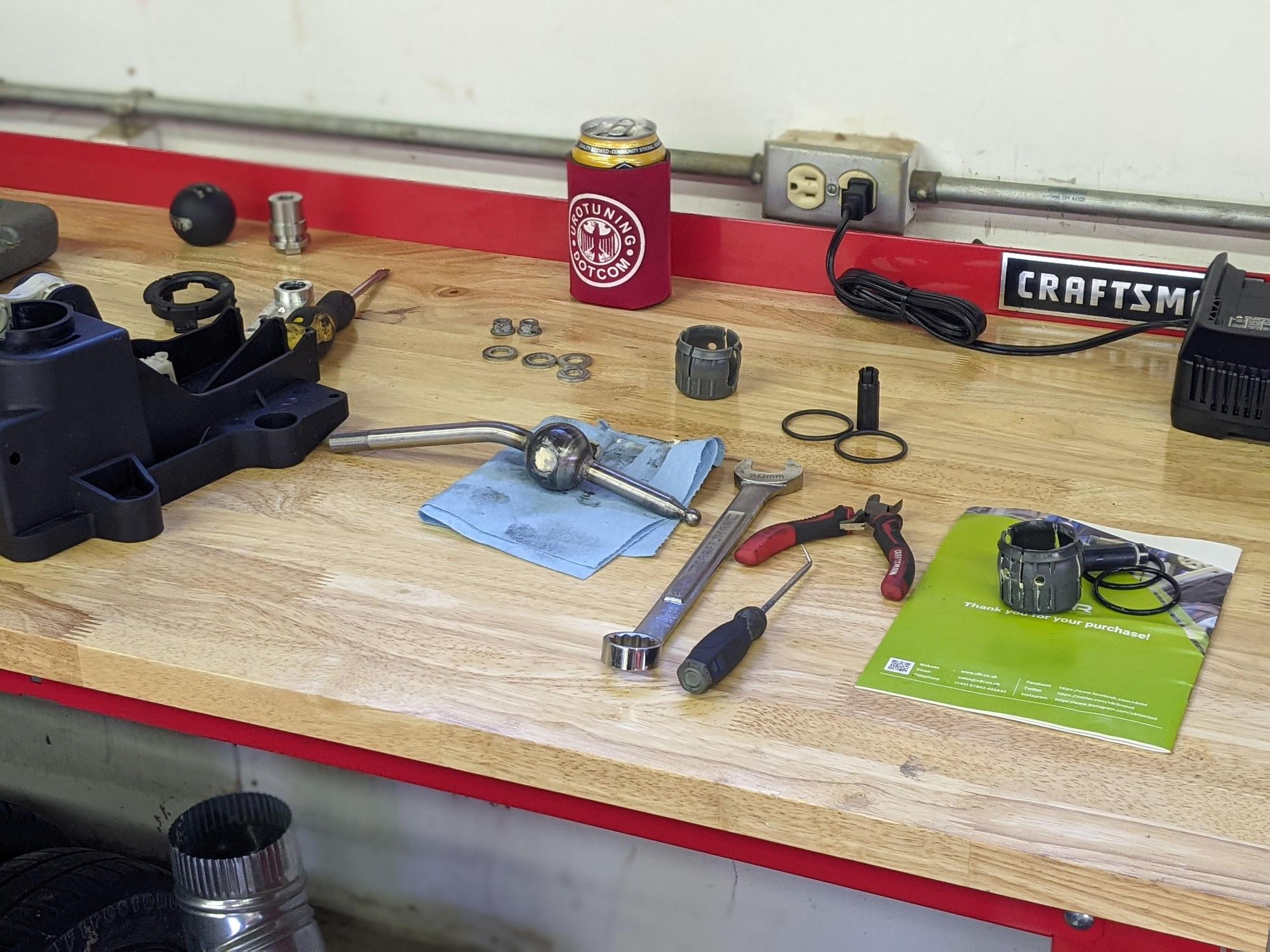

I stumbled across a shifter bushing on Amazon from a company in the UK and decided to give them a try.
For reference... this is how much play my shifter had with the OE bushing: IMGUR GIFV
A quick and simple install though.
You can see here how much the OE bushing wears though - probably made worse by the SS OTTP STS. This was WHITE lithium grease when I installed it over the summer.
The results are terrific though as I can resume NLSing every gear. I do fear/wonder if there was damage done to the transmission while the bushing was bad. The shifting was getting terrible and 4th was getting to the point where it would give a hint of a grind while going into gear when the transmission was cold. Time will tell. I won't be all that upset about it, as I'll probably move to an HHR F23, opposed to another XFE.
