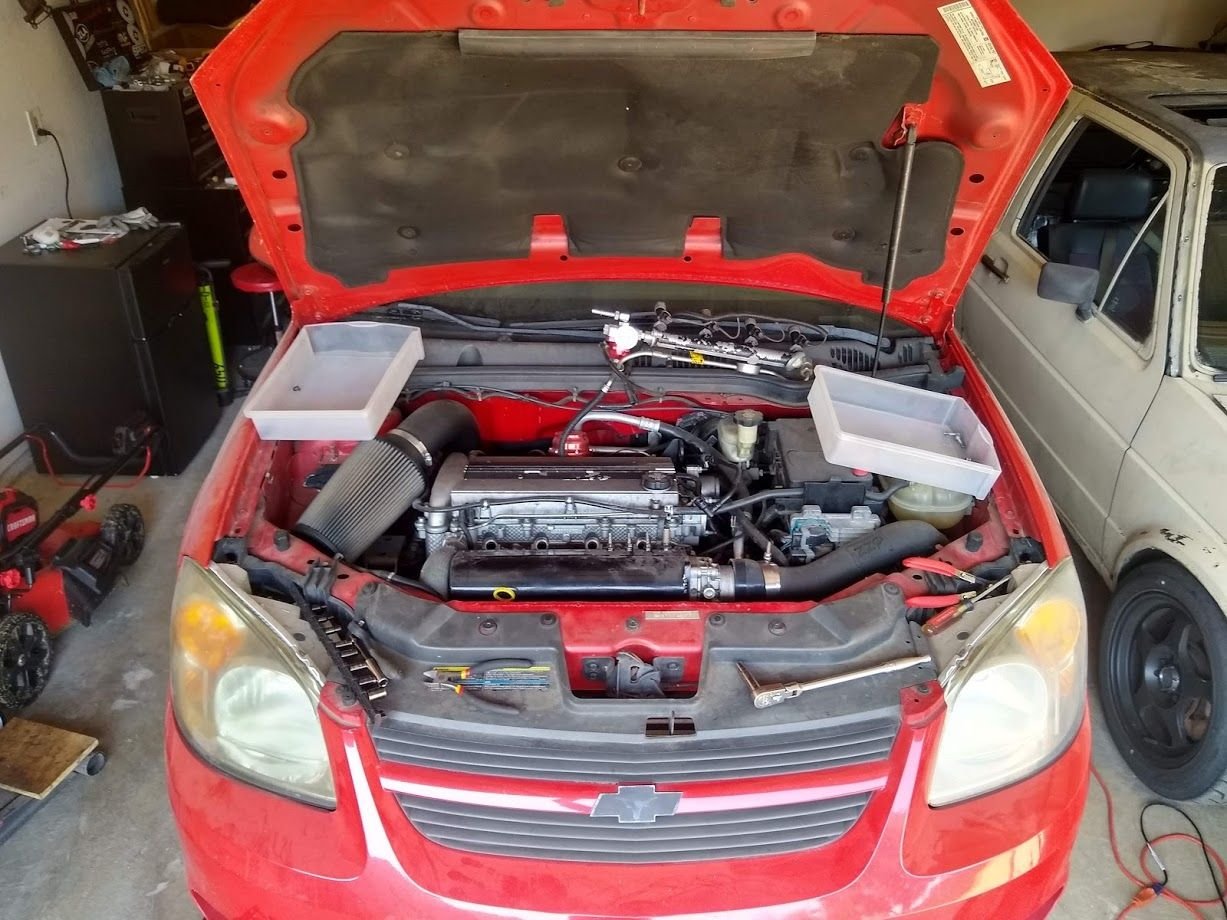

August 2019
A handful of months after graduation, my girlfriend and I are moving into a new house together - time to pull the Cobalt out of its hiding spot.
As I tear into it, I start getting hopeful that it's just something simple, like a blown head gasket. That's what all the initial indicators seem to point to... everyone's favorite "chocolatey" coolant/oil mix.
Look at the left hand side of the sleeve on cylinder #1 (leftmost)... that's a crack, and it went about 4 inches down the sleeve. This block is trash.
A little bit of a motivation killer. But soon after that, I picked up an bare LSJ block along with a bare LAF block (Gen 3 2.4L). I work to pull everything out of the engine bay and run into another bump in the road... when I drain the transmission fluid, it glitters with a nice metallic flake. 😐 Major motivation killer.

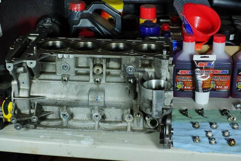

January 28, 2021
It's time to stop screwing around and to get this car that I once loved so much back on the road. The goal is to assemble the engine this weekend. Maybe a little bit more than that, but I don't want to do anything less than that. With that said, there are a few things that I need to take care of - namely, how do I want to do the turbo drain on this engine. I used an LNF block for the last build, but I'm using another LSJ for this one. Machining out the Saab turbo drain port seems like the easiest solution, versus having a bung welded into my oil pan. Something for me to think about and consider.
I gave the block a little bit of a bath with a pressure washer and some Purple Power degreaser... it helped a bit, but this block is pretty ugly. WD-40 on the sleeves and I took a razor scrapper to the mating surfaces and started prepping for assembly.
OTTP Main Bolts and OTTP Timing Bolt have arrived and are ready to go on. I need to grab a tube of Permatex from Auto Zone, but other than that, I'm pretty sure that I have everything. Let's do this.

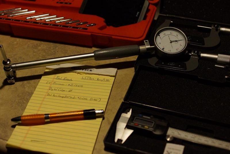

January 31, 2021
Spent most of Saturday and the first half of Sunday watching the Rolex 24 at Daytona, but soon after that was over, I headed to the garage and got started cleaning surfaces with a razor again. Cleaned up a decent bit and just accepted the fact that this was (externally) going to be an ugly block. I then positioned the block up for a hone, oiled the bores, honed the bores, and gapped all my rings. I actually only had to grind the first ring down - the second and oil rings came out of the box at or above the spec I was using... which was actually a little bit unnerving at first.
With the piston rings ready, I threw the bearings from my last block into this block - they only had a few thousand miles on them and all still looked mint - **** it. I made sure to keep them matched to the same crank journals they had been on previously. Reusing the old rod bearings too - same scenario they still looked like they just came out of the box.
Installed with OTTP's main bolt kit and a little bit (too much) ARP Fastener Assembly Lubricant.
I installed the piston rings and then went digging through some old boxes to find my piston ring compressor tool. Started pushing pistons into their bores and slowly/gently lining up the rods onto the crank and installing the rod caps.
Just in time for dinner!
My next step is to try to get the block mounted on my engine stand - or moved to the floor - before it gets to heavy to move around by myself. Following that though, install some of the timing components into the block, turbo oil feed fitting, head studs, etc.
I actually really need to make sure that I check my head for flatness. I didn't do that when I took it off of the car - cylinder number 1 definitely took a large coolant bath... hopefully it'll be fine.
