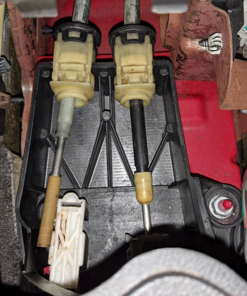

Every thread I'd ever seen or read about the F23 swap simply said they needed "shifter cables"... no one ever mentioned needing to swap or modify the shifter base or cables. Hopefully Paul might hop on here soon and give a clarification to what he's done for it. I've debated just shaving down the threaded part that is interfering... but I'd also rather not "rig" things. The OTTP cable clamps seem like decent alternative, as well. Worst case scenario... I swap to the F23 shifter base.
Eyeballing my shifter cable issue yesterday, and I'm pretty sure the reason that the clamp wouldn't close is because some of the threaded part is still sticking out. And this happens because of a difference between the shifter bases.
My F35 shifter base w/ F23 cables - note how the cables snap in almost perfectly side-by-side... and how the left hand cable doesn't extend all the way into the clamp.
F23 base - note how the lefthand cable snaps in about a 1/4" or so closer to the shifter.
My real question is why. Why not design the car to use ONE shifter base, and then modify the cables to work from there? My guess is because it's a GM... and they make cars by digging through a parts bin to see what pre-existing parts that they can use. The F35 and F23 cables actually seen nearly identical in their setup - both were around 25" long, iirc; the only difference that I could see right away was how far the transmission-side cable ends extended from the mounting pods.

I'm pretty sure you have to use the F23 shifter and base for it to work or cable clamps

That's the conclusion that I was coming to... and OTTP's clamps are backordered. 😑 A friend who just did the swap himself was telling me he had to clearance the F23 base to work in his IRL, as well. We'll see if I can get one pulled soon.

Hit a Pick-N-Pull over the weekend and pulled a F23 shifter base (along with a black HVAC unit). The shifter and boot were in absolute terrible condition, and the base wasn't much better with what seemed like a half gallon of old, dried up Coke caked up all around it. BUT, I was hungover and in no mood when I was at the yard... so I just pulled the first one that found.
Hopped into the garage after work yesterday, though, and got to work cleaning it up. I cleaned up as much as I could with some cleaning spray and a couple paper towels. It's likely that I'll pull the thing back out whenever my OTTP shifter arrives and give it a deep clean then (soak it in some soapy water maybe). Went to work removing my old one not too long after that. Pulled out the F35 base... installed the F23 base. I had to add some washers and do some aligning when torqueing down the nuts, as the shifter bushing holes on the F23 base have a larger diameter than those of the F35 base - the stock nut will grab plastic on the F35 base... it won't on the F23 base. Why GM? Why not use the same bushings between the two?
Lucky for me, I still have a weighted shift knob from the Volkswagen Jetta that I had before the Audi S5... and it fit like a charm. Put my shift boot on, tightened down the set screws, connected the shift cables... and it rows the gears! Put the interior back together and got to work under the hood.
I spent an hour trying to find my deep well 11mm socket, which is an absolute necessity for dealing with a dozen t-bolt hose clamps, but I just couldn't find it (my garage has become a pigsty the last month or two). So it took me a bit longer, but I installed all the charge piping, threw the radiator/condensor package up, connected the radiator hoses and clamps, and then filled the cooling system with a 66% water coolant mix. Threw on the headlights and the intake pipe... I'm going to try to put the windshield wash reservoir back in the car... but the fill neck routes right where my intake filter goes... so that will likely still be a no-go.

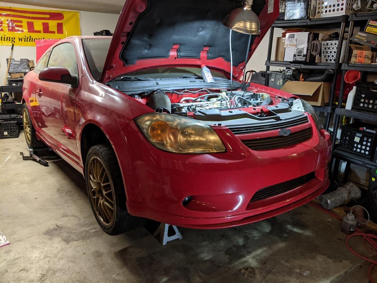

Hit the garage right after work again and started buttoning the car up. First thing to do was put the front bumper support beam and intercooler back on the car. I don't remember ever struggling with this thing before... but I absolutely could not get the bolt holes to line up. A lot of banging, smashing, and eventually... driving in bolts that didn't seem like they wanted to go in. Note to self: never remove the crash bar again.
Finished buttoning up the charge piping, torqued the cradle bolts, and then put the front bumper back on the car.

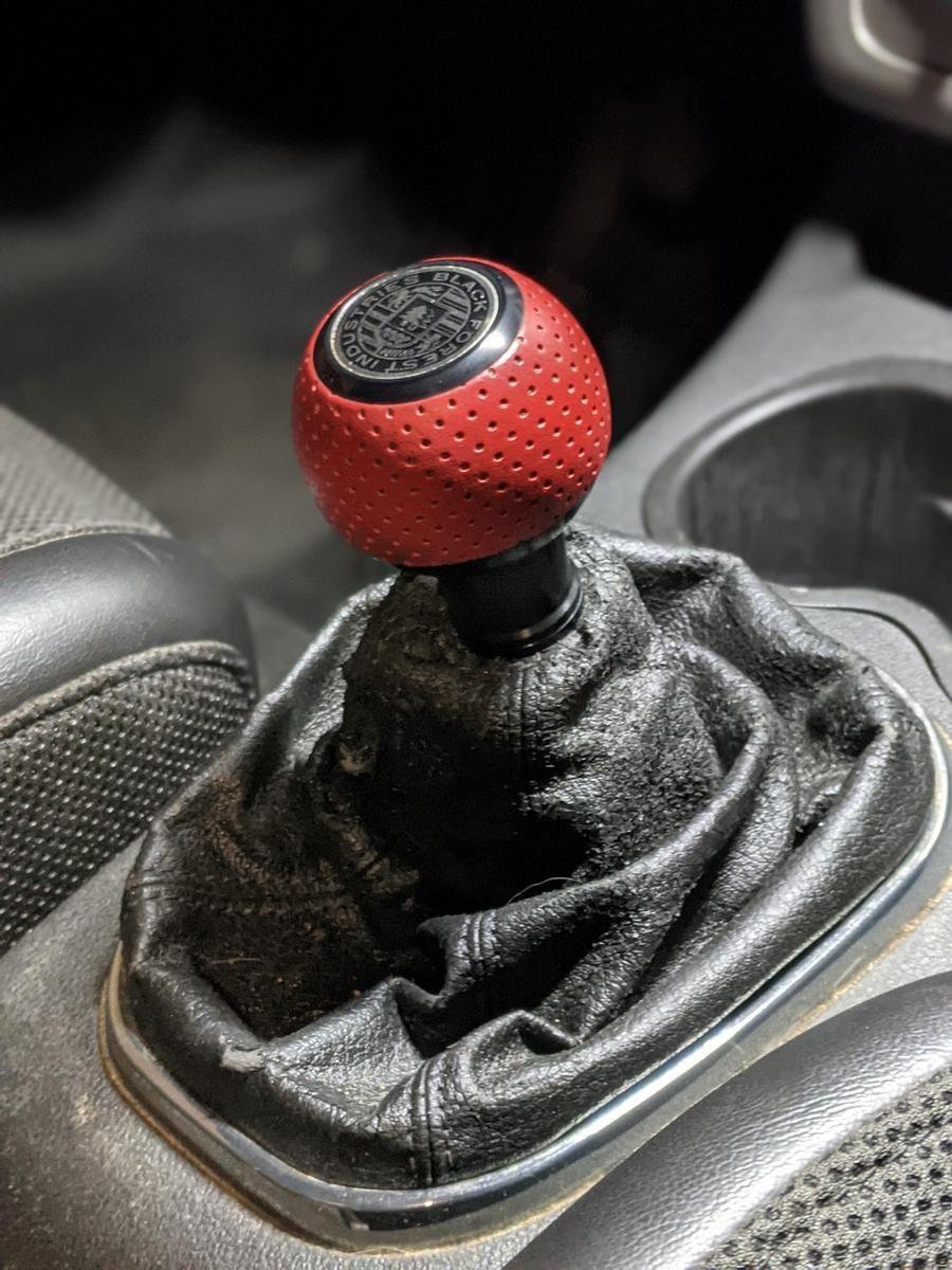

Shift boot is looking a little rough... I'm going to have to figure something out for that.

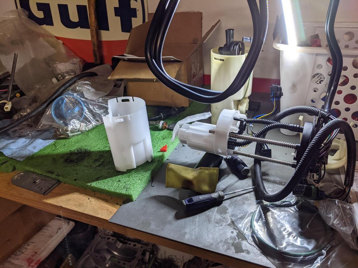

Then came the fuel pump housing. Surprisingly, the aftermarket Delphi housing was pretty easy to work on. The hardest part was removing the fuel line from the top of the pump and bottom of the cap; ended up just having to cut it. The pump power plug from the Delphi pump actually snapped right in to my AEM pump, so that made things super easy. And I removed the FPR, because I have mine mounted on the rail and use my "EVAP" line as my return line.
Now... putting the tank back into the car was surprisingly difficult. I think my exhaust was getting in the way, because I've never had that much trouble putting it back in (and now that I type this out, I remember that every time I've ever done this before, I was using a side-exit exhaust, and it didn't really interfere).
With the tank bolted in... I removed the jack stands and rolled it out of the garage.
I have my jerry can in my car to grab some 93 on the way home, I need to flush/bleed the hydraulic system, give the ole girl a bath, and then turn the key. I have a pressure bleeder, but I'm betting my VW/Euro adapter cap won't work with the GM reservoir. Not sure if NAPA will have something like that though. I'll figure it out. The clutch bleed is going to be a royal PITA... I should have done that before connecting all the electronics, when I still had plenty of room.

Awesome! I'd recommend a shift boot from redline goods.

I'll have to remember that. I think the big problem that a lot of people are running into is that the plastic retention bit that the stock boot is stapled to gets super brittle with age, and they're virtually impossible to buy New/NOS.
I've tried my hand at modeling for a 3D print, but GM used a lot of increasing/decreasing radii, so it was hard for me to quickly pop something out that would work. I might work on that more later on.

Choppy idle, but I figured out the FPR needed adjustment back up to 43.5ish psi. Did that and the car idles a bit smoother now.
Drove it around the block, came back. Lots of blue smoke.
Looks like maybe the oil feed to block connection was leaking a little bit, but I didn't see a ton of oil spray. Turbo oil drain definitely leaking at the block connection, but a drip-drip-drip. Bought o-ring kit at AutoZone, installed slightly larger o-ring... seems to have done the trick.
Drive around a bit more. Car running decent. I forgot to adjust the VSS though. -_-
No visible oil leaks when I got home, but there is a lot of smoke from around the turbo CHRA. Not sure if just old oil burning off.
Added to insurance policy with extra fire protection and $5000 in "custom parts" insurance.
Tried eyeballing the alignment, but the car feels a touch squirrelly when turning.The factory just used 3M tape, iirc.
