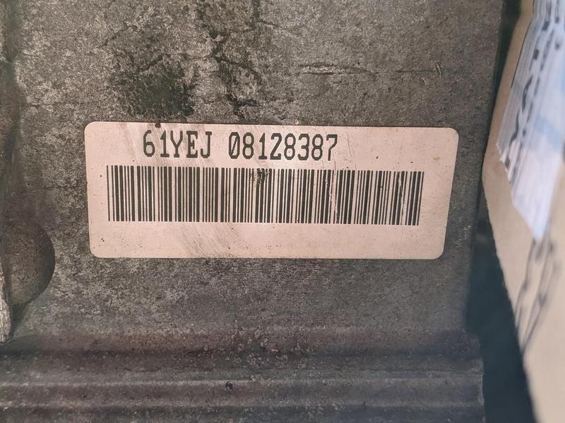

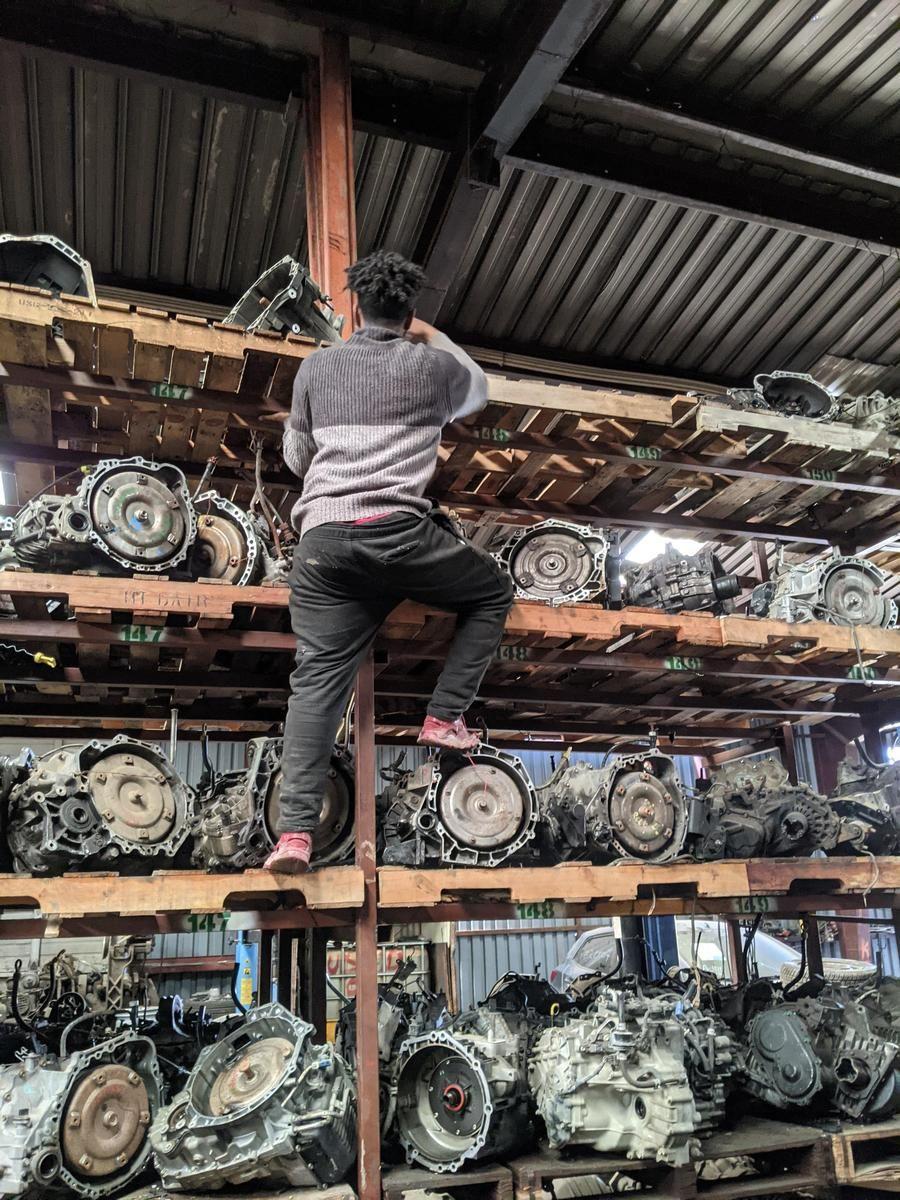

Allegedly a 43,000 mile XFE transmission.
"SAFETY IS OUR #1 PRIORITY!" Climbing the racks to pull my transmission down. Gotta love small businesses.
This tag is on the transmission, but I haven't been able to turn anything up on google with it.

Anytime a company says safety is our number 1 priority, it's usually about number 5 in reality.
Did they add the red on all the bolts?

Yes, they marked all over it. I really laughed when they added a core charge of $25.

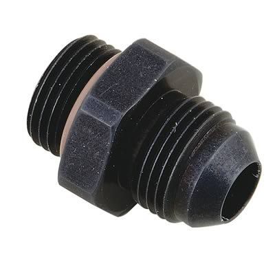

Did you use something like this for the oil pan: https://www.summitracing.com/parts/sum-220164b
Summit Racing® AN O-Ring to AN Adapter Fittings SUM-220164B
Fitting, Straight, Male -10 AN to Straight Cut Male -10 AN O-Ring, Aluminum, Black Anodized, Each
Old Feb 5, 2021 | 01:01 PM
  #50
That looks like the fitting, I bought mine from Radium Engineering, they list it as "10AN ORB" but it appears to be the exact same thing as what you linked
