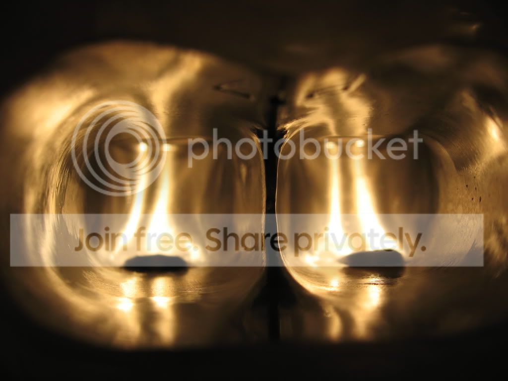

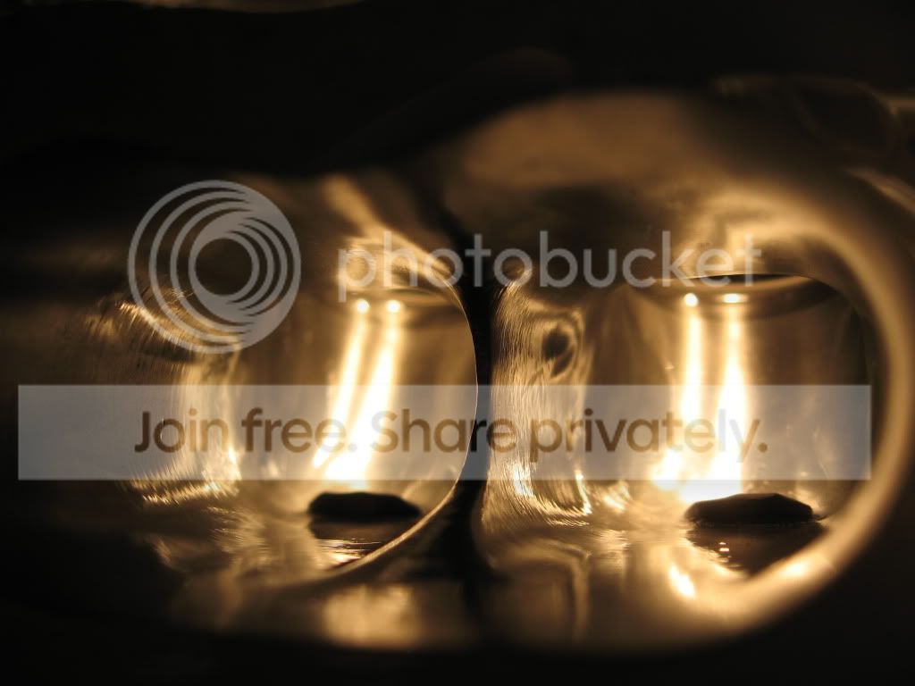

getting a 3 angle valve job on the head, and having my buddy port and polish it for you...to giev you guys a idea of his PnP job:
already bought a PnP intake manifold for the blower :p having it port matched to my new head, getting this from ~jayson~
Before
After:
Before:
After
