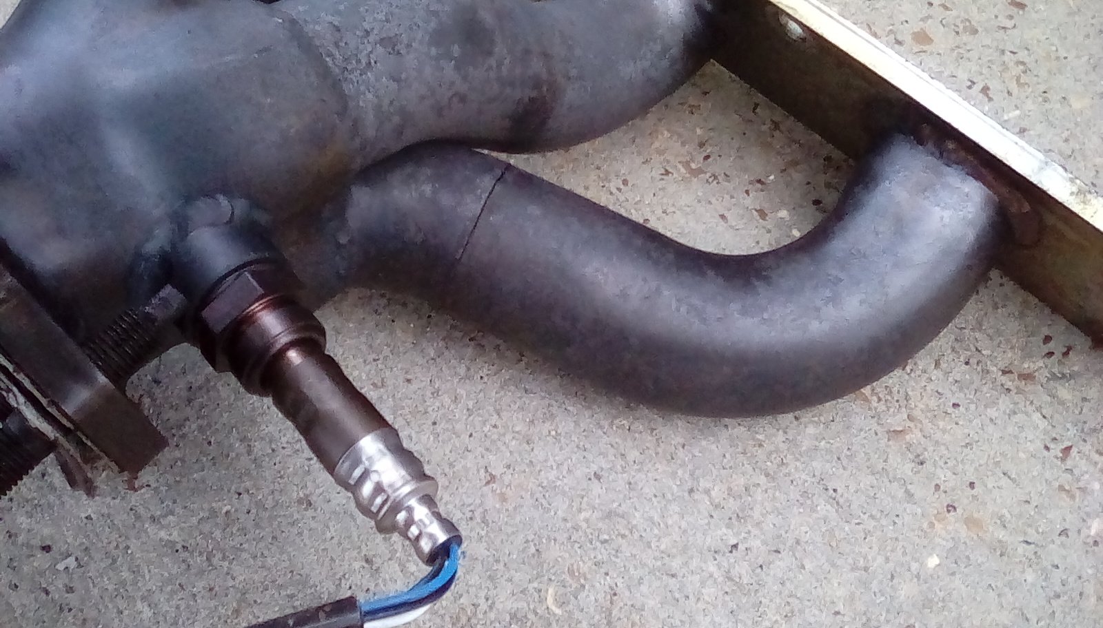

looks like it might be a badmab header

Thats a badmab header. fairly common for them to crack sadly.

Thanks royce777 and Foximus for the info on the header. Do you know if getting it welded at a muffler shop will hold it back together or will it probably just crack again?

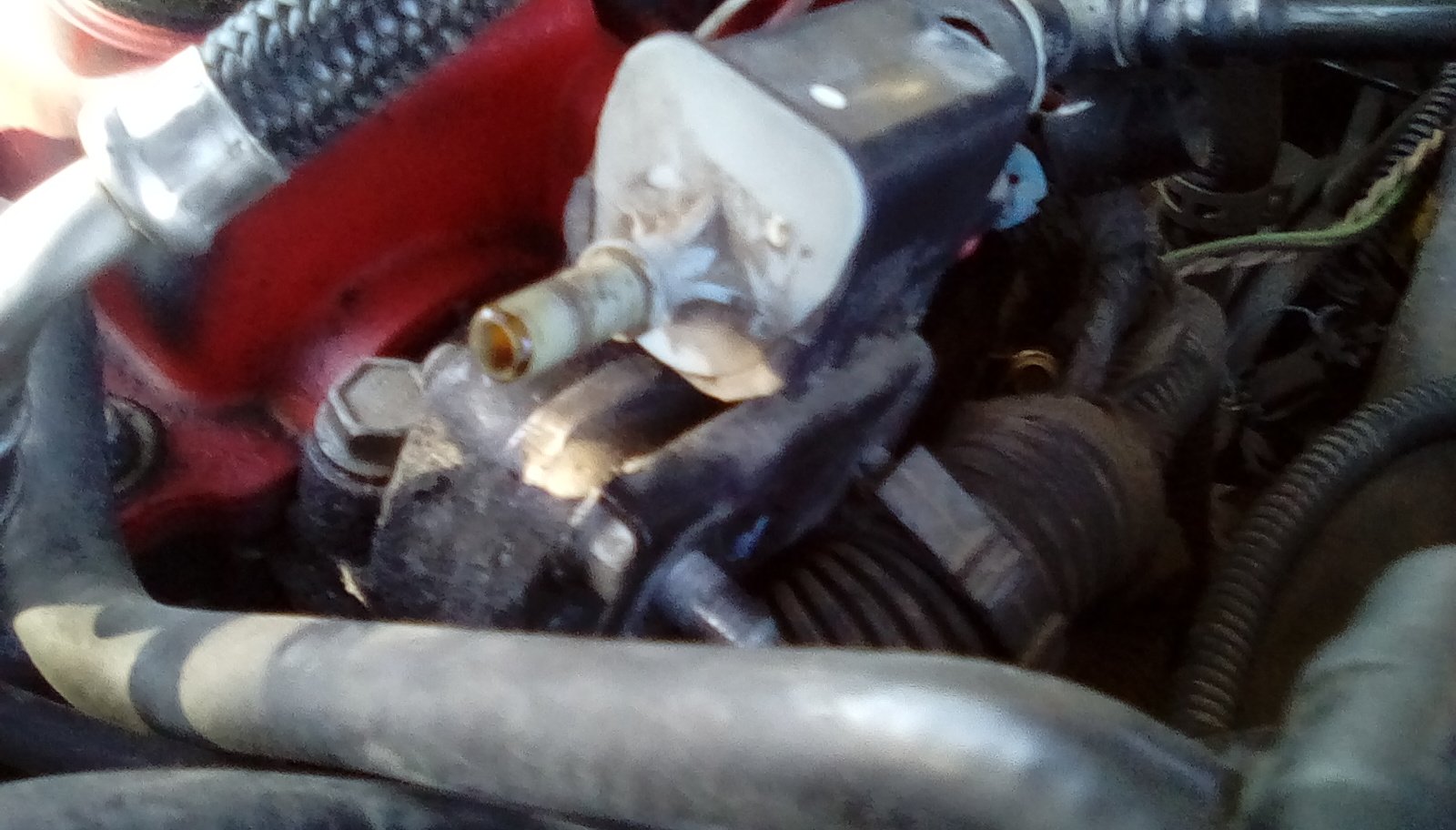

I tested it again just to be sure. The car does actually go into boost and makes around 5-6 psi.
Here's the another video. The first part is in gear second part is neutral with WOT.

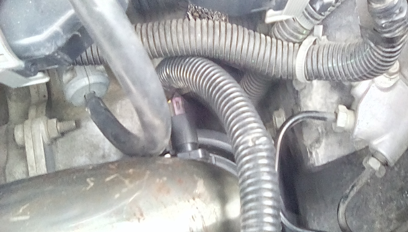

I took off the bypass solenoid and tested it and it itself functions properly. I am going to check voltage on the solenoid wiring and put the old ignition control module on the new ignition coil housing to see if it changes tomorrow hopefully. The car actually hasn't thrown any codes since I changed the ignition coil housing I forget to mention this in the first post that the car also has terrible mpg. Had some code for cat converter, but I have no info on it anymore. It was getting anywhere from 5-10 mpg even without boost. I am thinking I should rule out spark plugs just to be sure. What plugs do you recommend for my current setup?
Attached Thumbnails jyhtch6s3mbzojyllfhoostbnurriprcjp6vjstpkwkpx92ib.jpg   yt7jpkskt0aj3gam3whcd78tqbgn6d7c_z1a8fxsqpipx92ib.jpg

In your pictures that is not the bypass solenoid. Pretty sure that is your Evap purge valve. 2.2 setups with superchargers don't use a bypass solenoid but they do use a bypass valve that is attached to the intake kneck of the supercharger. That is what you should check. The first part of your video made it look like it could almost be sticking open. But then your revs at the end looked normal so idk.
When you are cruising what is your boost gauge reading? If you are getting horrible mileage I would assume you are dumping too much fuel and need a tune adjustment. After you look at your bypass valve you really should get a wideband gauge so you can see where your fueling is at. Unfortunately you are an 06 so as far as I know Trifecta is your only option and they don't appear to be taking new customers for our year of Cobalt. You may be able to make a plea to them idk. Else all you can really do is revert to stock setup and stock tune or go crazy like Foximus and setup a standalone ECM.

The bypass valve opens and closes as it should. It also holds suction so it should be good to go. I checked voltage and that is fine. As for boost readings while driving, I haven't taken it out in probably a month and a half, so I don't know.

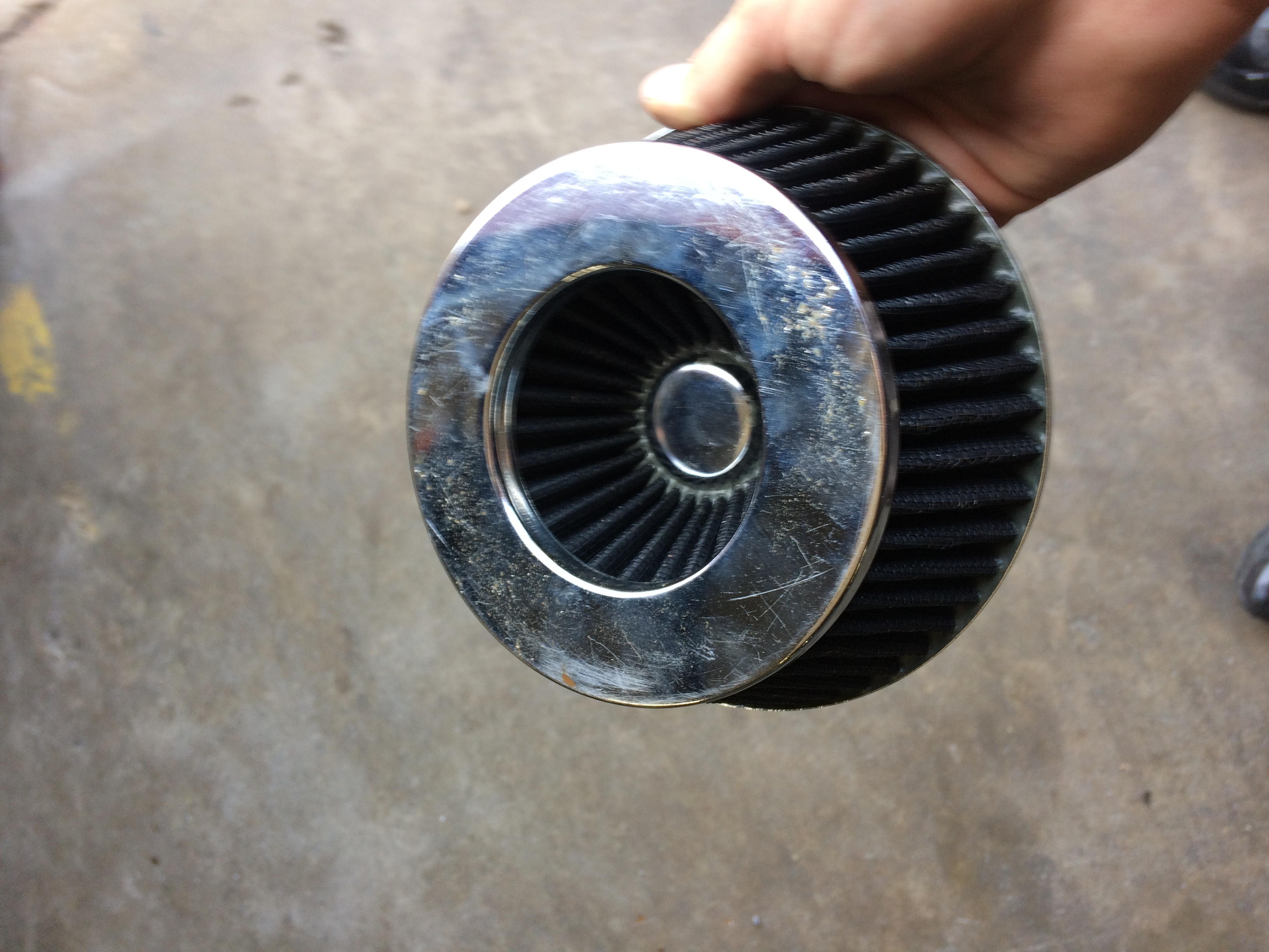

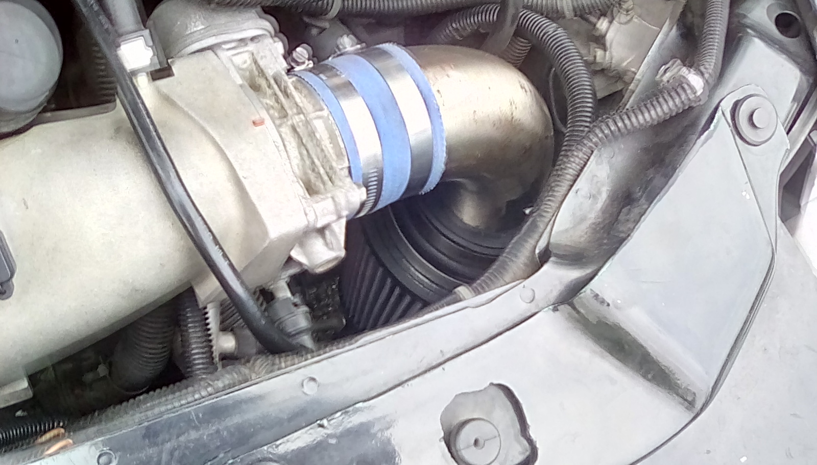

I cleaned the air filter, but that didn't work. I found a box in the car for a RU-5147, so I bought that and it works great until about 80-100% throttle then the sputters like before. I have a video of it I'll post tonight when I get off work. Another thing I found out is that the TMAP is not one from the LSJ manifold. I checked what its readings were on a tech-2 and it was reading around 60-65 kPa key on engine off, so I don't know whats up with that.
Old Apr 17, 2017 | 09:39 AM
jdbaugh1's Avatar
Joined: 02-03-16
Posts: 6,435
Likes: 358
From: Kansas

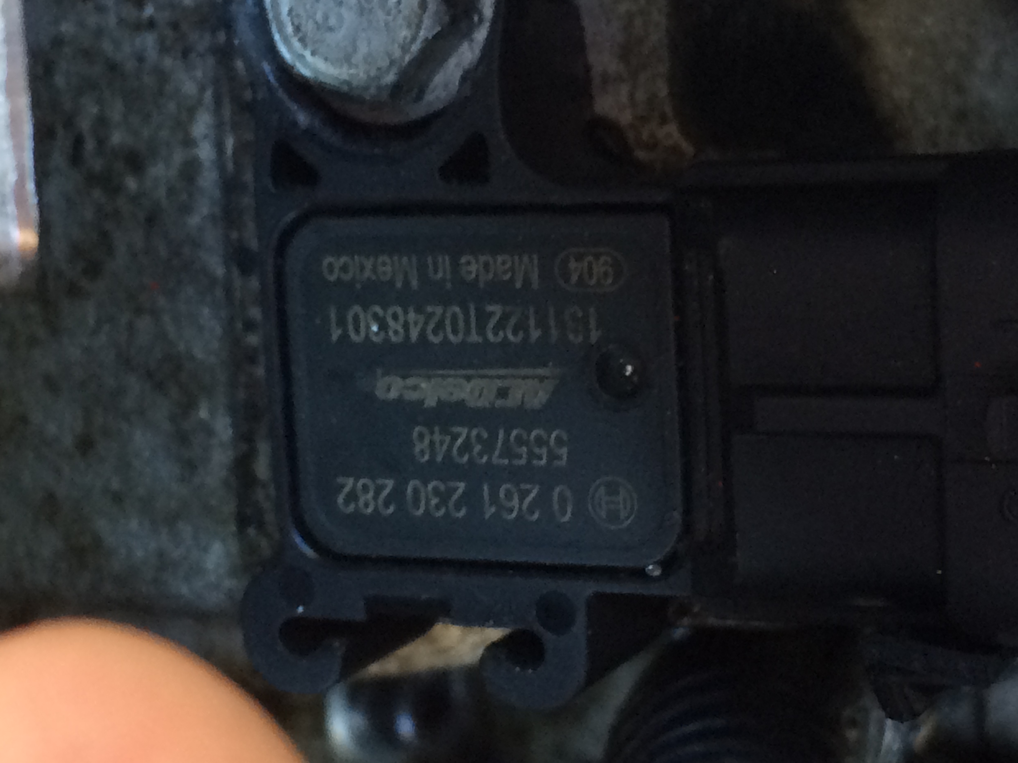

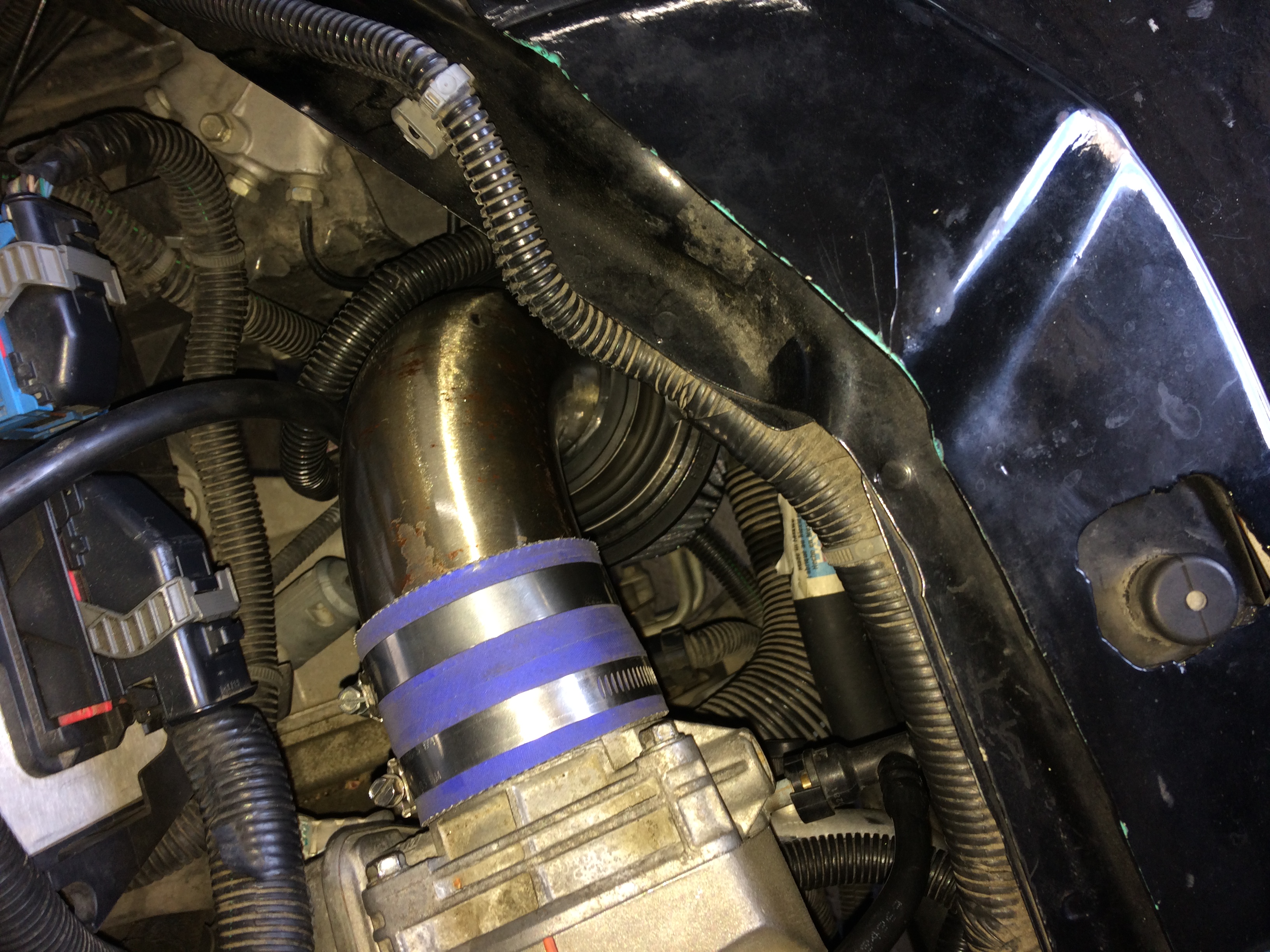

I was looking through your pictures of the intake and i don't see a MAF anywhere. Do you have one installed? If so where is it?
As far as the TMAP I am not sure which one is right for your tune. I am running stock MAP sensor tapped into a different spot on the IM. I am pretty sure my tune is mostly based off of the MAF though. One time I took the intake assembly off to clean my filter (my intake was configured close to what you have here) and I clocked it a little differently going back and it threw off fueling completely. It was running super lean and sputtering. That is why I am so curious about your MAF sensor.
Old Apr 17, 2017 | 03:07 PM
chevygirl2006's Avatar
Joined: 07-21-11
Posts: 10,937
Likes: 94

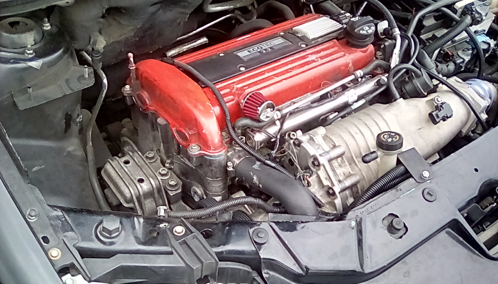

Where is your maf? Lol and post a picture of your engine bay. I want to check something.

MAF is there it is just on the back side of the filter. I've run the MAP unplugged and there is no change in performance if anything it is slightly better. When I had it on the scanner with the old filter at idle my a/f ratio was running perfect 14.7, but I wasn't allowed to give it a pull or rev it up while I was there. I have some MAF sensors that I picked up from the scrap yard that I could see if anything changes.
(video of engine bay)
Attached Thumbnails img_20170418_123123_hdr.jpg   img_20170418_123129_hdr.jpg   img_20170418_123136_hdr.jpg   img_20170418_123151_hdr.jpg
Old Apr 18, 2017 | 05:33 PM
Joined: 07-21-11
Posts: 10,937
Likes: 94
That intake needs to be replaced. Cheap intakes like that make our cars run bad sometimes. Maf sensors are sensitive. They require to be a certain distance from the filter and throttle body. My friends car would sputter like yours after she bought a no name. Put stock back on and it was fine. What are your plugs gapped at?

Like Chevy girl said the location and orientation of your MAF filter can really throw things off. It is even more likely with the MAF so close to the filter. Just changing your style of filter could throw it off. I know you probably don't want to do it but that thing needs a wideband gauge and you need to get your tune adjusted. That intake you have could probably work if the MAF settings were calibrated for it. Your spark plugs aren't quite right but until your fueling is corrected those aren't your problem. It won't matter how many parts you throw at it if your fueling is off because your ECU tune isn't dialed in.
