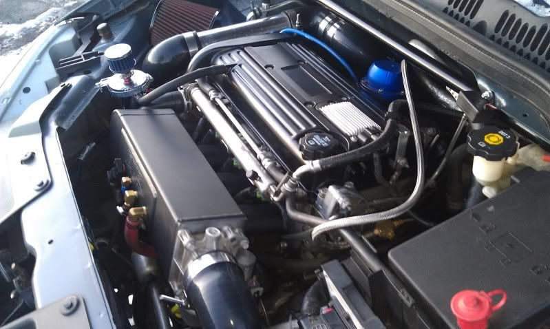

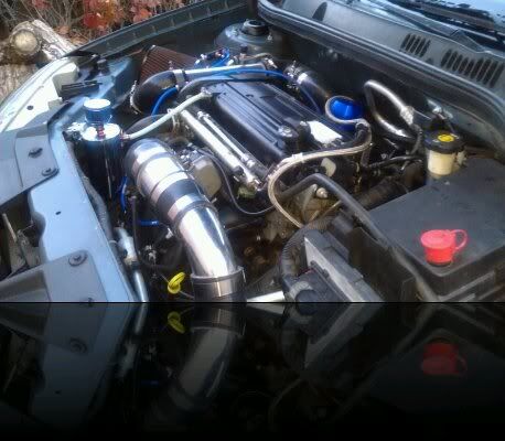

clean engine bay
misc wire tuck, turbo tech racing intake manifold
before new struts rims and strut tower bar
and before ttr manifold and misc wire tuck
and after

no before pics?

ya
thanks just got the manifold on today in the snow lol it has way better throttle responce and in boost feels amazing ha ha

Originally Posted by royce777
whats the specs on setup?
Its a cutsom turbo kit, im running a vulcan log style turbo manifold, a 50mm t3/t4 turbo, 39# injectors, trifecta tune, open downpipe, turbo tech racing intake manifold, custom universal piping kit, t bolt clamps, hks wastegate and bov, 8-10 psi boost
im thinking i made close to 300whp before the intake manifold so idk now

hey man engine bay looks good. i see that u tucked some of the wires going across the main fram support rail. what else did u tuck?
also did u disconnect that air bag sensor in the crash bar? i was scared too lol
Old Dec 6, 2011 | 10:17 PM
killswitch1209's Avatar
Joined: 01-19-10
Posts: 246
From: santa fe
ya i tucked those and put the injectors through the runners on the manifold and the main wire thats runs along the ac line tucked it under and the ones that go to the fuse box i still need to tuck some more but it looks good right i just put the other wire as far down under that i could with the slack it has!!!! ?? ooo and i removed the evap solidoid it takes up a lot of space on the right side of the cylinder head
