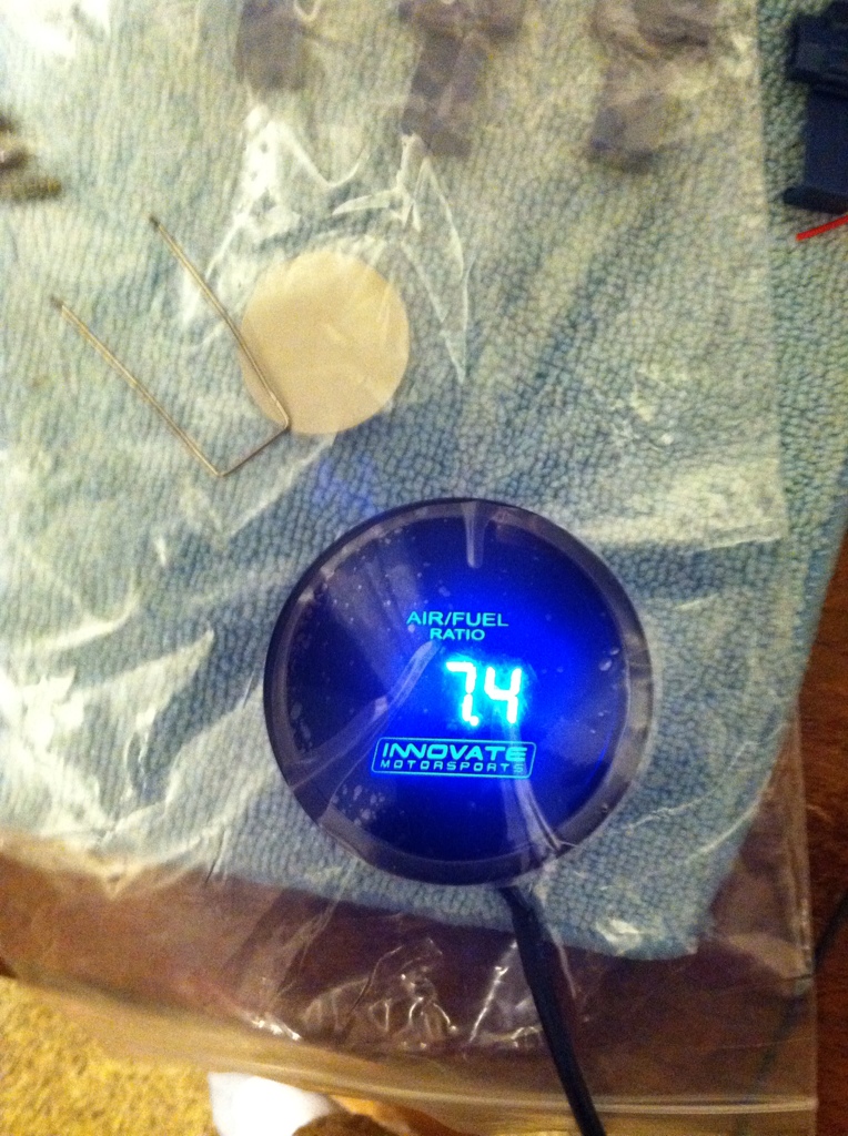

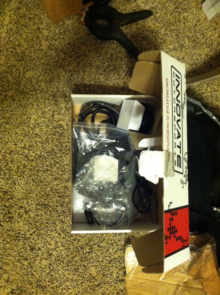

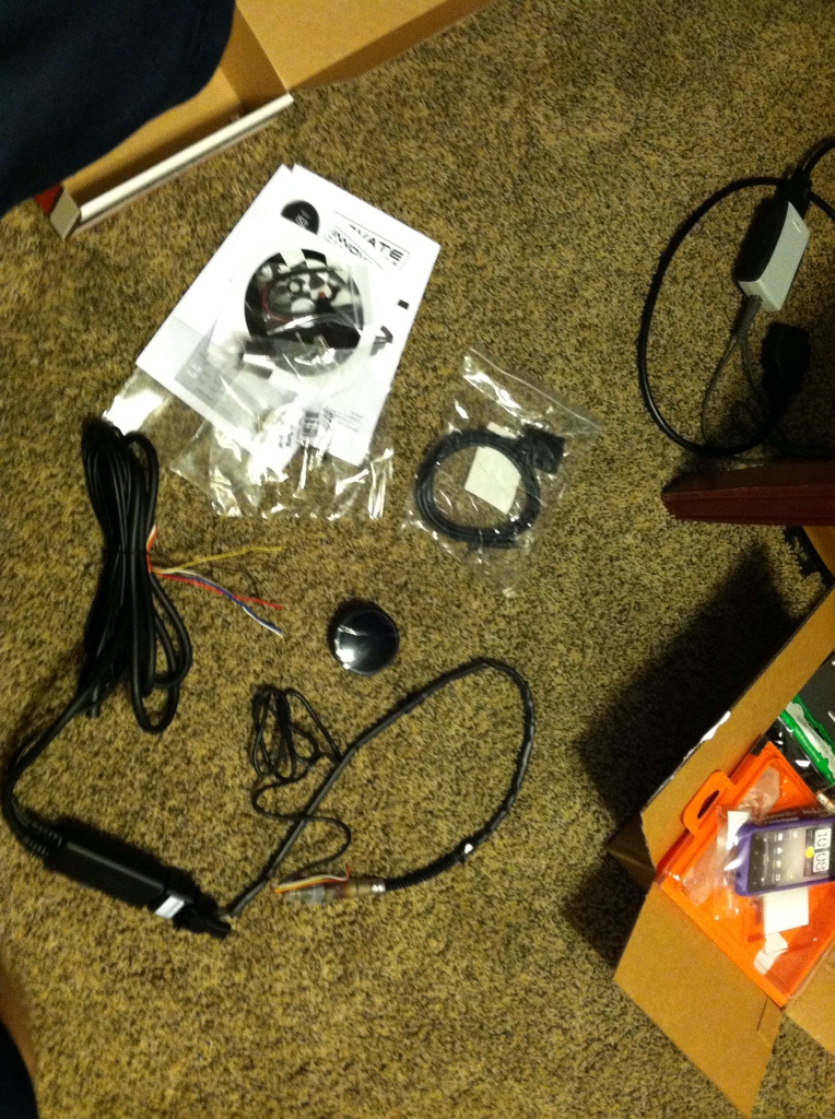

Update: gauge pod & innovate wideband came. I've been going back and fourth on my setup still not sure.
option 1: wideband, boost, oil, interceptor
option 2: wideband, boost, interceptor
anywho.. down pipe and adapter get ordered tommrrow and gauge gets put in. looks confusing on wiring lol. also found out ill be using a garage without a lift due to new owners taking over at work. so fingures crossed everything goes good. wastegate should be here tuesday. also stuck on what i should do there. pipe comes with a flange current pipe ill have toi cut off.. i have a flange i can weld. thought about a band clamp lol opinions?

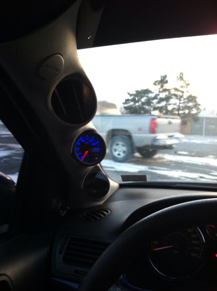

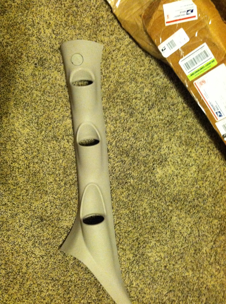

gauges are in. wastegate be here Monday and down pipe Tuesday. just waiting on the adapter... hoping this wont take long with a lift and air tools...

Do you have a gauge in the top hole? Doesn't look like it unless its tinted as well.
Old Feb 3, 2013 | 07:17 PM
  #54
klutch814's Avatar
Joined: 03-06-11
Posts: 3,023
From: philipsburg, PA
nope its empty.. future interceptor spot lol

Figured so. Looks better than that other pillar.. Hideous lol

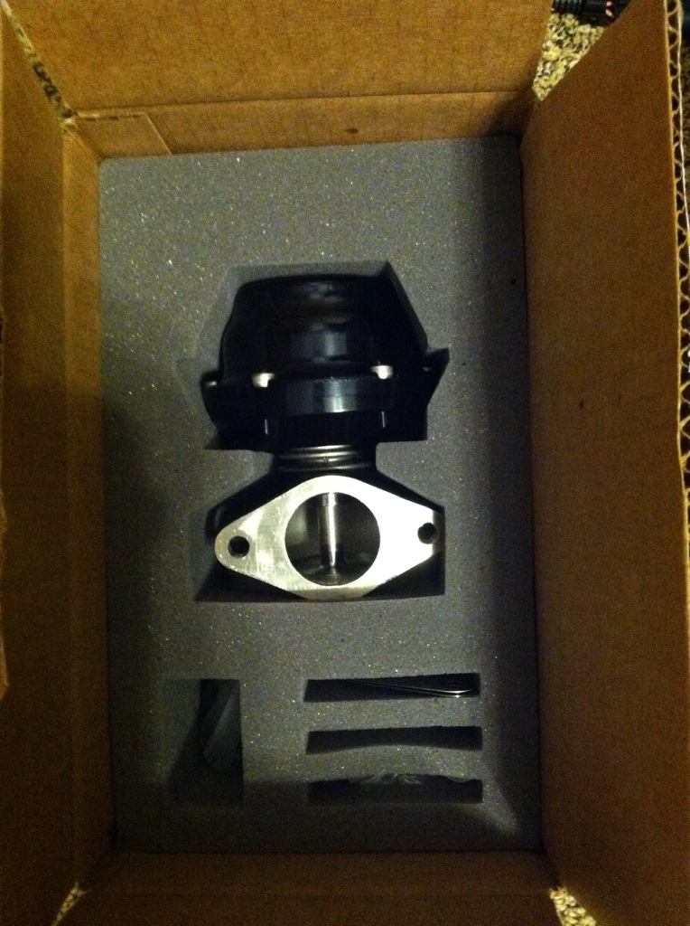

wastegate came today. tried to mount it to see about my screamer pipe.. wont know 100% untill everything is swapped. emailed zzp about theres..and about a furture sabb intake manifold.

Triple pillar...? ricerrrrr! haha just kidding I have 5 gauges

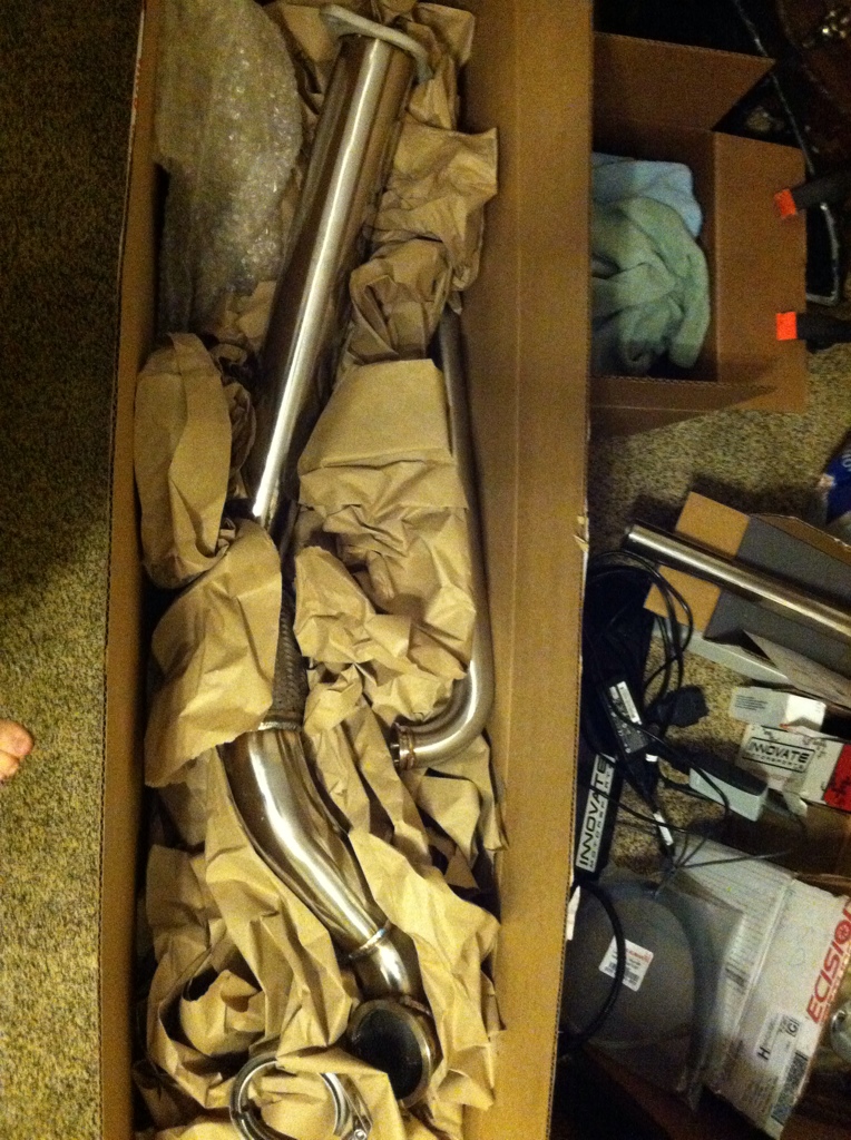

haha i used to have the glowshift triple. this is wayyyy better imo

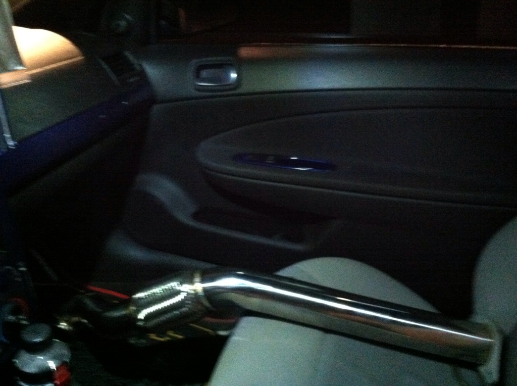

recived my zzp down pipe today and talked to matt from there all day. i love them right now. company7 i ordered my 5 bolt to vband adapter hasnt answered any phone calls. make made the adapter and got me a correct dump tube and shipped. also down pipe i chose the wide band option theres only 2 bungs is that correct? they sent me a vband dump tube with it i had no idea about. i have no use lol

Mmm cat less. I'll do that too some day.

the only way i know lol.. **** cats..hahah

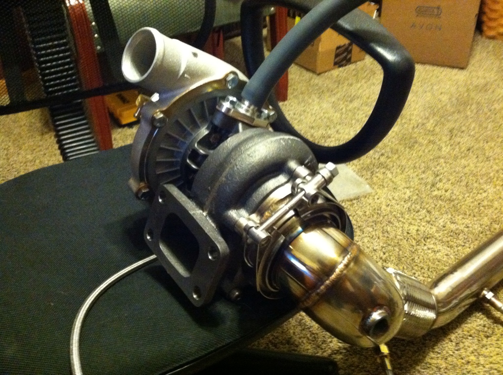

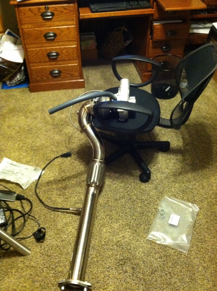

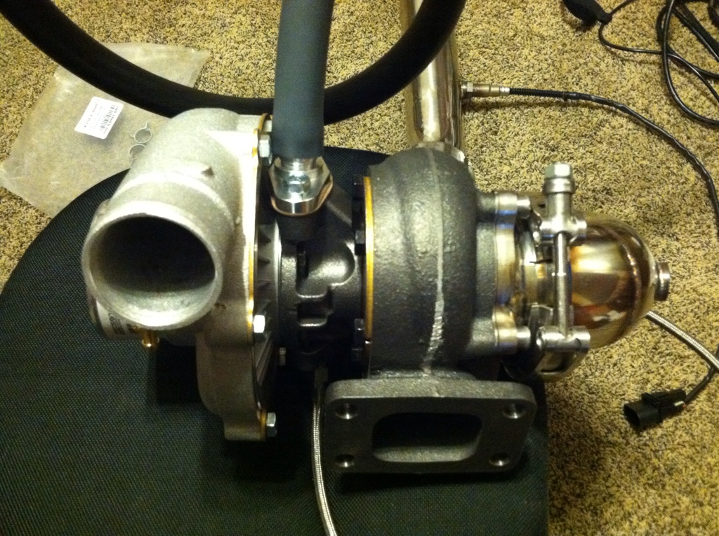

UPDATE: all parts are here!! woohoo. getting really pumped. although as you can see in the pics i have to re clock the turbo lol. gonna run to parts store tommrrow and get a long hose for return incase this isnt long enough.

To answer your question for the downpipe, no. you do need a THIRD bung for the wideband. You have 2 o2 sensors for the car and 1 (wideband) for your gauge, so you need 3 bungs. ZZP did the same thing to me and forgot to weld it in so i had another shop do it
Old Feb 8, 2013 | 10:02 AM
  #74
kxrida2000's Avatar
iTrader: (12)
Joined: 09-14-09
Posts: 4,113
From: Pittsburgh
A tuner can delete your rear o2. I only had 2 bungs in mine
Old Feb 8, 2013 | 02:28 PM
  #75
PsychoCam's Avatar
iTrader: (29)
Joined: 01-14-08
Posts: 1,839
From: Pittsburgh
Use the first bung for 1st O2 sensor. Second bung for wideband. Delete 2nd O2 sensor with hpt or trifecta. I only have 2 bungs. Got rid of my sec O2 sensor
Edit the second bung hole is too far away to use as wideband. U could use that as ur first O2. But u would have to extend the harness.
