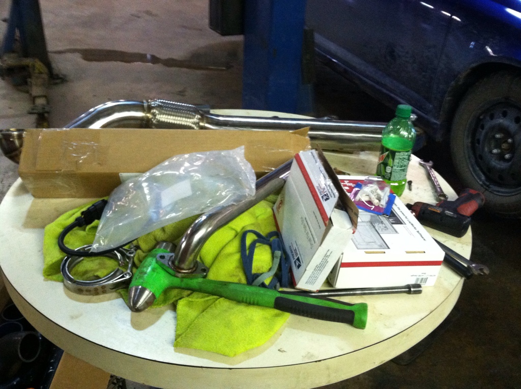

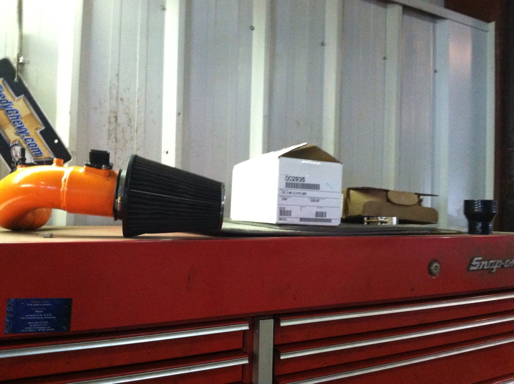

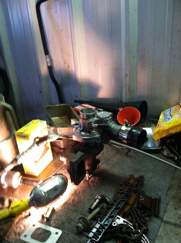

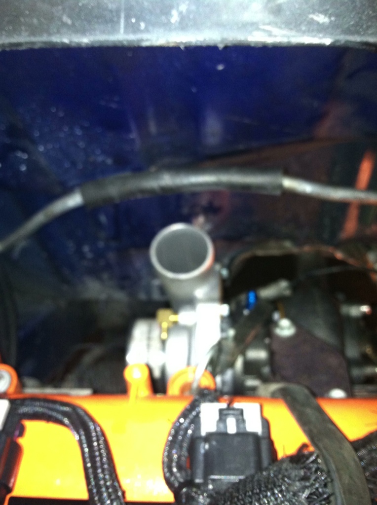

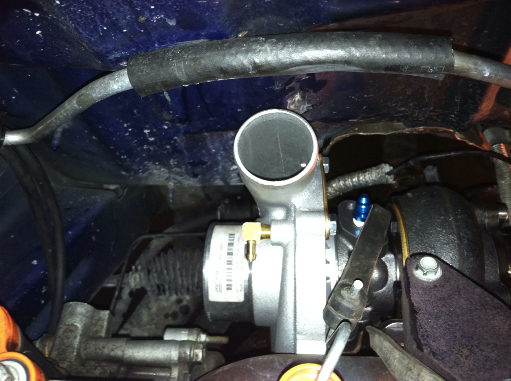

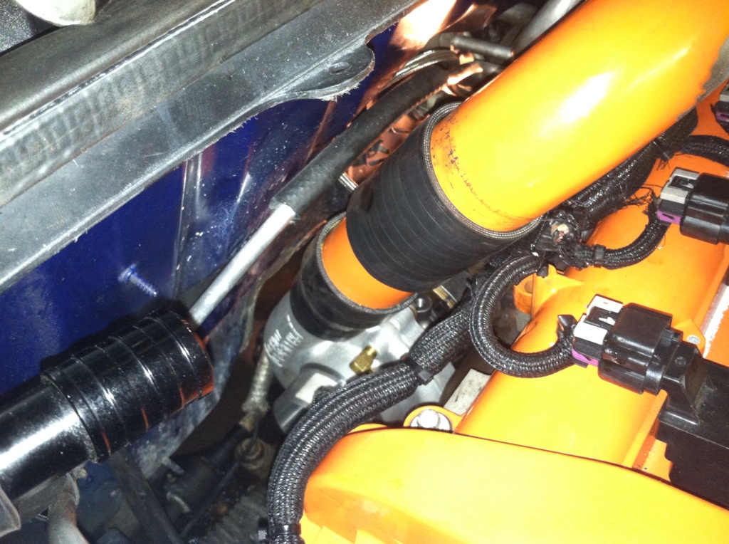

so i did my build today. took an hour to fight with the k04 getting it out. got the new one up and in and clocked. ran into a few issues though. 1. my upper charge pipe was wayyy off luckily i had spare pipes and clamps so i made an extention for now. 2. its open down pipe atm due to me marking where a flange needed welded wrong. (loud as ****) 3. since i used a 3 inch vband to 5 bolt it extended my down pipe off the to the side just enough to where my dump tube shoulda mounted (do not go 2 bolt wastegate!!) so therefor no dump tube atm. 4. i am retarded and ordered the wrong coupler for my intake luckily advance had one so that got squared away. 5. wide band isnt reading it flashes 7.4? i followed the instructions ( innovate lc1). Tommrrows plans are to get my wideband functional and make sure my vacumm lines are all good as i got in a rush at the end because i had work. Monday its going to a shop to get the exauhst and dump tube on. some data logs here and there and hopefully ill be ready for a 3 hour drive to a meet on saturday.

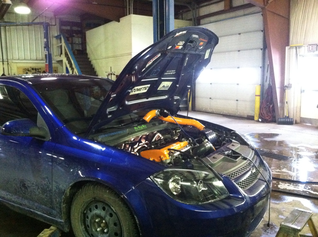

was mid way through flashing a tune and a error popped up saying "terminated" and i tried writing entire that says "timed out". i checked all fuses and got a scan tool from work and it has no communication for my PCM. At this point ill suck it up and let the electronics guy at work deal with it, flash a tune and be on my way to fixing the exhaust and dump tube. They are gonna try and get it in today as its my only car.
