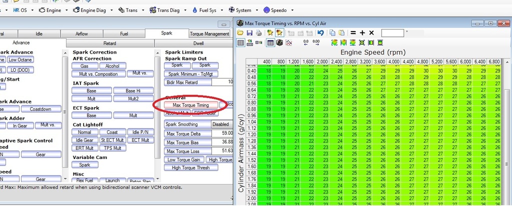

" There is a table in your tune which gives you the calculated maximum brake torque timing"
Could you explain this, maybe post a picture?
My buddys eco cav would peak at around 23* on the stock tune and 87 with no kr but it was always below freezing outside.

Is that literally just a cheat sheet or is it a table that changes things?

Tune says it is not recommended to change that table. It is referenced when estimating delivered torque VS maximum torque. I used it as a cheat sheet.

Yeah i went into hptuners and poked around a bit and checked that out.
