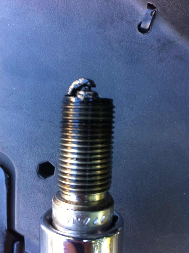

well yesterday i was driving home from a buddies place my car decides to start running on 3 cylinders.... im throwing the p0301 code and was having over 150 misfires per cycle... well i limped her home and let her sit for over night, this morning i fired her up again to see if it was still running like ****, and she still sounded like a suby. i checked the compression and spark plugs and found maybe 5psi in cylinder one and my spark plug was fucked

well here's the thing. if it happens once, it'll probably happen again. if you can't afford the rebuild, then i suggest putting in another engine, larger pulley and moderate timing. if you can afford the rebuild, i can make up a parts list for you, i just rebuilt mine over the past couple months..

also... downside to blowing your engine rather than building it up before it blows... could be more problems than just that spark plug blowing... i blew my engine before i rebuilt it and i screwed up a few things unfortunately

This is very funny lol not really but three weeks ago i had the same thing happen pulled the plug from the #1 cyl and found the same thing. The piston actually started to come apart and threw a piece of the ring up into the cyl which was bouncing off the plug. Pulled the plug and got the metal out and it actually ran ok. I am in the process of having the motor built bullet proof since this happen.

i probably should've told you to replace the plug at first just because this actually happened to me too...wasn't really thinking. when i blew my motor, 3 of my pistons had chunks taken out of the top haha

i changed the plug and still sounded like a harley. stuck a magnet down in the cyl pulled out metal like a cotter pin. put a new plug in ran like a dream, honest to god lost no power at all and come to find out when we tore the engine apart that i was missing a 1/4 of the top of the piston

you are going to have to see what all damage you have. if it fucked the head up and stuff you are **** out of luck for a quick cheap fix
truth... this happened to me haha. ended up throwing 1200 bucks just into the head ><
