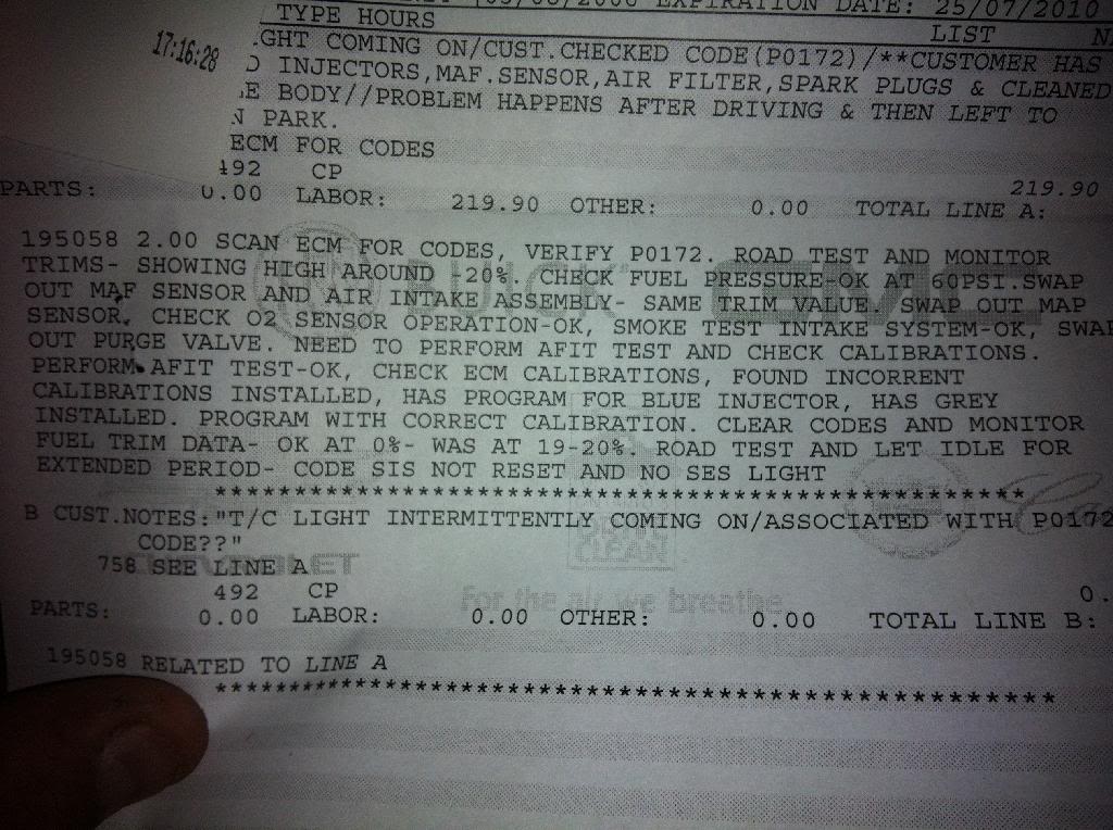

Brought the car to gm, was told that the ECM needed reprogramming so fingers crossed Shea good to go
Old Jan 24, 2014 | 10:47 AM
  #32
Powell Race Parts's Avatar
Joined: 04-25-11
Posts: 6,128
Likes: 47
From: Port Perry
? wrong injectors for calibration in a stock car and has worked for years and now doesnt? weird. x files stuff
