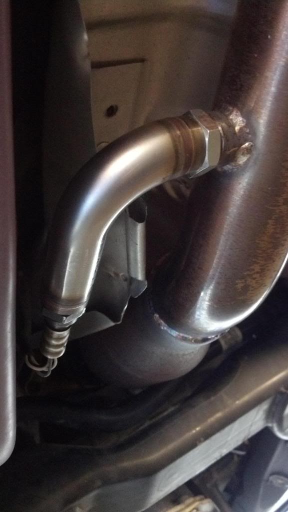

That's my defouler in the pic... Idk why I thought it was the intake when my app told me O2 sensor...
