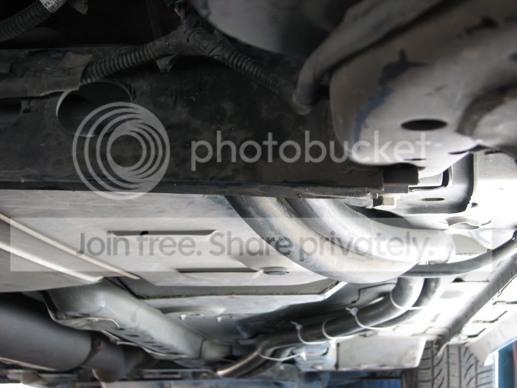

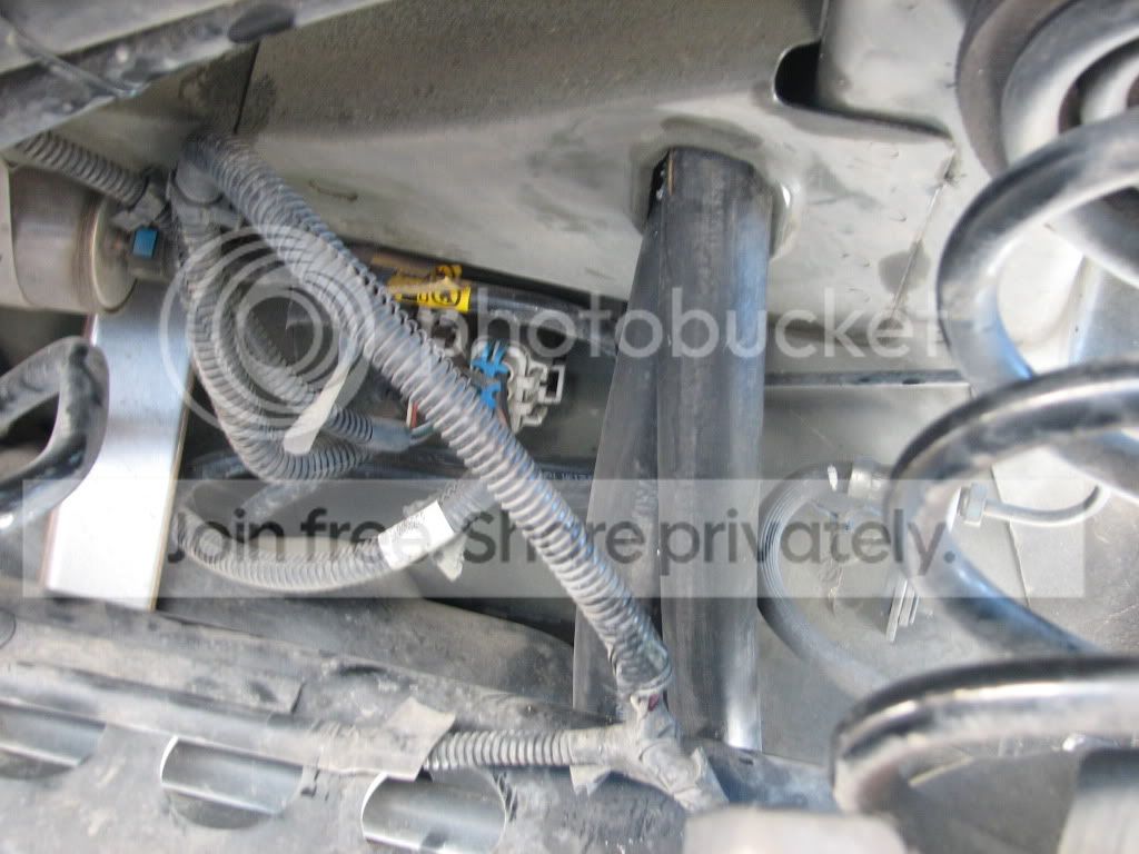

Hoses connecting the tank with the IC system are run underneath the car along the subframe.

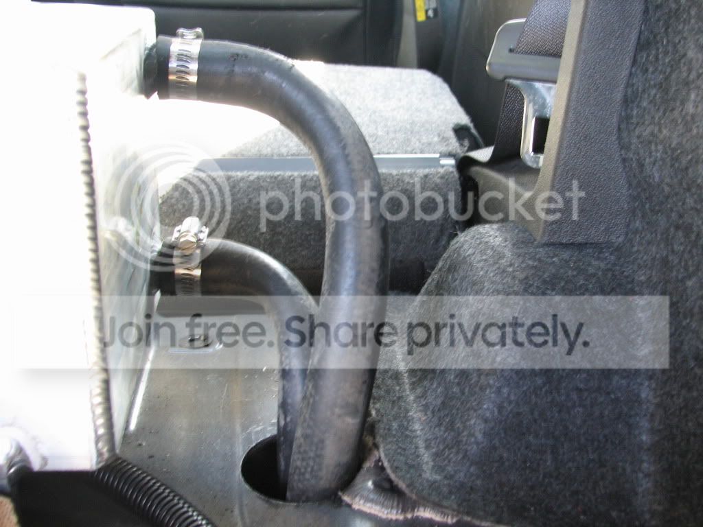

just curious where and how you were able to rote all lines to the trunk, the hole in the firewall seems like it would be too small for two 3/4 hoses.
Old Nov 17, 2009 | 05:39 PM
Steven Flit's Avatar
Joined: 06-04-07
Posts: 2,530
From: Los Angeles, CA
it isn't routed thru the car
it's routed over the passenger side steering rack, and along the subframe. A 3-4" inconspicuous hole is drilled in the trunk for the hoses to be routed in.
