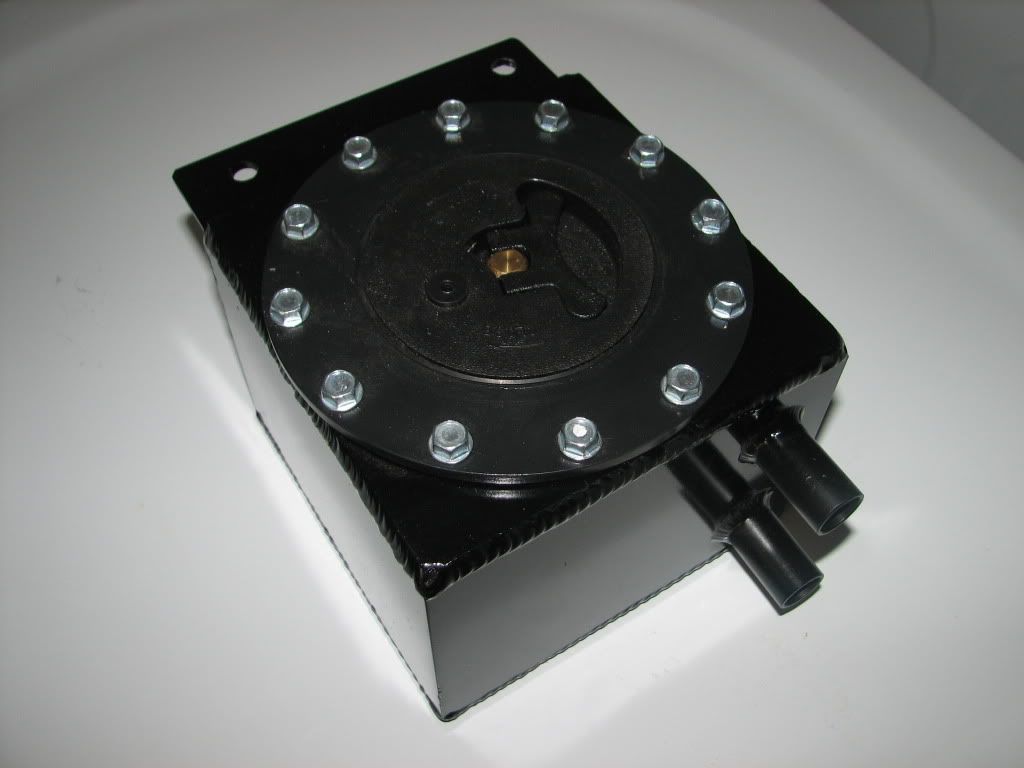

Something like this? lol
Old Nov 19, 2009 | 03:38 PM
  #47
Steven Flit's Avatar
Joined: 06-04-07
Posts: 2,530
From: Los Angeles, CA
Originally Posted by phatnackySS
4 gallons dose seem like a bit much, i was looking for something that would fit on the passenger side under the hood that has a big race style cap so that i could pack it with ice in between runs at the track.
Something like this? This was Euthanasia's first attempt @ a flow thru tank. No the 1900 isnt for sale lol
Last edited by Steven Flit; Nov 19, 2009 at 03:38 PM. Reason: Automerged Doublepost
yes in deed , ib been serching but i can only find tanks for mustangs.
only thing i would add would be a valve at the bottom so it can be drained so that more ice can be added as it melts,
