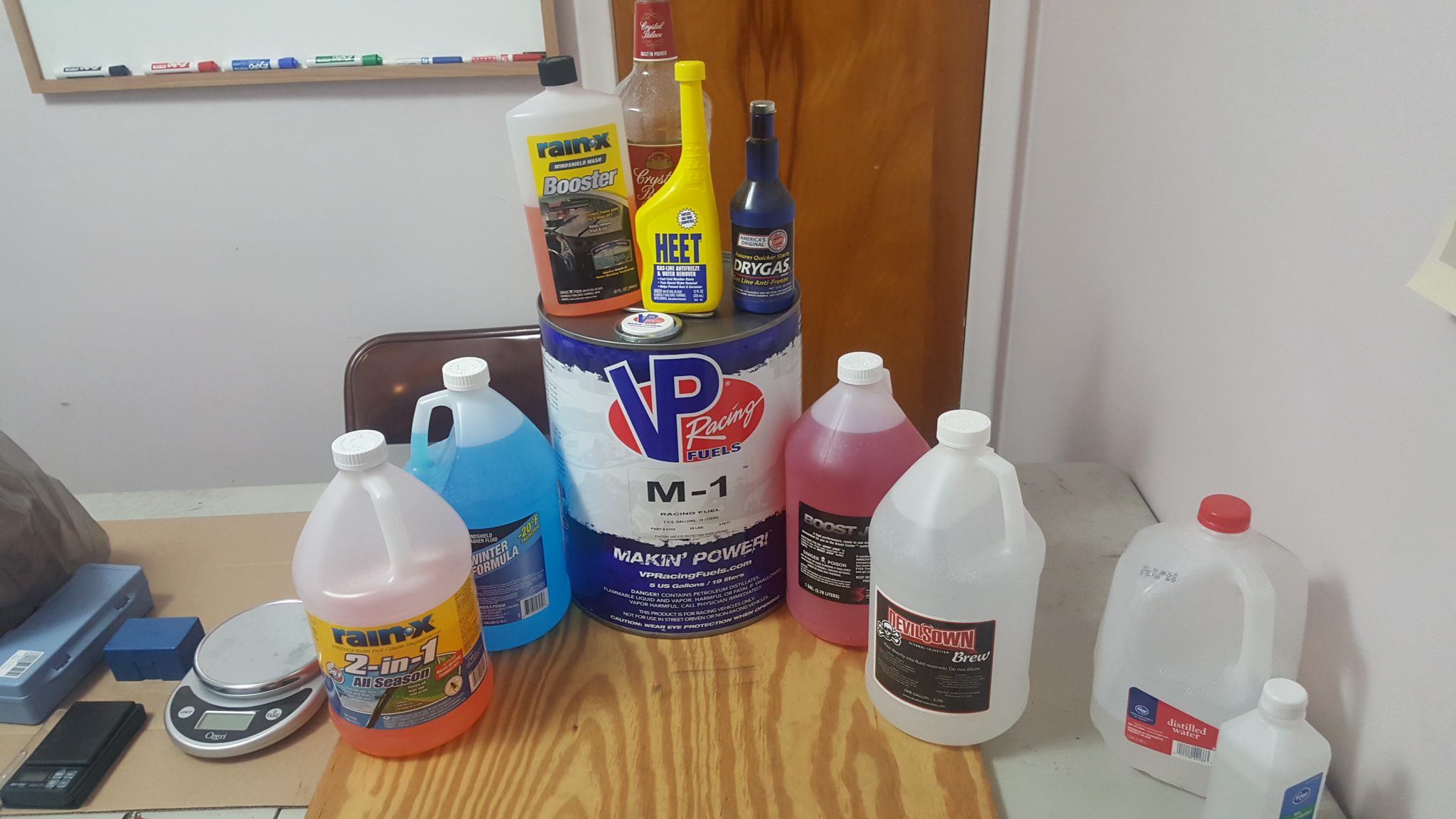

FYI, Livernois Motorsports stocks VP Racing Methanol 5-gal jugs. I'll pick some up to be sure I am using pure methanol as a confident baseline. I also picked up a hydrometer, 0.700 - 1.000 specific gravity, where 1.000 is water and methanol is about 0.792, @ 20C.
I got the hydrometer because I did a quick test last night with the refractometer. 40% Vodka reads exactly 40% alcohol on this meter, but Boost Juice reads "18% alcohol", however that is impossible because I lit a sample of Boost Juice on fire again last night (remember, Devilsown had failed this acid test). Also, the refractive indices are different between ethanol and methanol, so I confirmed reality here. However, since I am going to get pure meth I can rescale the hydrometer manually by testing known ratios of methanol in distilled water.
My little experiment will now have 3.5 testing methods. Mass/Volume, Specific Gravity, Refractive Index, and the 0.5 test is just setting it on fire, but that is a go no-go type of test for higher concentrations of methanol. I could put it in a box, then measure temperature rise to measure energy output and back estimate the amount of methanol the burned off. Haha, no.

Setting the Stage:
Still waiting on the hydrometer in the mail.
I may as well record the test plan somewhere, I am trying to balance efficiency with effectiveness here in a diy context:
1) Calculate density based on mass/volume (gram scale + graduated cylinder)
2) Hydrometer test to measure specific gravity
3) Characterization of meth/water ratio vs. refractometer reading (to rescale because refractometer is for Ethanol)
4) Refractometer test [using the new scale for methanol]
5) Acid test: is it flammable?
6) Acid test: test tube all specimens, place in freezer for X hrs, see what happens
I'd also like to concoct the Blue Washer Fluid + Heet and see what we get (notable internet suggested formula). I was just at walmart last night and browsed by, you can acquire this combo for about $4.
