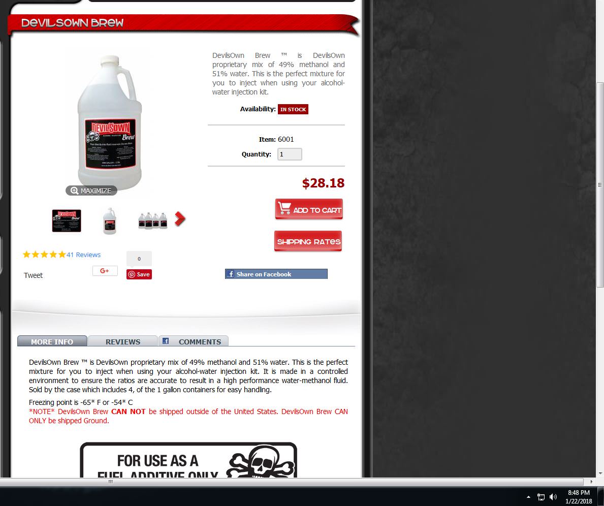

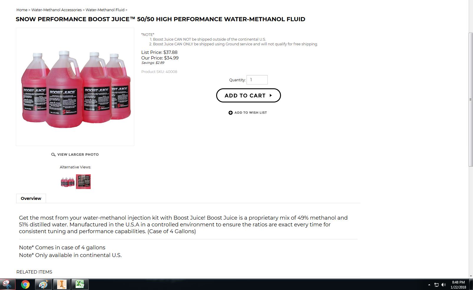

"...proprietary mix of 49% methanol and 51% distilled water"
Snow Performance as of 2018-Jan-22:
Devilsown as of 2018-Jan-22:

Let spin this around, how can the vendor let this happen when testing methanol content is so easy? I am not sure how they mix the solution, but if they are doing it in large batches (275 gal tote) then they are in the best position to monitor quality.
It is mind blowing, both companies failed. I totally expected Boost Juice to be the hero.
I cant speak for small companies like Devilsown and Snow Performance, but for sure at the many gigantic companies I've worked at, it comes down to lack of accountability and the "not my problem" mentality.
