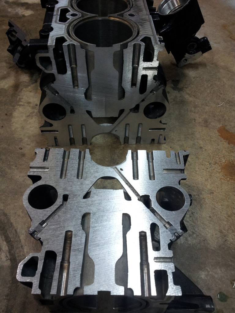

Old Mar 5, 2013 | 08:06 PM
Tjolley's Avatar
Joined: 02-01-11
Posts: 2,799
From: modesto
This is whaT I mean by when I say I cuT up a spare block
Old Mar 5, 2013 | 08:14 PM
damastah's Avatar
Joined: 02-13-11
Posts: 8,047
From: Olney, MD
might be a dumb question... but what did you use to cut the engine block? the cut is sooo perfect..
was it like a giant industrial saw or something?
one of my friends does something like that for a living, but cuts metals 100times stronger, but he uses a laser.
