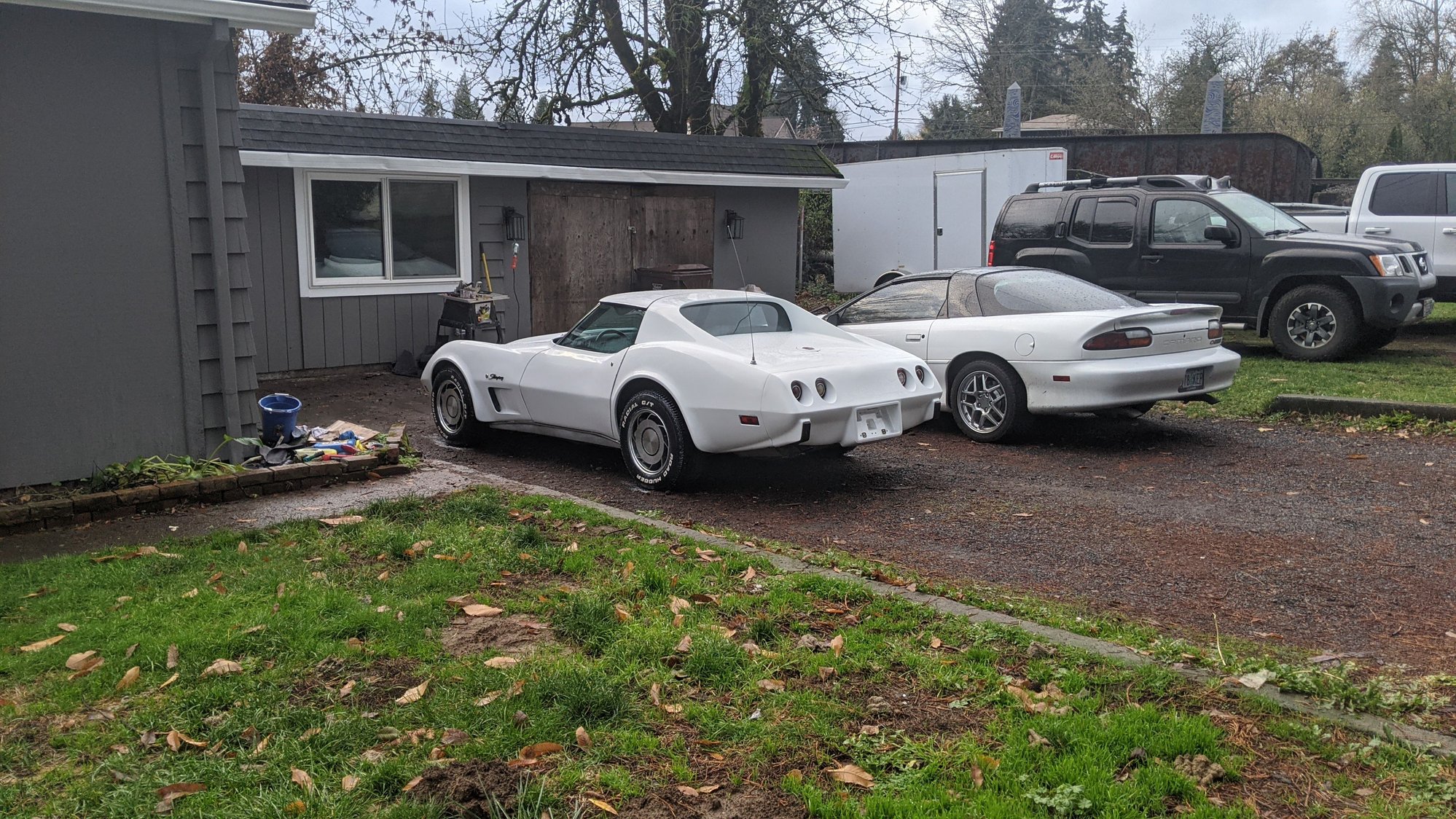

Old Nov 21, 2020 | 04:27 PM
  #44
Johnny Bliss's Avatar
Joined: 07-24-17
Posts: 662
Likes: 9
From: Oregon
This is 1000 wet sanded and some rubbing compound. I'm kinda annoyed at this clear I think the can is bad... It says 15mins to dry and 1hr to handle. It was sitting in garage all night with heater on and it wasn't dried all the way at through. When I wet sanded and buffed it rubbed off some of the clear that wasn't completely dry. Last time I did this on trans am it dried really fast....
The can also spit out some crud a couple times
It looks fine from 6+ feet but close you can see where it burned through clear
I'm going to wait a while and sand the clear off and use a new can. It's ok for now.
Old Nov 22, 2020 | 09:49 PM
  #45
Joined: 07-24-17
Posts: 662
Likes: 9
From: Oregon
I repainted and cleared the back and it looks pretty good now. I bought a new can of clear and it worked fine and dried fast.
The car had some wierd side mirror on it, I filled the holes and painted over it I will probably put the stock mirror on in the correct position at some point.
I fixed a spot on the front bumper and on the
back behind the window on passenger side.
Oh I also fixed a messed up spot on the headlight cover
I'm going to wait until tomorrow evening to wet sand and buff just to be safe on the clear

Polished once

Old Nov 29, 2020 | 11:52 AM
  #49
BlackielawlessSS's Avatar
Joined: 10-03-13
Posts: 18,401
Likes: 291
From: Haslet, TX
Looks good! Those wheels need to go! They look weird on that car.
