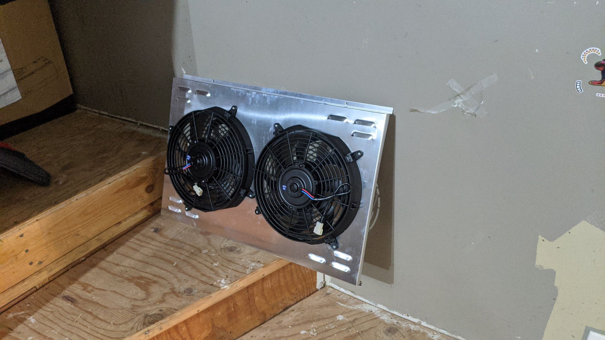

i installed election fans they work great, i just need a different relay the fans never go off because the "off" is 165f lol... all the kits had 185 on 165 off lol.
Maybe a resistor in the line from sender to trick relay

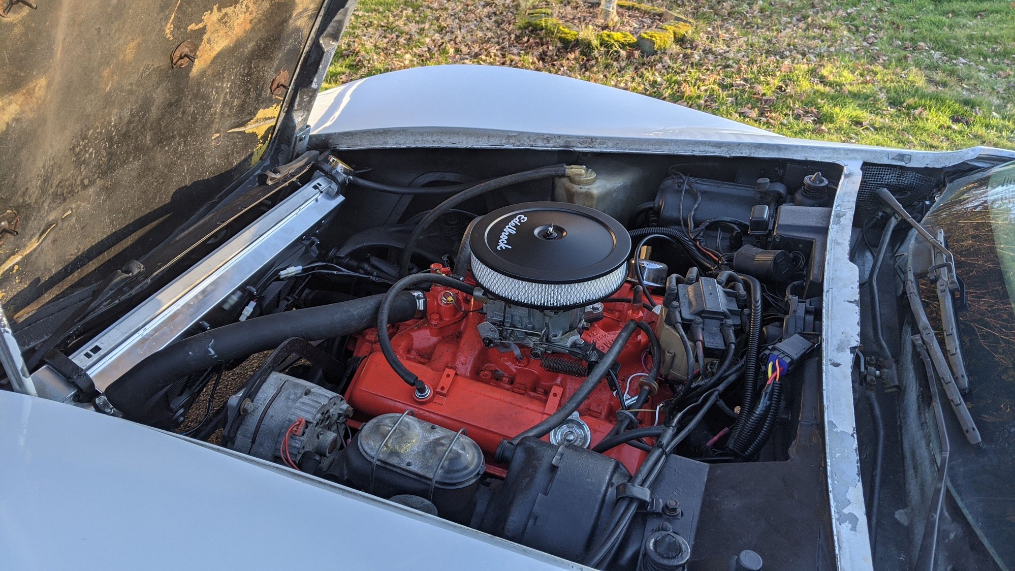

Wheels look fking sweet, had to grind a e brake bracket a tiny bit
Air cleaner and 210on 195off fan switch work great. Probably get the black same style valve covers sometime
