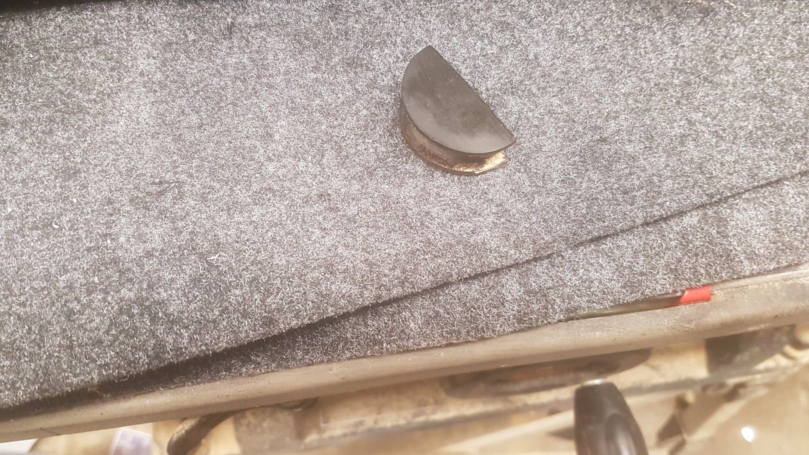

my friend that does powder coating had an lsj valve cover he coated for a guy years ago and never got picked up, so i grabbed that and made a couple mods. first off was adding a -12an fitting for my catch can, along with removing the nipple from the factory breather and plug the hole. also because the valve cover had previously been blasted and powder coated the baffles had been removed and were missing. i built a simple baffle around the -12 fitting, its far from the factory breather system thats in our valve covers, however running no pcv and a catch can im not really worried if its not the most effective baffle.
now for the interchange issue. the valve cover will physically bolt onto an l61 head without issues, all the bolt holes line up, the issue lies in the end of the valve cover. both cams on the lsj go through the end of the head, the exhaust cam has the bolt on cam sensor housing and the intake cam is blocked off. on the l61 head the exhaust cam is shorter and the head and valve cover go straight across. the end result is putting an lsj valve cover on the l61 leaves a semi circle hole open. the fix is a rubber half circle plug used on many different engines for this exact thing. the only info i could find about what to use was "something from a dsm". thats a little wide open, so i went to the local pick a part and scrounged around. when i think dsm i think early 90s 2.0 turbo, the plugs i found on them may have worked, but seemed quite small for the task. a later 420a engine had an aluminum plug un the head, however it was also too small. long story short i found a plug very close to what i needed in a 1985 hyundai pony, the rest of it will be made up with a bead of silicone.

yea it was a mitsu engine for sure, a 4g32 according to wikipedia. its 5 years too old to be considered part of diamond star motors (first dsm sold in 1990), but i would still call a hyundai pony a dsm, seems like it would **** the dsm guys off.
actually, it would be kinda fun to cram a 4g63 into a pony. wait, actually scratch that, it would always be broken, cause dsm
