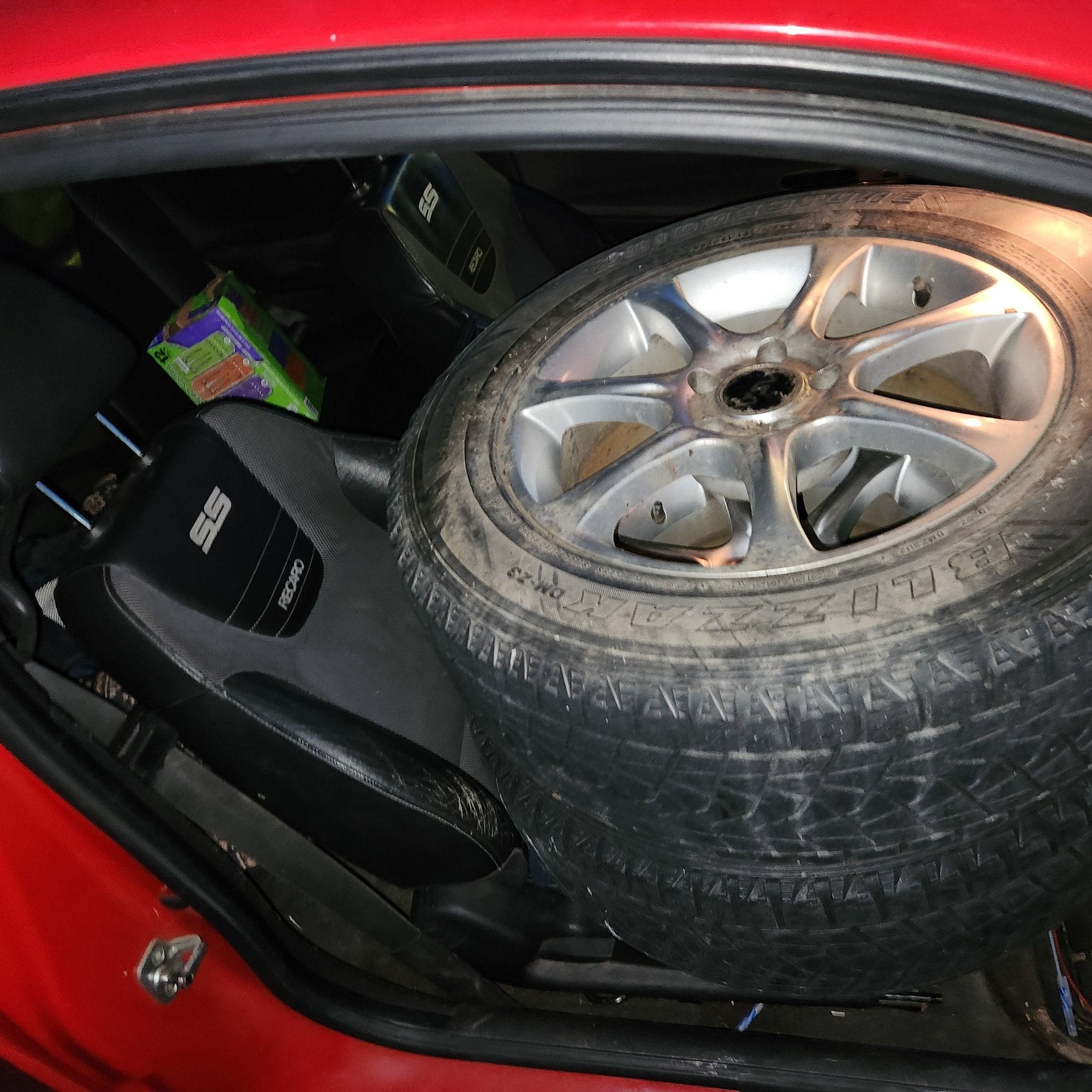

Swapped Recaro SS seats into 2007 cobalt coupe ss

Had nowhere else to fit the tires so had to put em on the recaros. I had 2 in truck too
