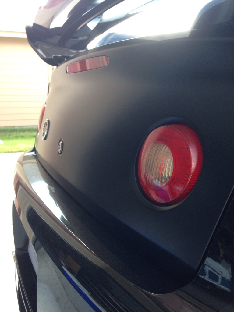

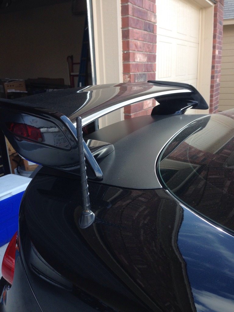

Lol but my "big gay wing's" deck lid is wrapped in a 3M Black satin latex wrap! Looks clean though!
I'm just going to save up and go Tjin lol
