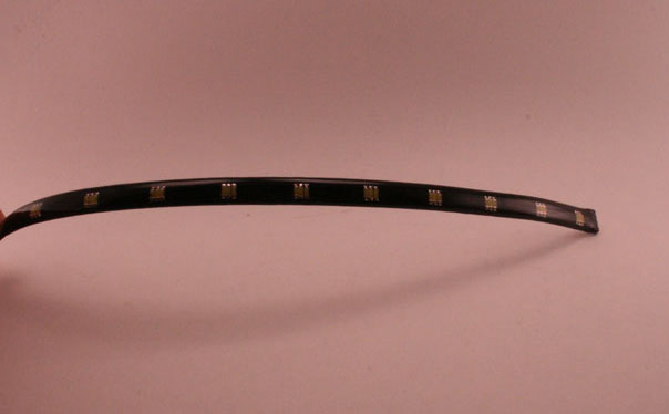

Yeah I'm having the same problem as those guys. ^^ There must be place to custom order this tape stuff to whatever size you need. Also possible is flat LED's with withsomething to diffuse the light, then the sill on top.

This is actually pretty easy to do. The hardest part is finding the right size EL tape, and cheap. I was looking at this project, and it was expensive for colors other than salmon.
You cut out plexiglass to size, put your EL tape underneath. Then you drill a hole under the door sill and run it horizontally inside the car. You can ground the wire wherever. You can make it turn on with your doors open by tapping into the dome light fuse with "add a circuit".
Mount/tape everything together and check out the results.

Yeah no one said it was hard. I haven't bothered looking but if I find the strips for it I'll buy the sills and do it.
And you need to splice either directly into the door triggers (which are negative and need to be switched to positive with a relay) or splice into the BCM wires for both power and ground.
