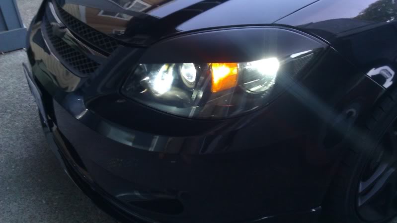

So I'm finally done with my retrofit. Let me know what you think... A few pics of the lights, progress, and light output below (sorry for the crappy phone camera quality):
lightly used OEM headlights off of 09 SS/TC from eBay
Morimoto Mini H1 projectors
E-55 shrouds
V-LEDs.com type 2 switchbacks
Autozone amber LED was used in the marker since V-LED 194 bulb wouldn't fit our socket

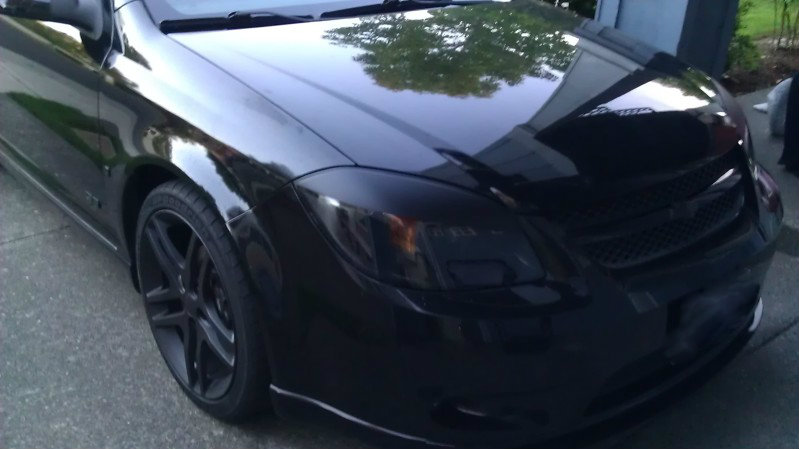

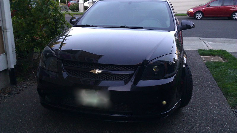

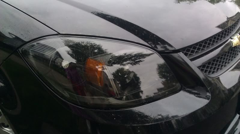

EDIT: Now with plasti dip eyelids. Light output is not affected:

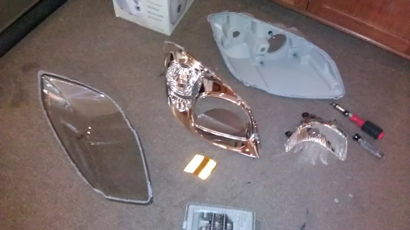

Baking them apart was probably the hardest part of the whole thing, since the OEM headlights suck to pull apart, but finally got it done:

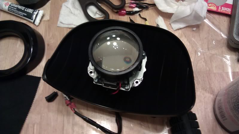

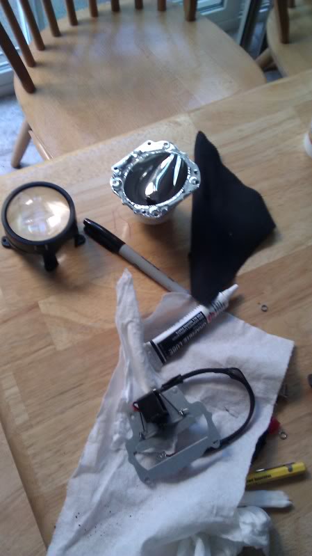

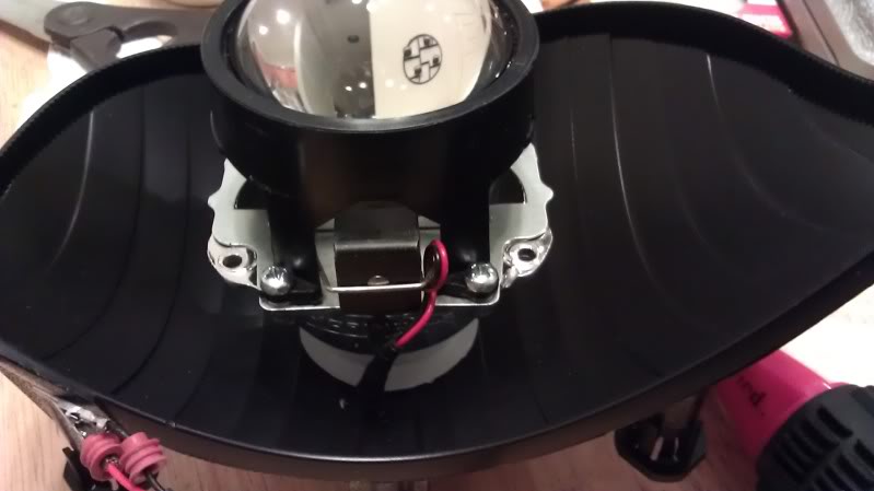

Took apart the projectors to clean it, they were previously installed in my Neon for a short time..

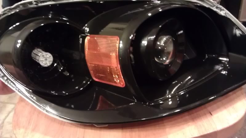

Painted the stock reflector flat black (trim black if I remember correctly) with adhesion promoter first of course
The rest of the reflector got painted the same color, but it also got the two-part 2K clear... Here's an approximate fit up with V-LED type 2 switchback:
I decided to keep the side markers orange (after long consideration to black them out with Rust-Oleum lens tint I have sitting in the garage) but decided to stay legal to save the trouble with Oregon and Washington cops... Plus I kinda like the look.

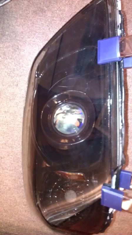

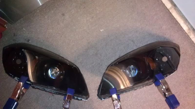

Finally baked them shut...

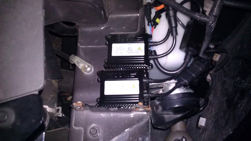

After reading a few suggestions on here, this is where I ended up mounting the ballasts for the fogs and projectors:

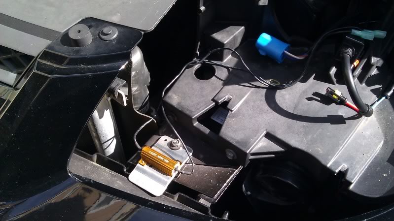

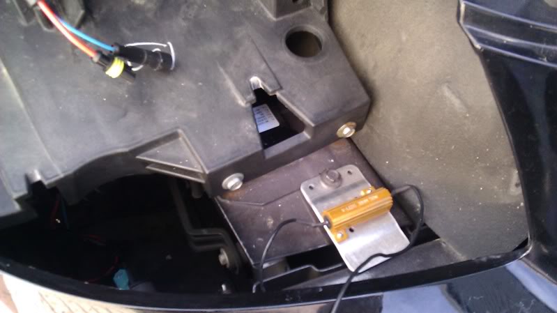

Also, I used the headlight front bracket bolts to install some resistors for the turn signals:

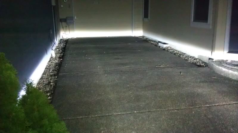

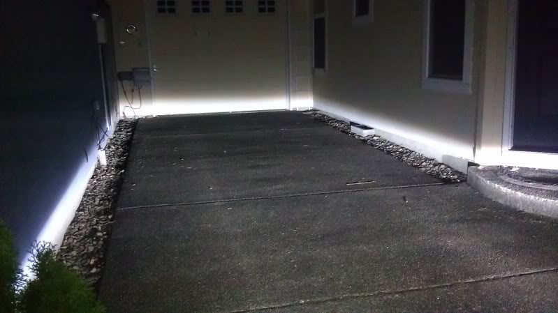

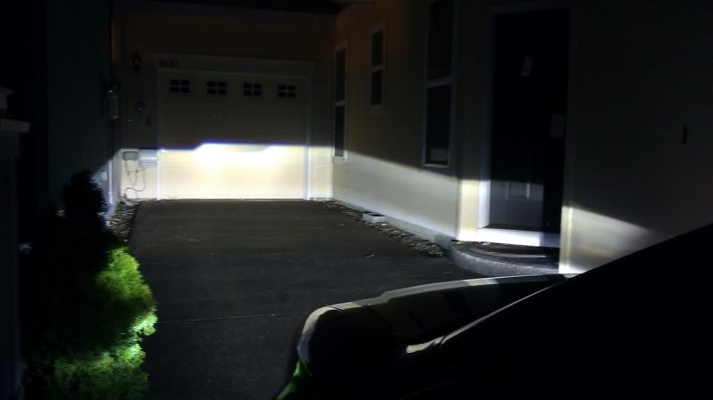

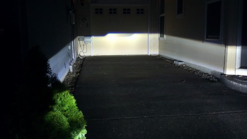

Here's the light output of the fogs against a garage/house wall:
Size:  52.0 KBName:  IMAG1839_zps0490e390.jpg

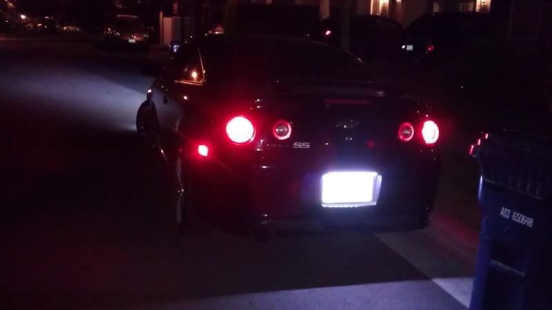

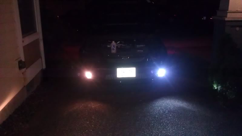

And here's a shot of only fogs from behind the car on the street. I took the picture to see the SMDLED strip that I used for the license plate light, and V-LED platinum bulbs for the tails (separate resistors were required to prevent hyper flash) I also needed a separate resistor to prevent glowing third brake light (the light would glow because there was not enough load from the two strips alone, not pictured)... Sorry for over-exposed phone picture

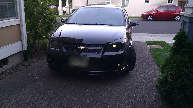

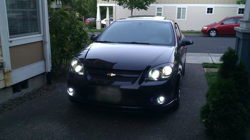

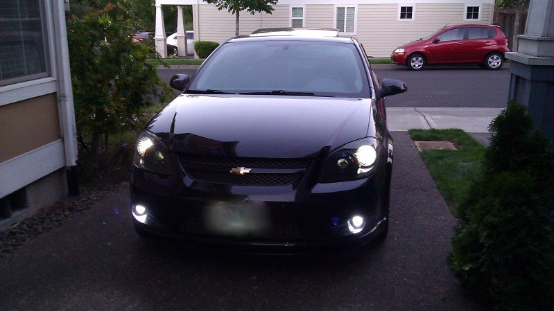

And the lights finally installed and the car put together:
Here's a shot of just Switchback parking lights and fog lights on:

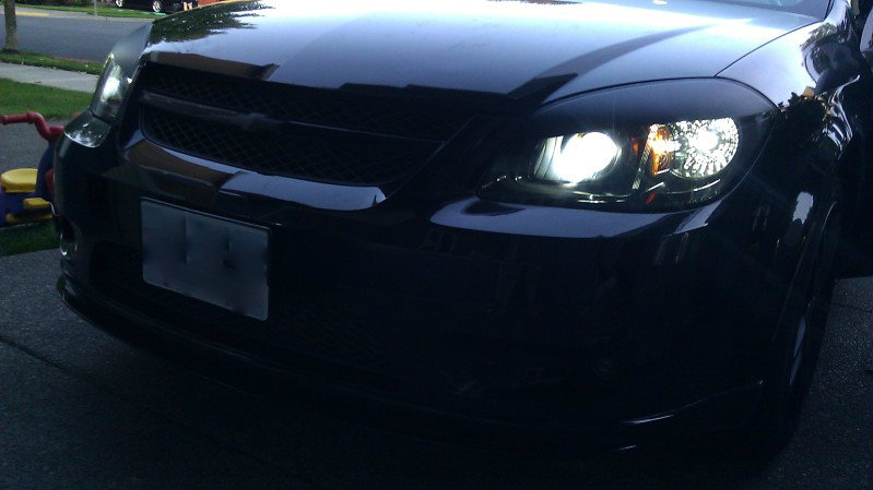

And here's a shot with parking lights, low beams, and fog lights on:

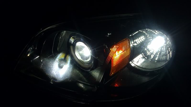

Close up shot of the light at night:
And the light output of both low beams and fogs:

Old Sep 23, 2012 | 08:03 PM
C_A_D88's Avatar
Joined: 12-05-10
Posts: 3,877
From: newmarket
Shoulda tinted the reflector
Considered it, but decided against it to keep legal. Once the lens is on it's not as visible as I thought it would be. Who knows, might do it on the next time I open them up.

Gah..my cutoff line isnt that sharp..I gotta redo my retros..>< What HID kit did you use?

I pieced my stuff together. The HID kit I got locally from a tuner shop Speed Concept or something.... Didn't want to wait for shipping. They use DDM ballasts, and not sure on the bulbs, they order them in somewhere in Cali according to them. Different bulbs do make a difference. I had a no name cheap hid kit in the last set up, and and the cut off was a bit worse. So was light output in general.

my Pass Cutoff is perfect but my Driverside sucks..and I bought them off a guy on cragislist..while the Ballasts are DDM I dont beleive the bulbs are..Now did you use the 9007 Adaptor plates or soemthing else?
