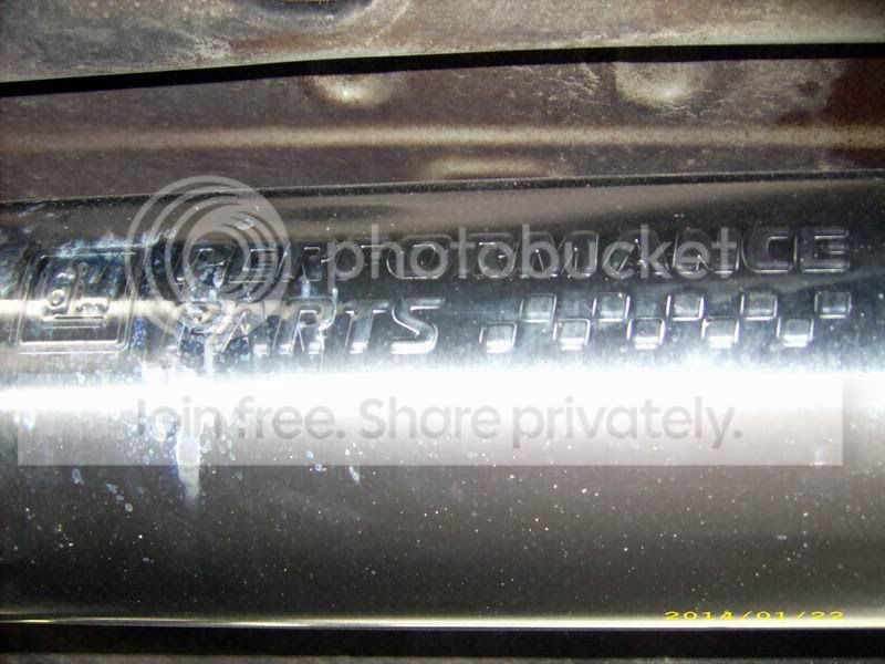

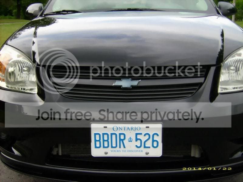

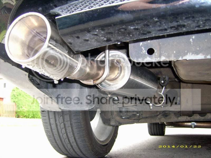

Here is my buddy's Painted Bowtie and his new GMPP exhaust.

Looks sweet man! How does he like the exhaust? Sounds nice doesn't it?

Love the bowtie. Never seen blue cf b 4.

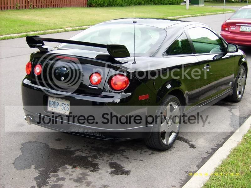

i see you did your back bowtie also...how did you get it off and did you just super glue it back on?

the exhaust is awesome! makes the car sound soo much better and adds a tad bit more excel. the bowtie was pretty easy to get off. all you need is some dental floss and just slide it behind. it does take some time tho so be patient. and then just tape off the chrome prime it and paint it what ever color and then clear coat it. i did 3 coats of paint and 3 coats of clear. but thats just me. to stick it back on i had a buddy at a bodyshop give me some double sided tape but you can get it pretty much anywhere. thx for the comments. keep em coming good and bad. always like to know what i can do better.
