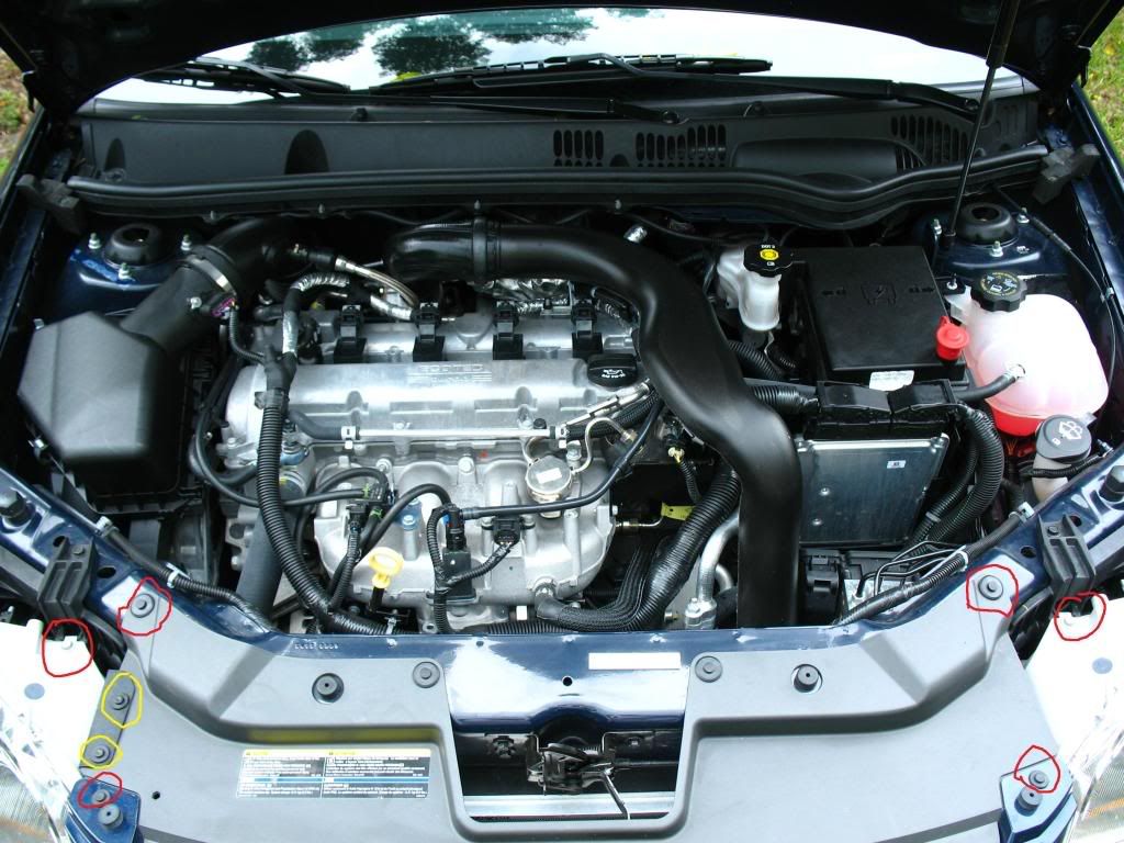

easiest way to do it is to remove your headlights
1. there are two bolts holding the headlights to the mounting brackets
take those off.
2. there are a couple of black insert clips you need to remove too
3. after you take the headlights off, it's easy to reach the fog lights
i have a picture here to help. all the read needs to be removed. the yellow may just be for 08-09 balts
check out your owners manual if you need any more help. any questions pm me

^^^ Where cause I looked to make sure before I even posted this thread. There's how to's for the headlights but not the fog lights. Anyways, I'm going to do the headlights then to get to the fog lights. I'll let you know how it turned out. Thanks.
