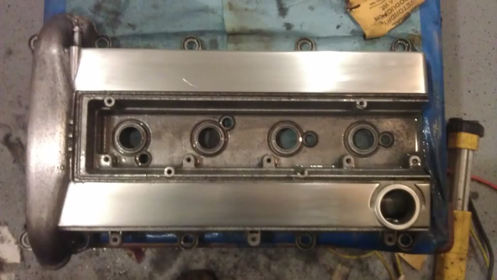

Old Oct 26, 2012 | 10:55 PM
brian.olsson's Avatar
Joined: 12-13-11
Posts: 420
From: Wisconsin
This is a valvecover I did for a friend using spray can primer, auto paint color matched, and spray can primer, I think it turned out pretty well, and it matched the car perfectly
