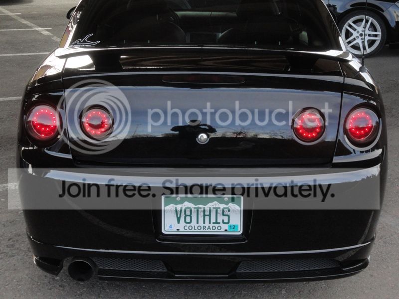

YES! Lights are sealed up and done and in the car!!
They are now:
* running lights
* brake lights
* blinkers
* backup lights (white)
just like I wanted. It's too late and I'm too tired for pics, so you'll have to wait until I can post those later. Our club has a big ass meet tomorrow, so plenty of opportunities to take pictures there. I'll try and post em up soon.
They look great as far as I've been able to tell, I love how they look identical to the outer lights in the dark, and so, since they're not "Skyline" tails, I think I'll dub them "Ferrari" tails lol
They were an absolute bitch to do so I doubt I will be making these for anyone, but I'll be happy to do a how to later

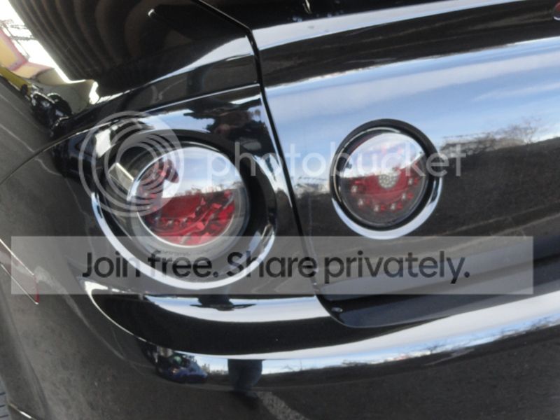

did this mod this past summer, cut the inner circle so i have the reverse lights visible......

@ mrader88: Sure am, probably saw you there lol
@yapster: Awesome, looks good, didn't know if anyone had done this before or not. What did you use to do your 3rd LED brake light?
Here are some pics I took today at 5280Cobalts' meet. I actually used LED's for the reverse lights as well.
LIGHTS OFF:
RUNNING LIGHTS:
BRAKE LIGHTS:
BRAKE & BACKUP LIGHTS:

so u used the guts from one of the outer lights to make the ring on the inner/backup light?
