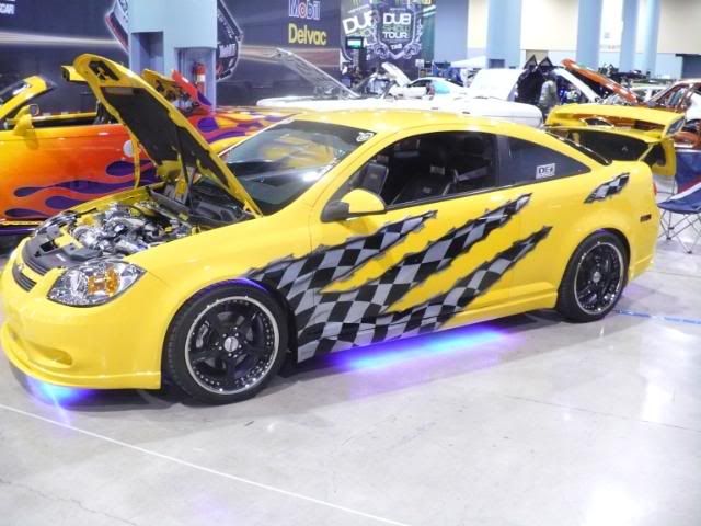

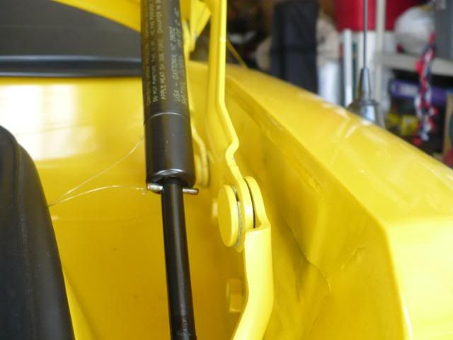

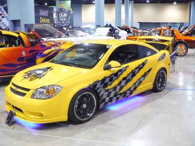

I did this mod...but changed it up a little, it works great at shows & the way I have it set up takes a couple minutes to reverse back to normal! I didn't drill out the whole rivet... just the outside head, Then drilled a small hole thru it & used a small counter sunk head to make it flush. I also drilled a hole in the shaft arm to hold it level with a shear pin!
Hers a pic of it, the show was dub last week!
Shear pins
Grant it the hydros don't work anymore...but I don't care!
