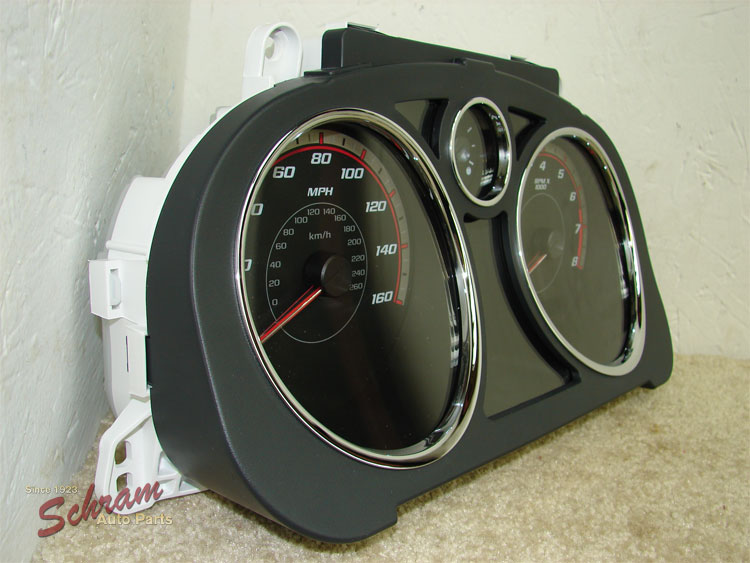

Alright i will. I see several kinds here on ebay. I did find the "Style" i'd like to get. see if it matches
Old Jun 25, 2008 | 05:45 PM
dman090's Avatar
Joined: 11-08-07
Posts: 6,041
From: Huntington, Texas
that would be a SS/SC guage my friend
Old Jun 25, 2008 | 05:47 PM
Banti's Avatar
Joined: 06-10-08
Posts: 73
From: Cincinnati, Ohio
Mmmm yes, Sexy it is... MMhrmmm arhmmmrhmmm rhmm
Then that's what I'm after
